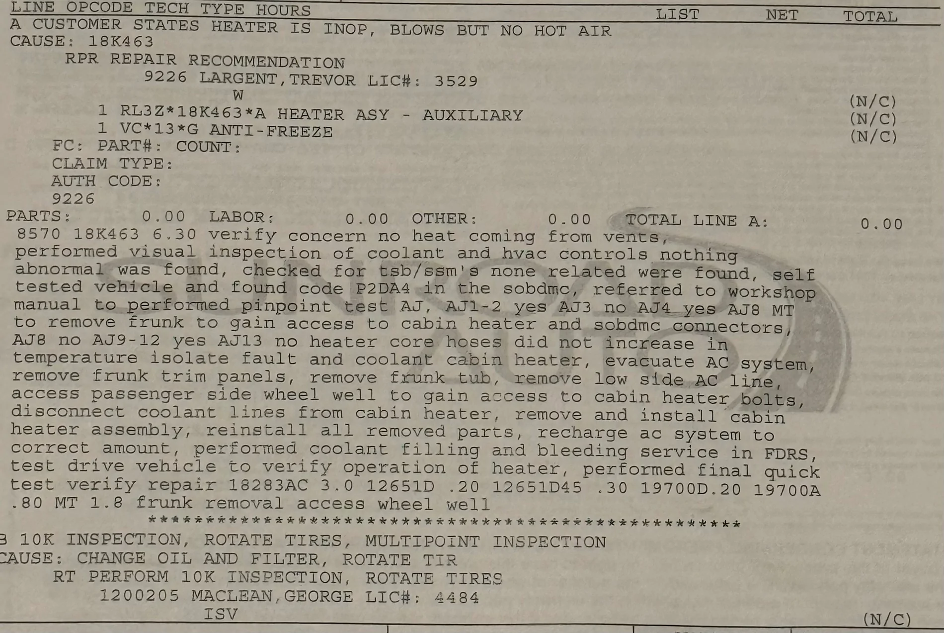

I had this issue with my 23’ Lariat. I check all the suggestions above and everything looked good. I took it to the dealer and it turned out to be the aux heater assembly. It took about a week to fix it. All covered under the factory warranty. No problems since.
Ford F-150 Lightning No Warm Air From My Heater This Morning IMG_6241
Interesting they had to evacuate the AC system. I guess the AC evaporator and heater had to be removed as a unit?
I seem to remember the mechanic telling me they had to remove part of the A/C system to get the heater core out.
