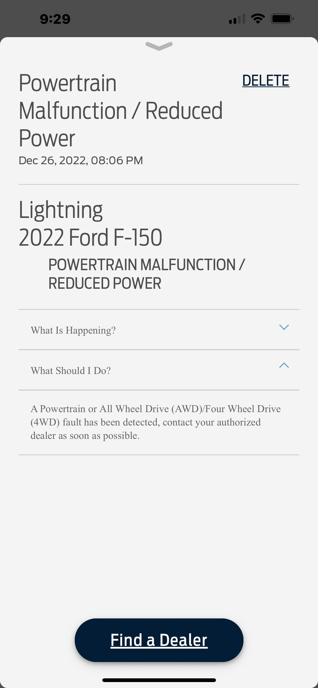

Unfortunately, I have to add my new Lightning to the list of others who have had this same issue.
Happened to me on a day when the outside temperature dropped below 10F (not sure if there is a connection). I was in the middle of nowhere, so I had to call towing for assistance.
I've been a longtime reader of this forum, and it was a bit terrifying to read about this issue, hoping it won't happen to me. And here I am.
*Day 1*
The truck was towed to the dealer. No updates. :confused:
*Day 2*
The dealer says they are waiting for feedback from Ford engineers to proceed. :cautious:
Same here 11,000 miles only issue has been not getting a full 320 range from my extended batteries. 30 degrees out and stranded with a message of power train failure. Reduced power. After 10 mins of trying to get it to move it would go 3-4 mph then completely die. Having it towed to the dealership in the morning.

Day 2 @ Dealership. Lunch time and no word from the dealer. ☹
2:00pm day 2. Dealer called and they are trying to borrow tools from another dealer. They only have 50% of the required tools. SMH!

Now they’re saying possibly 2 months to get a partial battery (one or two modules showing faulty)WTH!!?

Day 3 @ dealership. No word at all. Good news I started a case with Ford Customer Relation ions and they contacted the dealership on my behalf.

I have a similar issue. A couple weeks ago during the cold snap, my truck lost total power with less than 10% battery left. I had to emergency charge with 120v plug until I could get enough power to get to a L2 charger. Just today, I left my house at 44% and made a quick stop and returned 20 min later with 31%. The truck was off so i'm assuming 1 battery pack/cell died. I need to schedule a visit but I need to know beforehand they can fix before i bring it in otherwise i'm out of a truck unless they give me a loaner.
