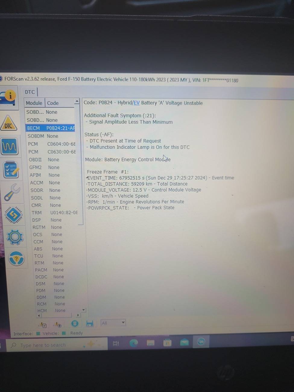

Well, add me to the list. After a charge to 90% this morning. Went to go to the gym, got the wrench and the limited power, service soon warning. have had the truck for almost 8 months. Bought used with 20 something thousand miles on it. Now sitting at 36,807 miles. Tried the 12v battery disconnect and made sure the battery cables were clean and tight. While the negative cable was disconnected I put it on charge to make sure battery is good, and did a load test. Passed. Hooked battery back up. Still the same. Screen shot of the Forscan Code reader. Is there any new info on this problem! I've been reading through all the posts I can Find!
And will not charge on level 1 or 2 either, haven't tried fast charge. Luckily still showing 58% power available on 82% soc. So, I will drive it to the dealer after the Holiday.
Ford F-150 Lightning Powertrain Malfunction/ Reduced Power F 150 BECM cod
