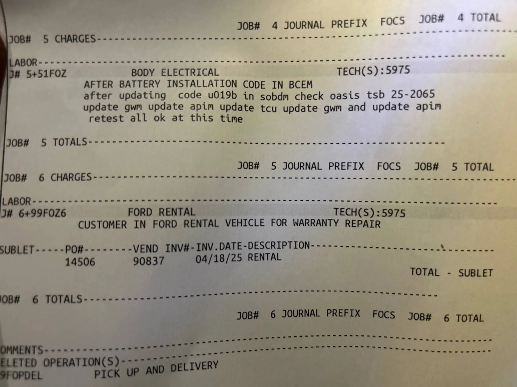

No, but oddly after the module was replaced the BCEM threw code u019b which led to TSB 25-2065. Hopefully this explains why I have not gotten updates since September ‘24.
I cannot seem to find that TSB, doing a quick search in the forum and at Ford...can you provide any details?
I have nothing more to go on than one sentence in the service report.
I have had lots of issues recieving updates. I asked the service manager to confirm I was current on all updates. They responded that an issue had been be discovered and repaired.
It is possible the wrong TSB number was entered.
