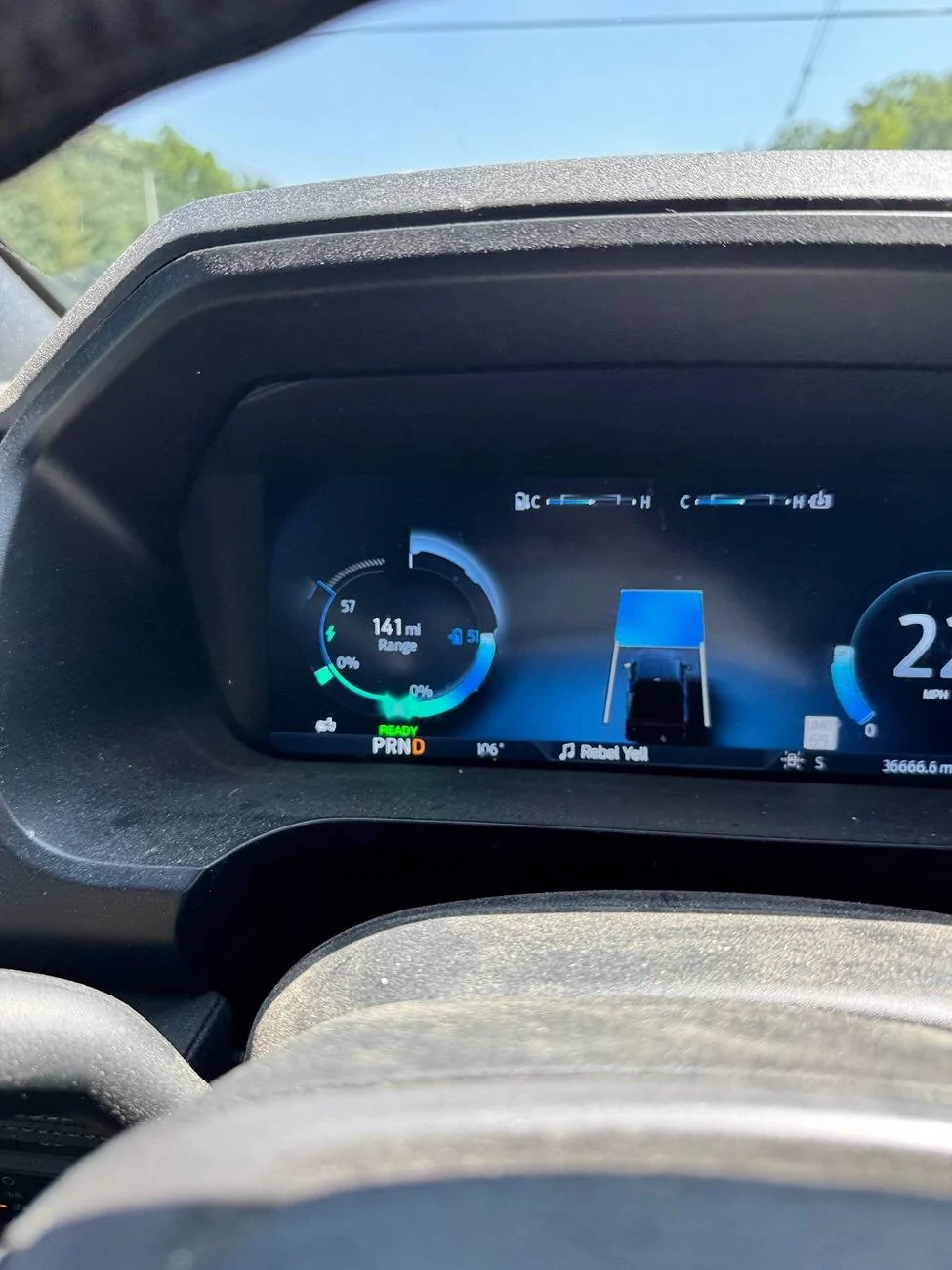

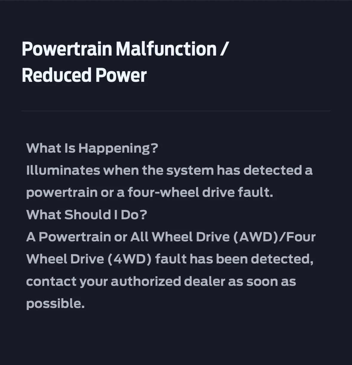

Just got the death wrench "Powertrain Malfunction/ Reduced Power"
Power was limited to 57% so accelerating on the highway felt like a normal car. Boooo!
Bad Luck!
Did you receive any notice for the 25S18 recall? If it turns out to be a battery module issue, you should contact the folks at BEV especially if your dealer seems a little lost about a timely repair solution.
