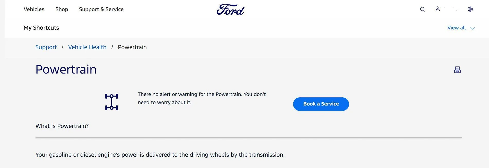

Just got the "Powertrain Malfunction / Reduced Power" warning pop up. First for this particular vehicle, but I've done this dance before with my prior '23 XLT. That one took 9 weeks to resolve and ended up with Ford taking the vehicle back. Hoping for a better outcome this time.
Fun fact - the vehicle knows it has a problem, Ford Pass knows it has a problem, but the Ford webserver thinks everything is fine...
Ford F-150 Lightning Powertrain Malfunction/ Reduced Power Screenshot 2025-04-13 182056
