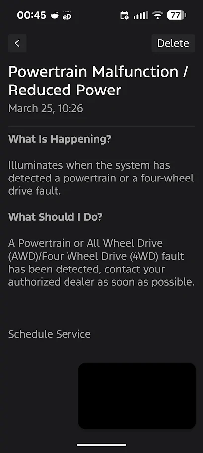

I was backing out of my driveway and as I went from R to D a warning came on the screen that I can't remember, but had the message in the screenshot from the Ford app. The orange wrench came on my instrument cluster. I couldn't go more than 2 or 3 MPH. Stopped, turned off, restarted and the wrench stayed on, and I had a warning about one pedal drive not available and to use the brakes to stop. I was able to drive normally other than that. My wife called the dealer and got me an apt for this Friday. I was terrified as I'm used to ICE and am relatively handy with them, but I had no clue what to do. After I finished with career day at the local HS, I got back in my truck and plugged in my OBD dongle. Had a bunch of archived codes, and unimportant things like seatbelt and radio as I recall, but nothing about the malfunction. It was then that I realized the orange wrench was gone. One pedal drive was fine. Everything was back to normal. The only thing I can think of was that I was in neutral still rolling backwards when I switched to drive. It wasn't anything fast, and something I've always done to an extent. Any ideas? Should I keep the appt? Maybe get the park/shifter recall done as well.

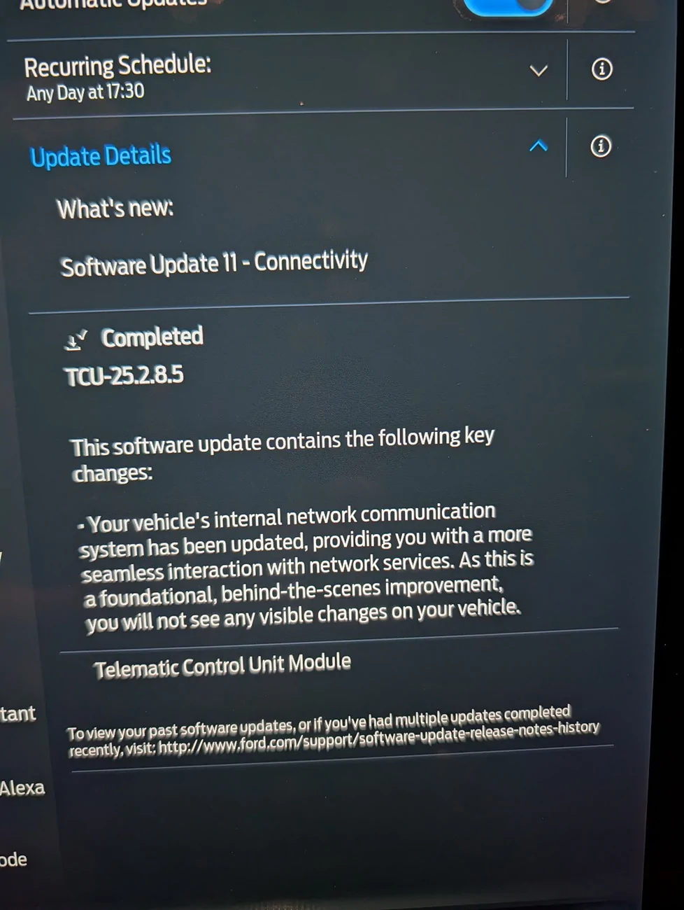

What & when was your last OTA?

I think it was November. I thought I saw it in the Ford app but I can't find it. I got this picture of the software update screen.

Thanks for the information, that's long enough ago that it's not likely the root cause of your current situation.

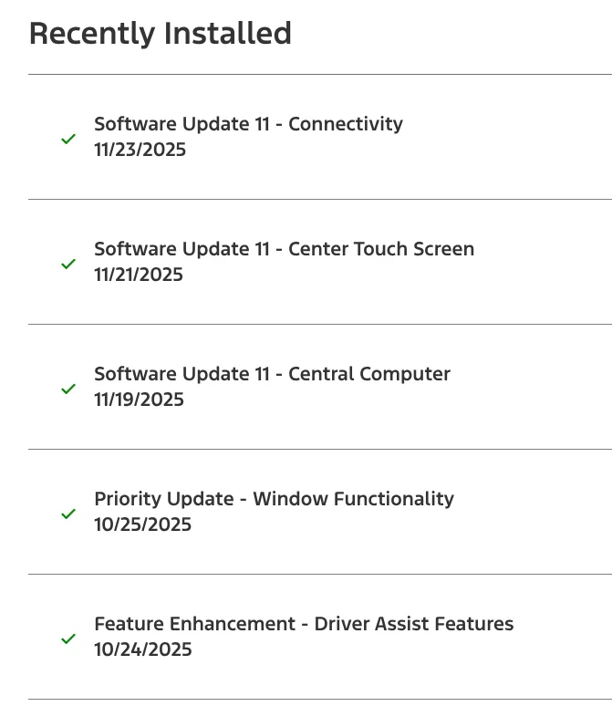

I did recently (3 or 4 days earlier) change the 12v battery and did a BMS reset (high beam and brake combo). Also found my most recent software updates.

I guess I should add updates received to my sig? Seems to be helpful to those using that info!
