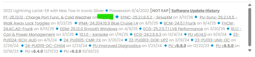

My charging to a limited SOC% has been fine as of the recent OTA's I've recv'd to date, snap shot for posterity since this data will change in my SIG months down the road as newer OTA's post after my statement today.

Sounding like corruption of charging scheme GPS positioning coordinates.

The cold weather charge port updates (25.13.12 - 2022 MY and 25.8.5 - 2023+MY) could be involved with some of the issues some of us have been having with the PPOB reserve acting strange - set level not reached but PPOB cuts off.
My PPOB reserve behaved normally until this last update.
Another post mentioned the same issue after the update, and also issue with the charge stations settings.
Yesterday during a test it shut off long before the reserve was reached.
I don't exactly know why, but since the 25.8.5 update is a prerequisite for the PPOB when truck is off FORscan tweak, it must be involved with PPOB somehow.
The documentation/explanation we get with updates is never very detailed about all the things it may affect.
The PPOB reserve can be set to be the distance to a nearby charging station instead of a selected mileage, so that seems to be the connection between the PPOB reserve and the charge station issue.
If the cold weather charge port change is connected to stored charge stations somehow in the programming, maybe that ties them all together...and where the update glitch originates.
Oh Ford, why...why?
PS: I did also recently get this: SYNC-25.2.1.6.5.2 but hard to imagine how that would have anything to do with the PPOB? I don't even have SiriusXM capability on my 2023 Pro:
