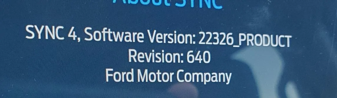

Meanwhile, I still have zero updates and am on revision 640 (Sync 4, 12" screen).
Can someone tell me what the latest version of Sync 4 (12" screen) on the Lightning? I want to ask the dealership to perform an update in an upcoming service visit.
I am a MY 23 XLT and still on the 640. My conversion with Ford specialists is no updates had been released for 2023 as of my conversion. All the early adopters seem to get the fun and gremlins for us late comers🤣😂

Good explanation. I'll add that this is also why there is no real good answer when folks ask how they find out what version they are on. That gets asks multiple times per week. The answer as you allude to is there isn't a single version number. Each module has their own. Just look at the FDRS thread where Mike and others post updates needed by VIN. They are mostly different.
The only one that is noticeable is Sync. You can display a version number for it. And it sometimes correlates with new features like the new UI back in January. But other features - like the coveted SOC display - are unrelated to Sync version.
