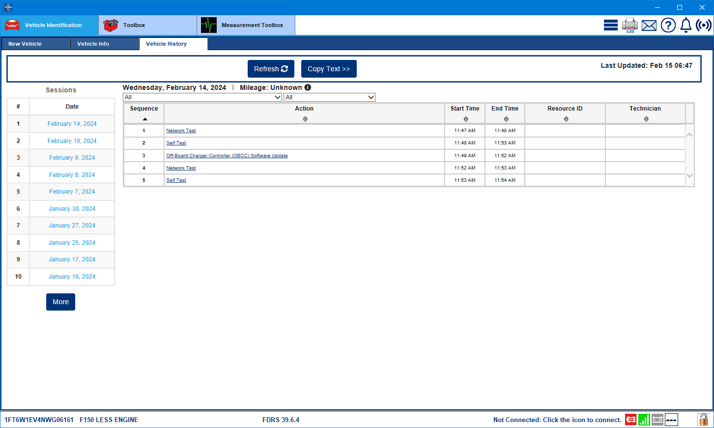

Yes-- That's me from yesterday.. Second time was because FDRS didn't remove it... The prompt about "uploading to database" showed up on the screen as I did it. .. Maybe when @Mike G runs the update on his, he can record it?
Mine took 3 minutes....but I did have to hit the "Re-scan Network" button to get the OBCC to clear off the list.

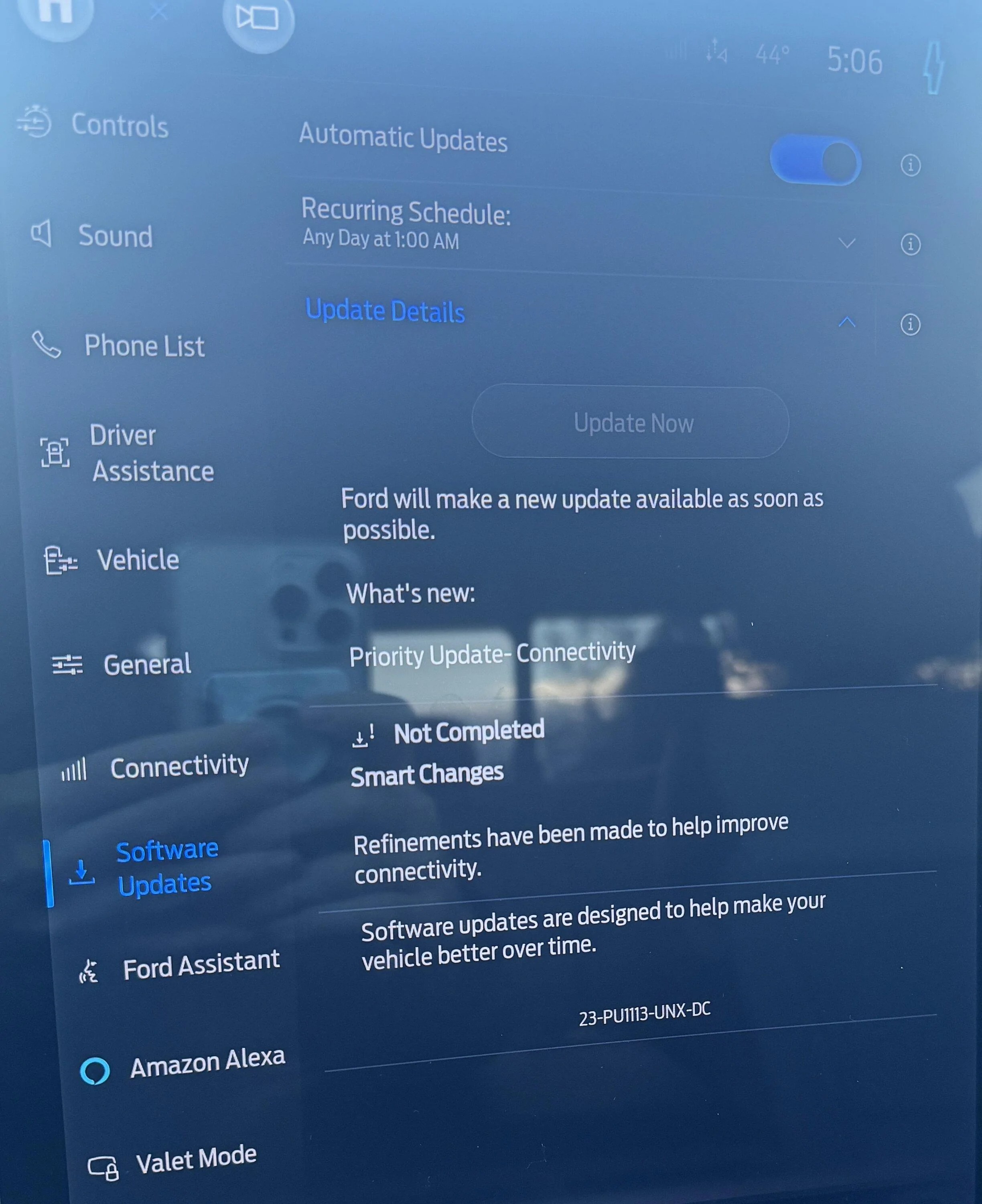

I’ve got the same update but slightly different wording. Like it’s still trying/waiting to download. Picture is while I was out, but been connected to home WiFi the last two nights and no completion.

Mind sharing your VIN so I can see if this one shows any more details? PM is fine.

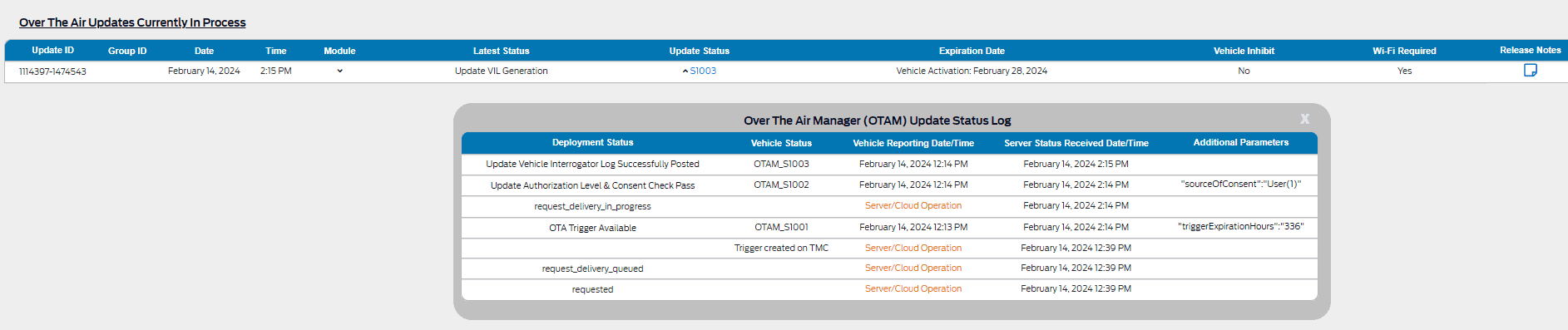

Every thing that has happened since the OTA trigger up until now is normal. The status of the OTA now reads "Update VIL Generation". I have no idea what that is. After the interrogator log gets posted, the manifest comes next. This OTA is for sure different than others. It excites the nerd in me. ? Have you started the truck in the past two days?
Ford F-150 Lightning Priority Update-23-PU1113-UNX-DC [Connectivity] 1708199171769
Edit: I was just told VIL is "vehicle interrogator log". So far, this is going the same way all other OTA's go.

Yeah, I’ve driven it each of the last two days to and from work (20-25 minutes each way). No change in status.

OTA dashboard is not working now. I'll check it again tomorrow to see if the OTA has progressed at all.
