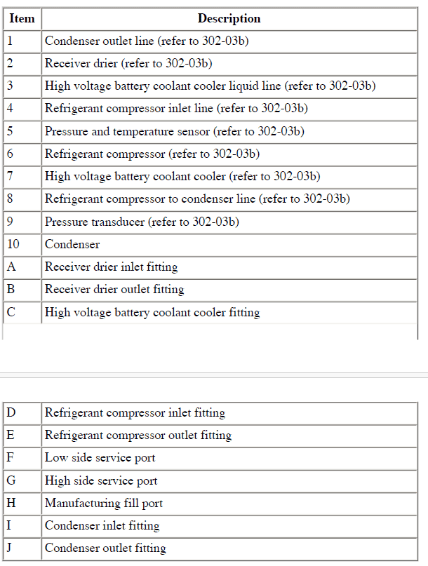

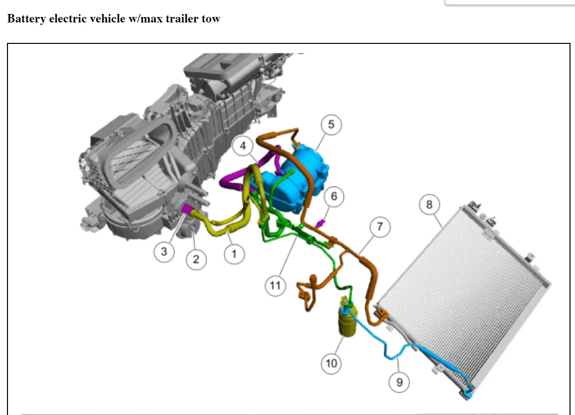

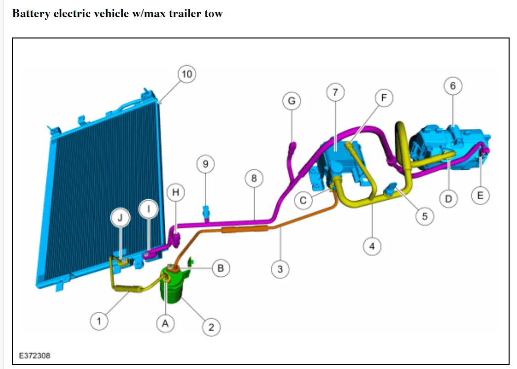

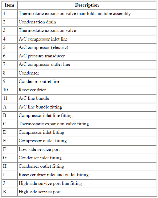

Ford F-150 Lightning PSA: Fast Charging derating significantly on hot days 1720987479044-gs
Ford F-150 Lightning PSA: Fast Charging derating significantly on hot days 1720987599233-5t
Ford F-150 Lightning PSA: Fast Charging derating significantly on hot days 1720987542146-n9
Ford F-150 Lightning PSA: Fast Charging derating significantly on hot days 1720987571482-nh
