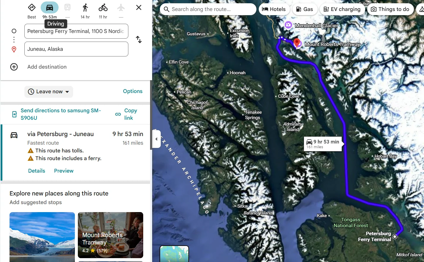

Where did you move to, the Arctic circle? Sounds like you're going to need to trailer it out instead.
lol. He's on an island. Probably isn't a trailering option with the ferry. Looks like quite the ferry ride to Juneau.

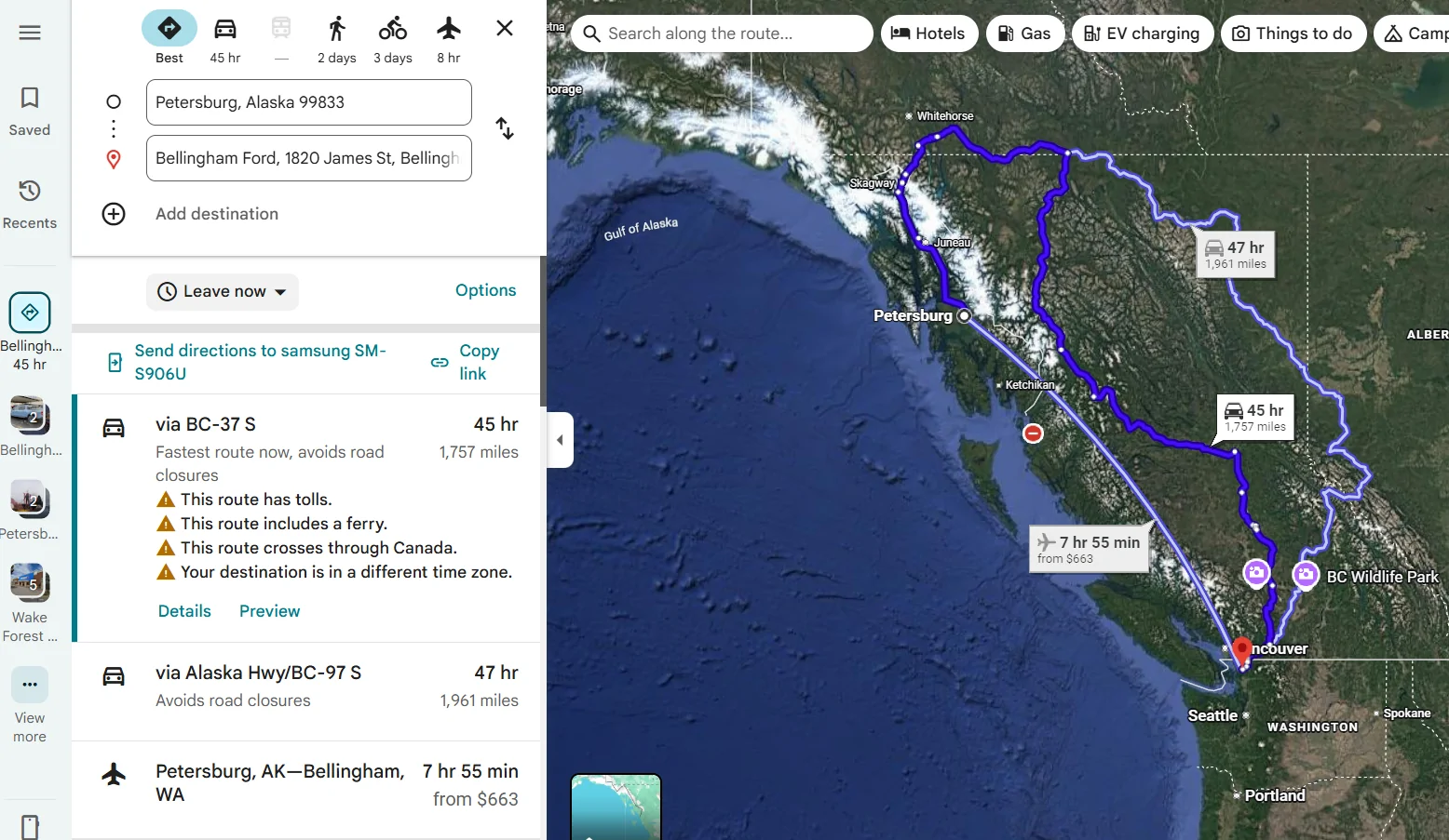

The nearest dealer is in Bellingham, Washington. Check that trip out on a map.
