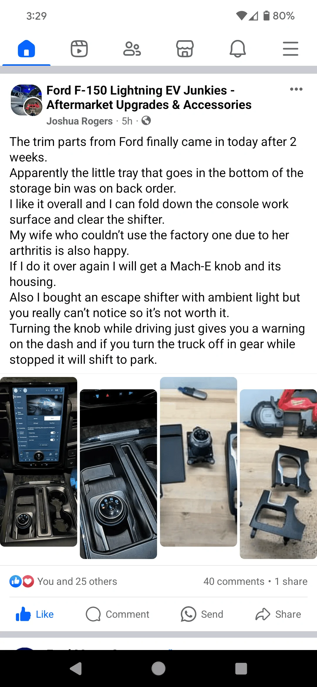

That's pretty cool! I wonder what happens when they press the L?
I thought the shifter folding down was really cool when I saw it in an ad for the lightning. But now having it for awhile I think I've only pushed the shifter down once legitimately. Most of the time I push it down just to show someone how it works. Would have much rather they stuck with a column shifter.

Can you still engage the emergency free-wheeling Neutral mode?
What happens when you press the L?

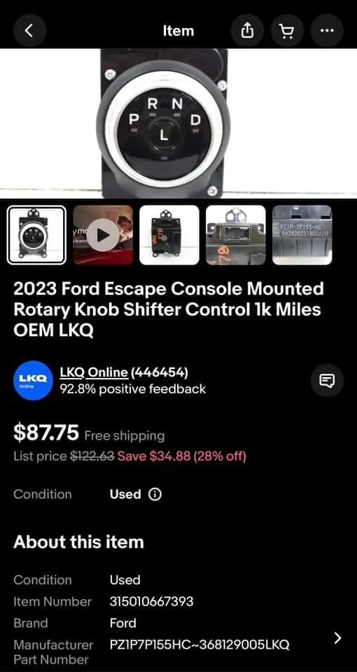

Console to Rotary Shifter 2023 Lightning Platinum ~$200
Hey guys, I tried to be thorough here but if anyone has any questions or if I forgot to mention something let me know I’d be happy to explain further. I saw this mentioned a bunch of places but didn’t see it done anywhere so I thought I’d post.
$90 Brand New on eBay
Ford Escape 2020-2022 Shifter - Part # PZ1P-7P55-AC
$50 for all 3 parts

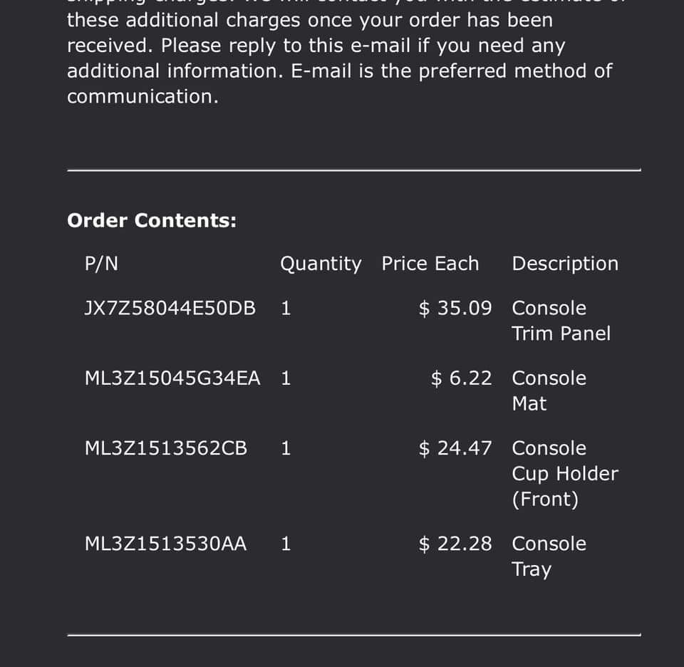

Main Console Tray - ML3Z1513530AA
Console Rubber Mat - ML3Z15045G34JA
Console Plastic Insert - ML3Z15045G34EA
