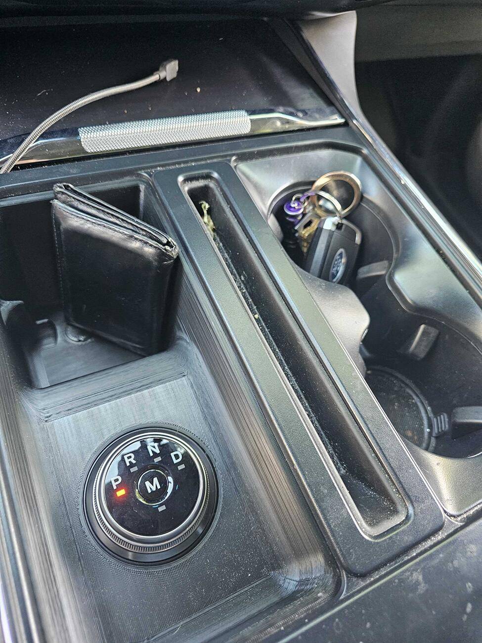

I ended up doing this with the Escape shifter in a Glass-Filled Nylon (PA6).
I've had good luck with the heat resistance of Nylon compared to the standard PLA or PETG.
I like the finish the GF gives the print, so I'll probably just leave this "in the white" so to speak.
Regarding UV exposure, I believe automotive glass tends to block most if not all (unless you drive with the windows down a lot), so that wasn't a huge consideration for me.
I used the Escape shifter LX6Z-7P155-U.
No motorized knob, but it does have a bodge that will lock it in place until you depress the brake pedal to shift.
I did have one fault code pop up that cleared about 50 miles later, but that's probably because I swapped this shifter with the power on because I wanted to work in the AC lol. What can I say, I'm lazy...

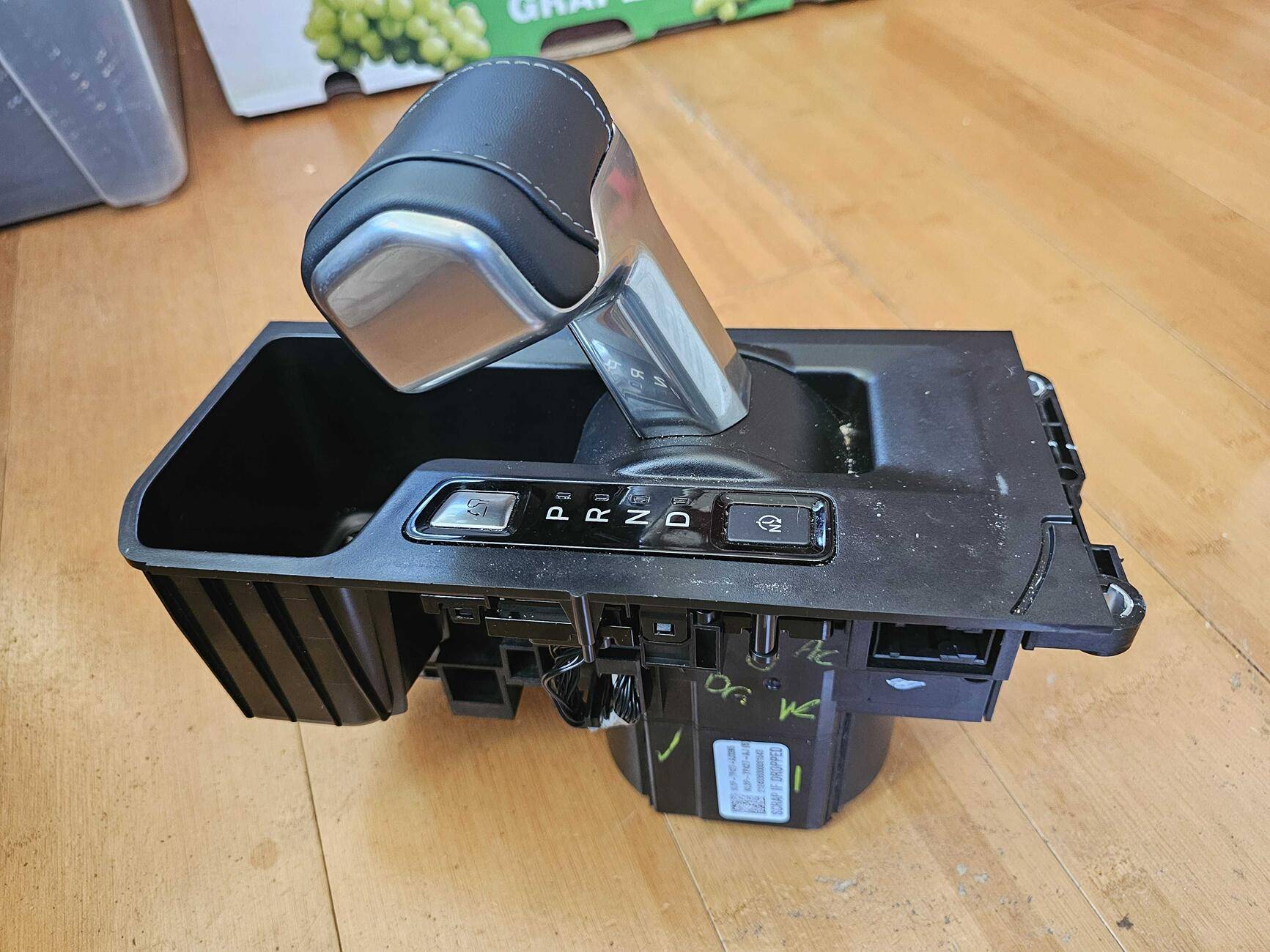

The factory shifter is a real beast by comparison.
Nice!, FYI - I recommend stowing the original shifter (if able to) as a last step before disconnecting the harness to go to rotary...helps save some space if putting in a box/storage.
Do this AFTER pulling out the bottom bolt under stowed shifter! :)
Wish I had thought of that or you had posted before I removed mine. ?

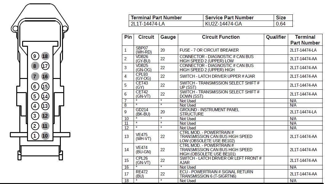

You might try applying 12V to pin 1 and GND to pin 9 to see if the stow button will work.
(Connector view - part view will be mirrored)
Ford F-150 Lightning Stick to Rotary Shift Knob Conversion w/ 3D Printed Rotary Shifter Holder 1753056002469-uy
EDIT: Does not work :(
Sweet. I thought about asking the collective if they knew what pins might do that. Sweet! I’ll try that tomorrow and report back. ?

@bmwhitetx
Just tried energizing the shifter with a 12v link from my ATV battery and pressing the fold button.
No Joy. Sorry to report.
I tested leads using a volt meter and had 12.47v showing at the time. ?
