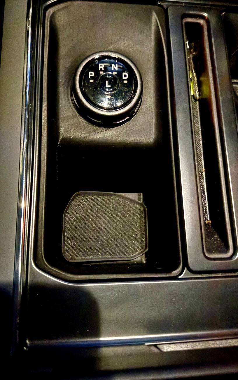

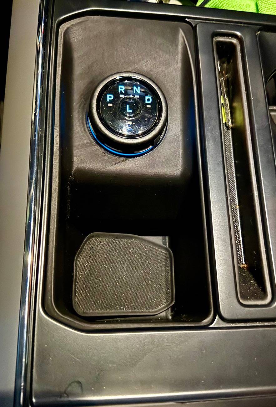

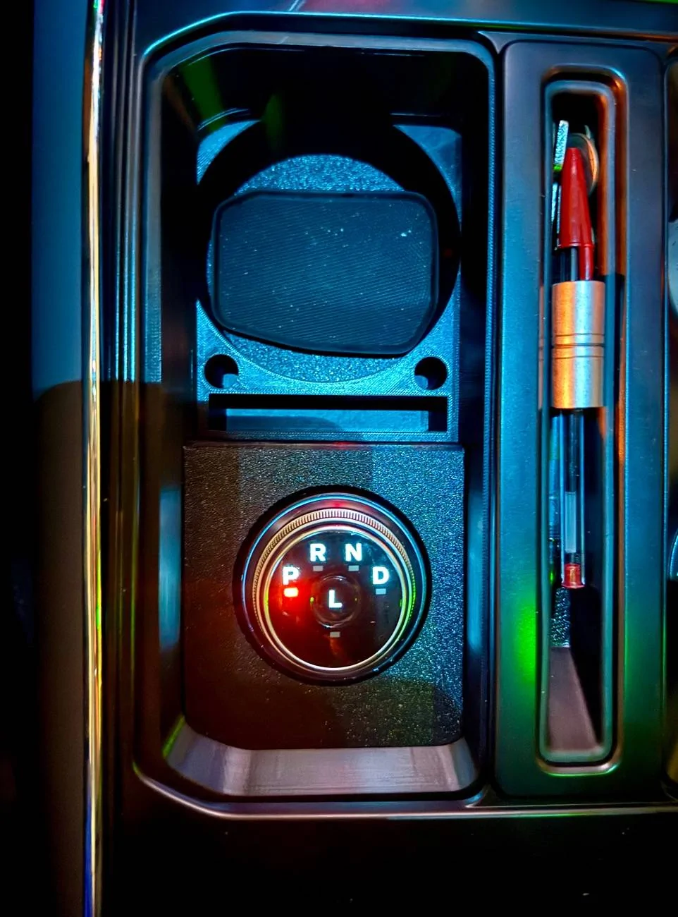

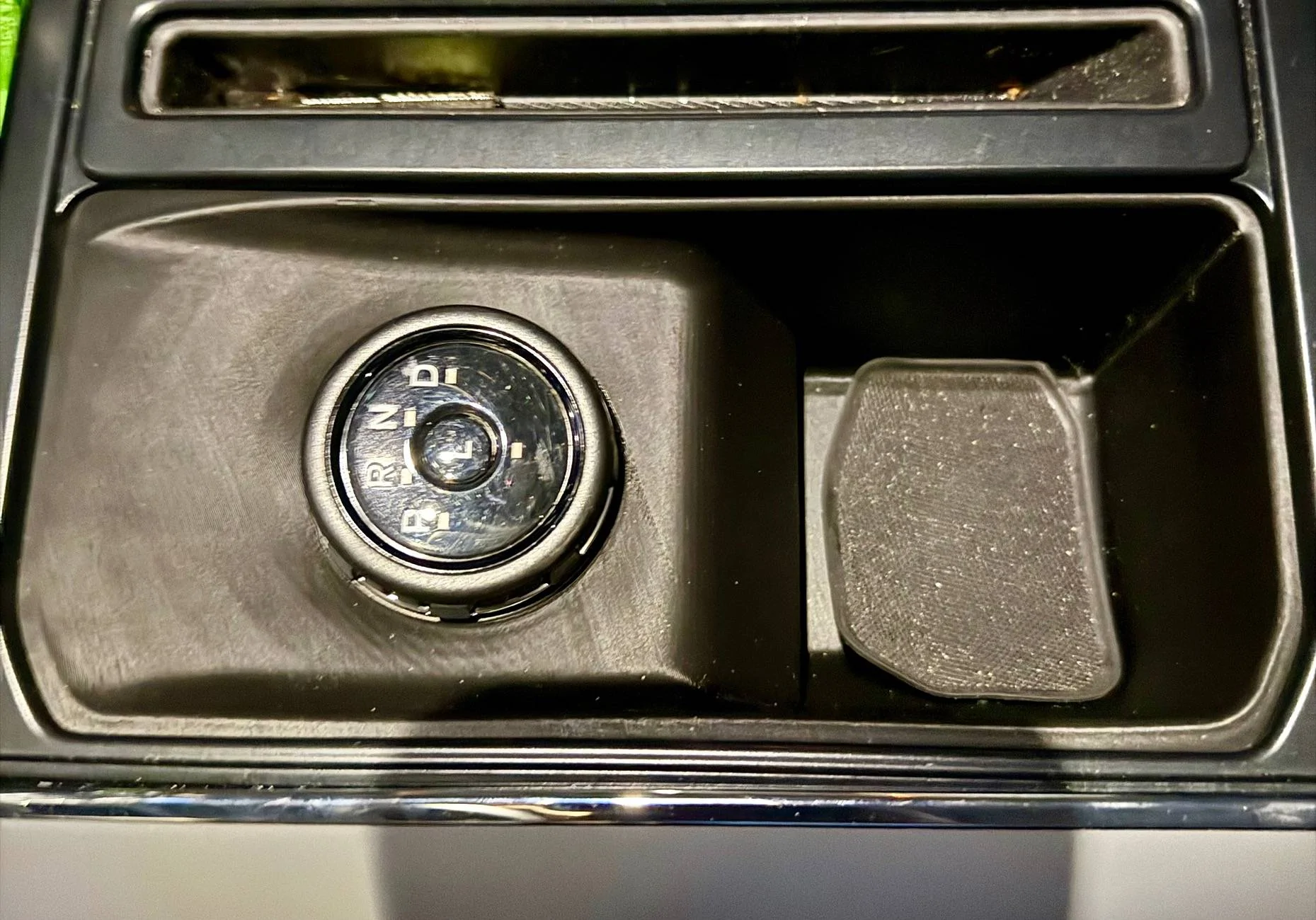

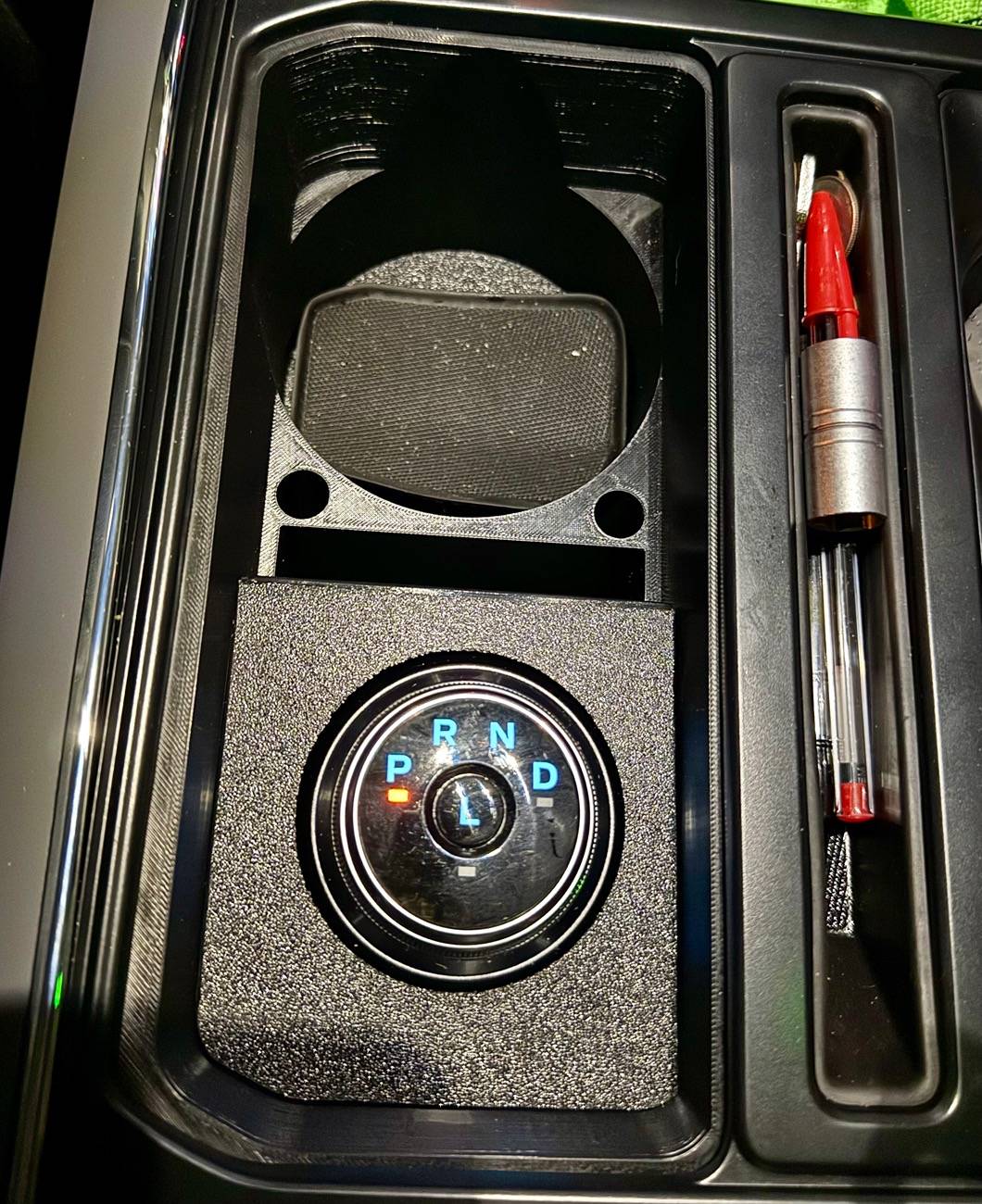

I got started with an assist on the print from @Drayday55 for the rear-seated tub with a large cupholder in the front, and have just made an upgrade after purchasing my own larger printer and grabbing the Bronco Sport shifter! I enjoy the way everyone is keeping the thread fresh with remixes of the original. I now have my first complete install and some printed bins that I didn't use while getting the print done. If anyone needs a hand, like I was given, just DM me. I printed mine in PLA+ because ABS went stringy on me ( I didn't have the dryer on the filament and wasted 18 hours). I did increase the walls in the build for more strength and changed the supports away from the tree style to the accordion. I haven't had any problems with the East Texas heat over 100 degrees so far.
