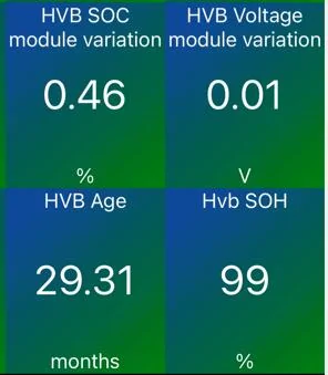

@Old Aviator @lightspeed @GoodSam @Wattsgas - if you have the Car Scanner app can you report what your HVB Module Variation is? There are readings for both Volts and %. Based on my own experience and one other, you would like this number below ~2%.
Would be interesting to see your HVB SOH (not SOC) as well.

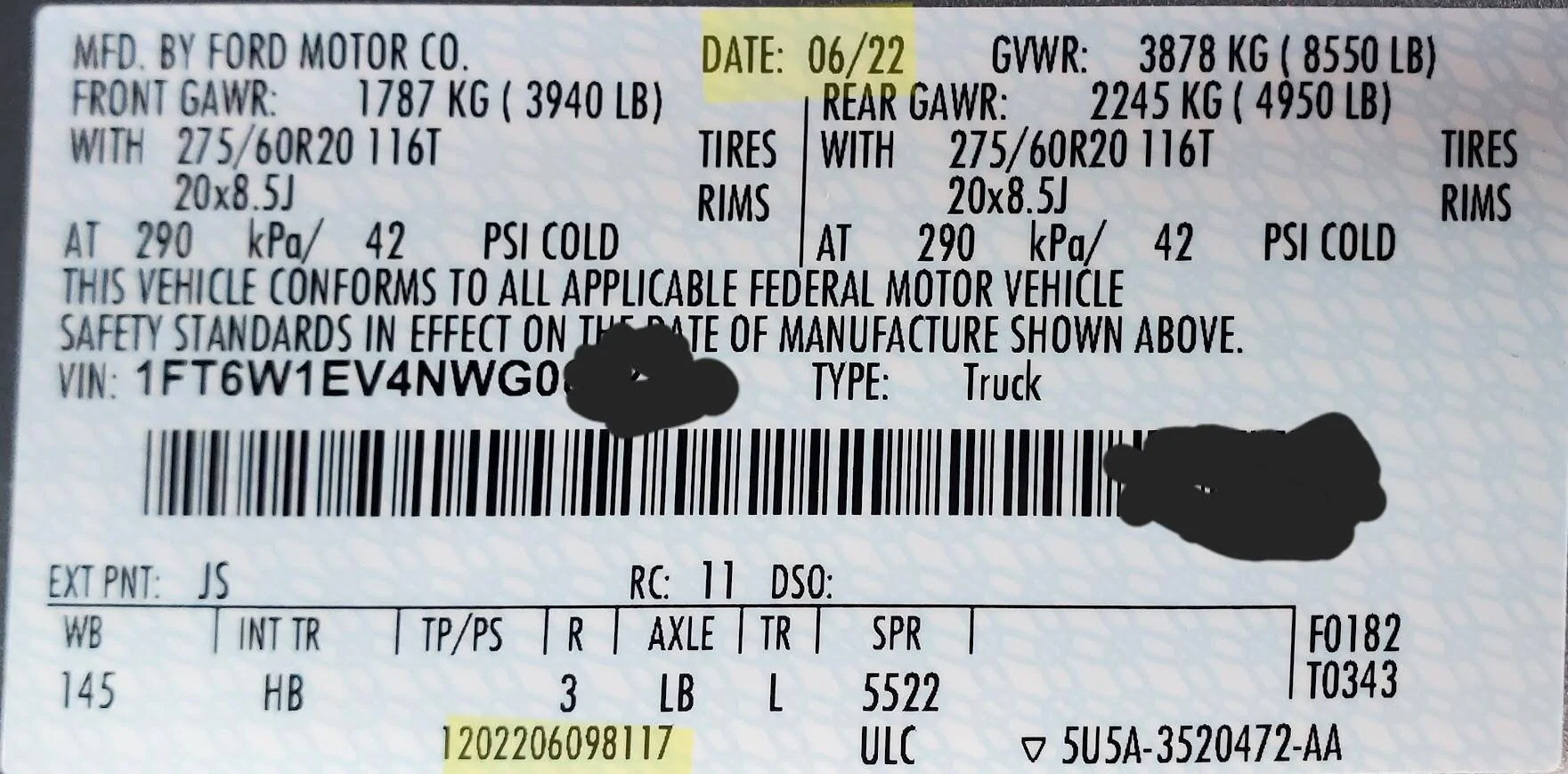

I have data for many early 2022 / 2023 members who shared production data.
Your blend day is on your tire placard bottom center, please let us know:
@Old Aviator build month 4/14/2022
@lightspeed build month 10/xx/2022
@GoodSam blend day was 10/12/2022
@Wattsgas blend day was 6/16/2022
Example of blend date : 06/09/2022
