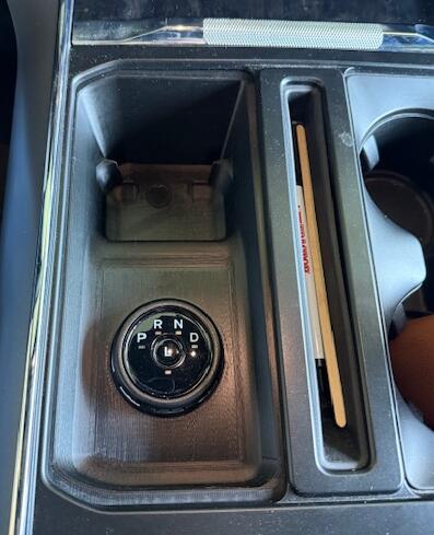

Left side trim piece is dead easy...but like I said for some reason the right side takes a bit of fiddling to get it back into place.
My left trim was a PITA to remove. I assume it was the first time removed since being built but damn that thing was wedged in there, very tightly. I thought for sure I had removed one of the metal clips from the plastic assembly where that thing was jammed into. Second time removal was no big deal.
The other challenge was lifting up the assembly, there's a small wire bundle at the bottom of (below) the cup holders...has very little slack from where its held into a bundle clip into the metal frame. Shoulda just cut that blasted thing off.

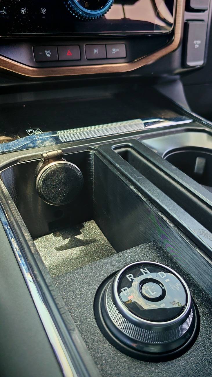

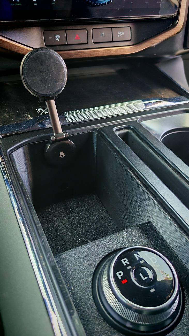

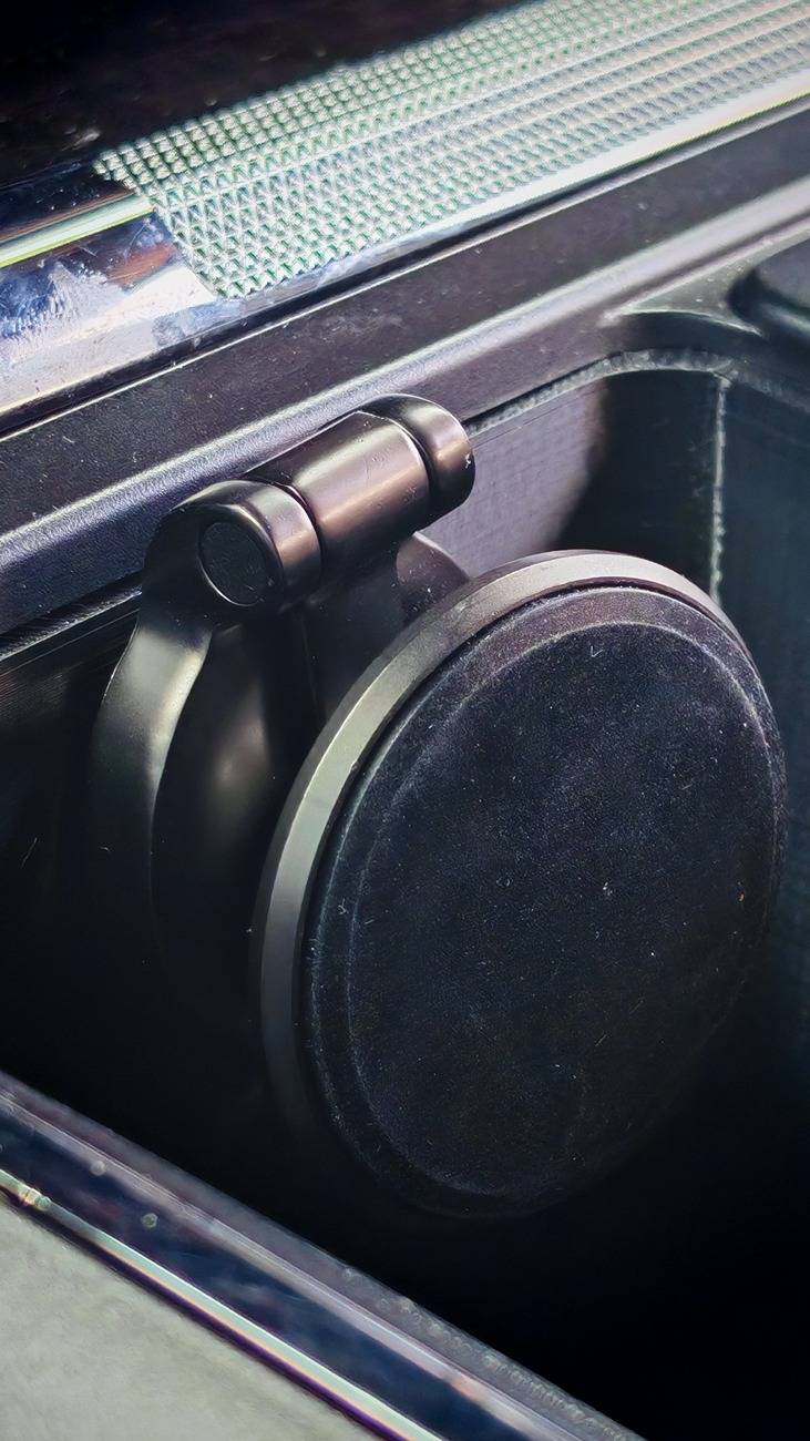

I found the perfect magnetic phone holder that sticks on with double sided tape, folds down out of the way and rotates up and down.
Cell Phone Magnetic Car Phone Holder - Full Rotation
Nice! I had one of those on-hand before I went through the work of my bolt-on version.
Glad to know it holds up...I was worried about the heat and thermals of the sticky-pad.

Nice! I had one of those on-hand before I went through the work of my bolt-on version. And
So far so good sitting out in 90 deg Weather at work. I have these sunshades that really help keep the temperature down and when you want to sit and watch TV while charging or something. I keep the rear one up all summer and use the front sides and front all the time. Note that I use a different front shade because it fits better than the kit shade.
