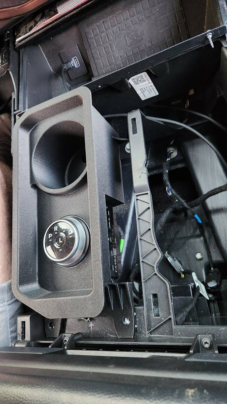

Question for anyone with the Ford Escape shifter. I bought LX6Z-7P155-U from this eBay site which I know some others have bought from. But the actual part number printed on the part was PZ1P-7P155-AC
Has anyone else who bought from that site get one with the same part number? I'm trying to figure out if I need to return it or not.
masonta
Feb 4, 2025
F150 Lightning
Electrical Engineer
I believe the ford PN is listed on the other side (or underside, I can't remember exactly).
In any case, the escape shifter i purchased had that same number on the right side (you can see it in the attached image)
Great! Thanks so much.
