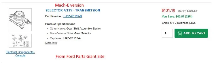

Ford Parts Giant has the Mach-E version a lot cheaper than the Escape/Bronco versions.
Ford F-150 Lightning Stick to Rotary Shift Knob Conversion w/ 3D Printed Rotary Shifter Holder MME_Shifter_FPG
The Escape and Bronco Sport versions are around $185 from there.
I guess the Ebay deal is the best one....but I've seen that even on the FPG site they list different revisions that have been superseded by new other ones, so I'm wondering what the firmware differences would be and if that would be a factor.

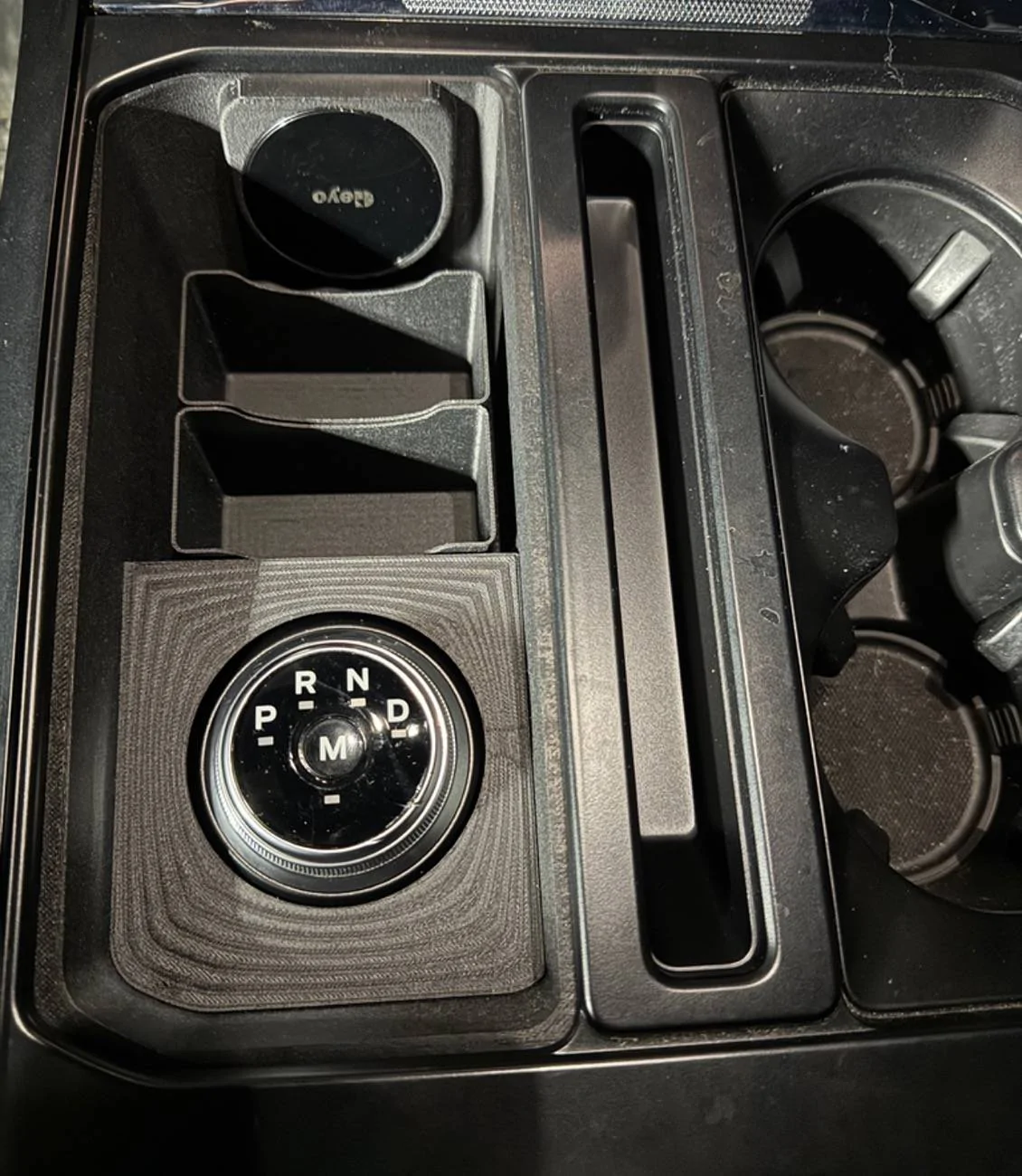

Ford F-150 Lightning Stick to Rotary Shift Knob Conversion w/ 3D Printed Rotary Shifter Holder IMG_7877
☝Yes this one☝makes very very nice use of the forward space with the organizer areas plus charger integration is really cool. Wondering if someone will be printing and selling it on Etsy also..??
https://www.thingiverse.com/thing:6978586
Yes, thanks Mine G. I saw this also, sharing your link with my post…

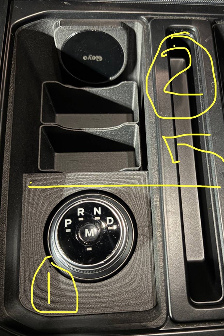

Wonder if could be done in two jobs.
Ford F-150 Lightning Stick to Rotary Shift Knob Conversion w/ 3D Printed Rotary Shifter Holder IMG_7878
