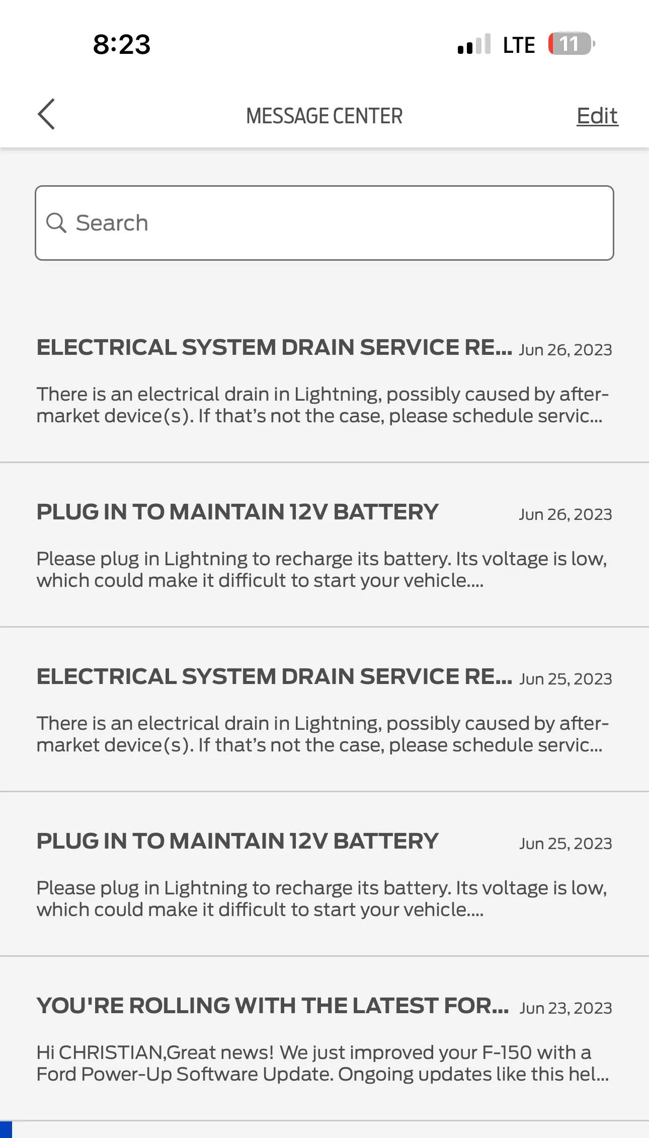

Iโ€™ve been getting this after the 306 update . Lots of other random issues after 306 as well like the truck randomly displays 24 hour time sometimes and the sync stack is now rebooting randomly while driving.

Well I prefer 24hr time myself and have both my car and truck Sync set to that..but it doesn't always display that way. Selecting the time display softswitch to 12hr and then back to 24hr always wakes it up and makes it display properly again. I'm told that Ford is aware of this issue and has a future fix (OTA). And it will likely be a future APIM update I'm guessing.
That 12V battery drain on the other hand...wow. You think your LVB is finally wearing out?
Have you tried resetting the BMS learned values dance?
The "Electrical System Drain Service Required" message is a big annoyance. I've been getting this regularly and tracked it down to this: If I plug in my F150L outside of my charge setting window, I will almost always get this message after a few hours. Otherwise, I would never see it. It's like it knows it's plugged in and keeps things live burning the LVB up until it goes into this warning just waiting for the time to tick by so it can charge the HVB (and the LVB at the same time). A simple software change to the LVB charging scheme or the "wait to charge" scheme could fix this - Ford?
So of interest here.. I've had my truck for over a year now.
I charge at home and I plug in when I get home at 6:00pm the latest. My truck is set to charge beginning at 11:00pm so it sits plugged in for 5 hours every single night before the charging starts. and I've only gotten this error once before. . I have nothing aftermarket hooked up.
