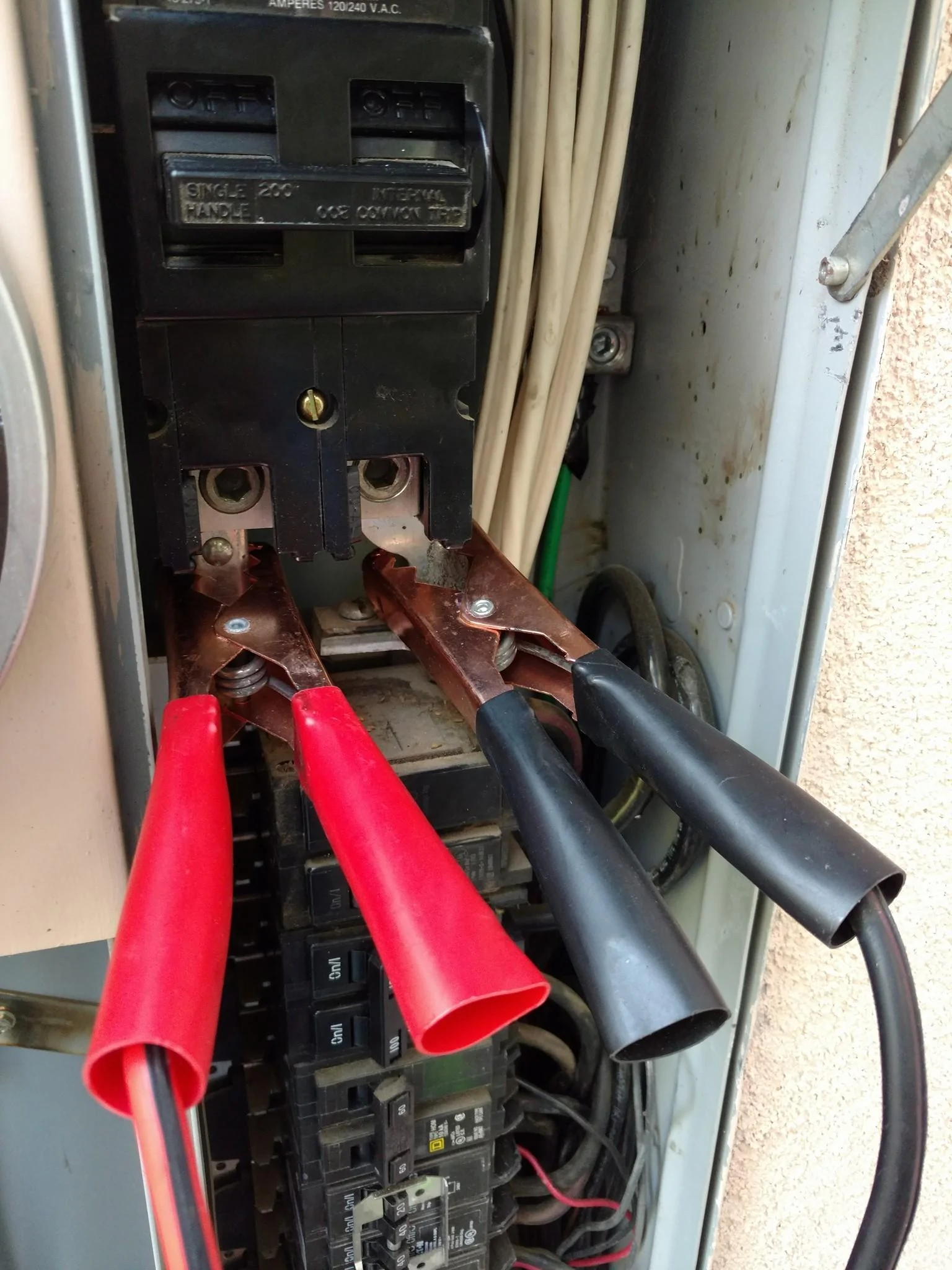

I spend time here to help educate people on the realities of code and electrical safety, because if I don't there are plenty of people who will advocate duct-taping a garden hose to a gas pump that doesn't reach and call it safe. I could just throw my hands up and let people say really stupid things and do stupid stuff, but that's not me. But, like the Tesla boards before this one, there will always be those people who do this kind of stuff and argue it's just fine:
Ford F-150 Lightning Sunrun did not inform me that I was paying for a 50 amp circuit! 13937848_10207067815833972_722610259296800303_o

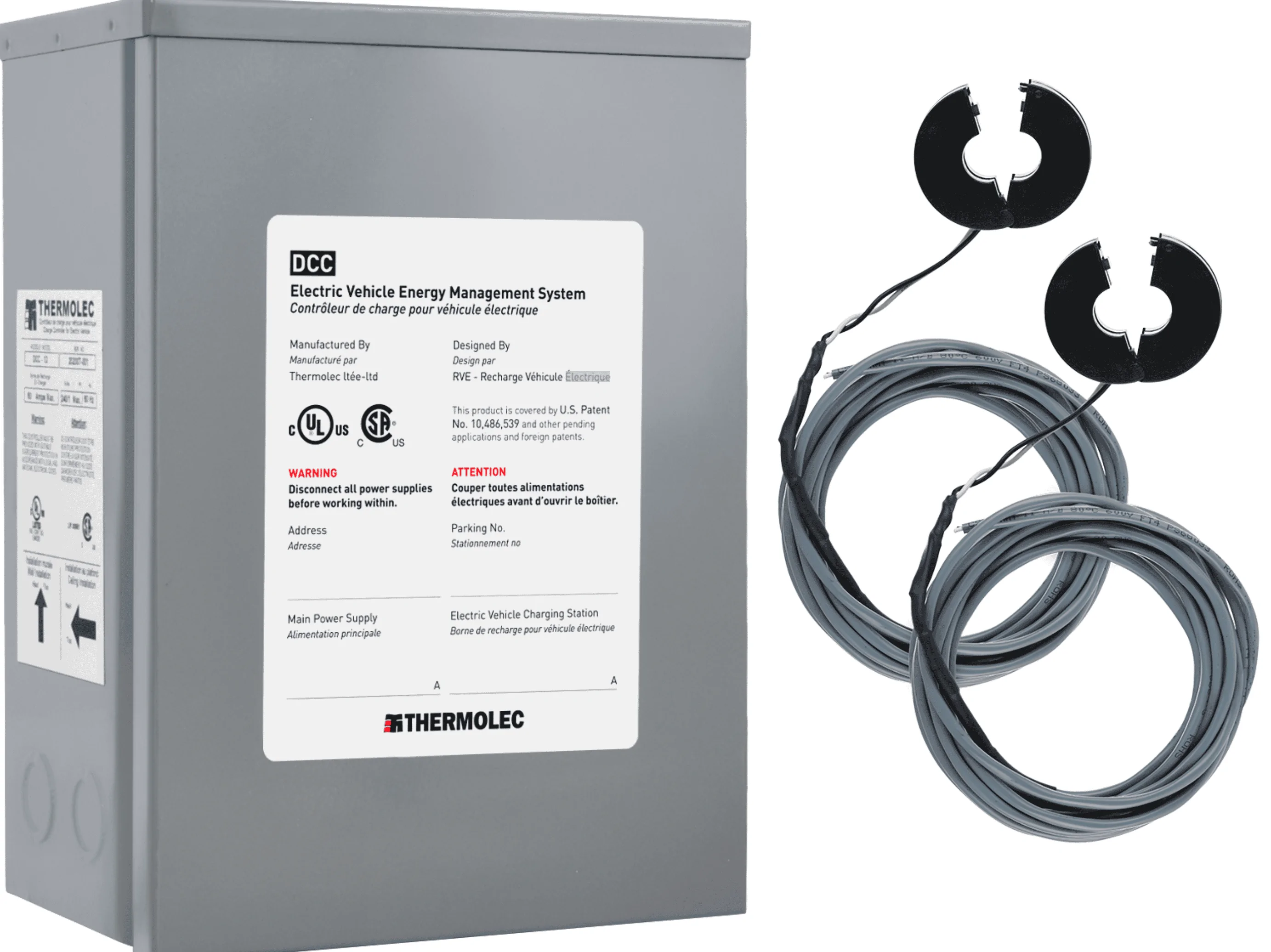

not sure about the states but in Canada, if you're over the calculated load limit required by code you can get around it with an energy management controller. it monitors the total amps being drawn by your main service panel. when it gets close to the limit (200 amps) it shuts off your EV circuit before your main breaker trips. way cheaper than a service upgrade.
Ford F-150 Lightning Sunrun did not inform me that I was paying for a 50 amp circuit! dcc
