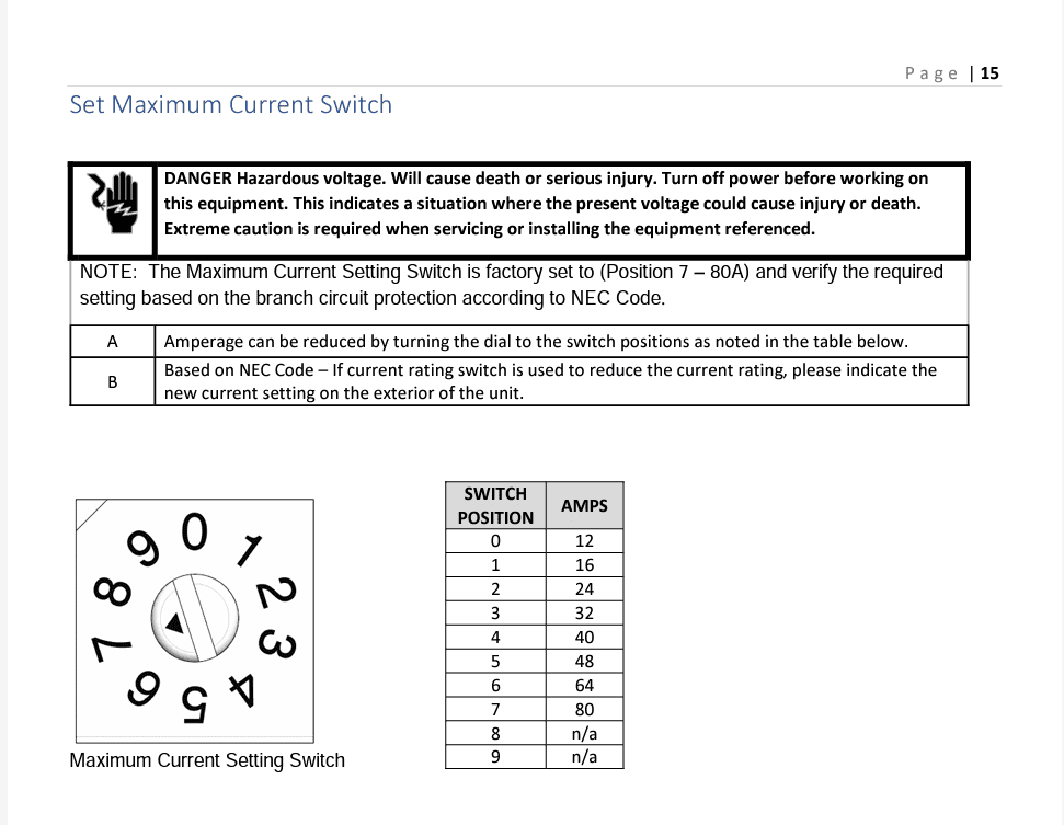

With a 50 amp circuit the charger can be set to draw 40 amps (80%) and it won't be a problem. If they haven't been on site to look at things, I don't know why they are defaulting to 50 amps.

There is a dial inside the Ford Charge Station Pro that can be changed to different amp settings:
Ford F-150 Lightning Sunrun wanting to install Charge Station Pro on 50Amp circuit 1678395424167

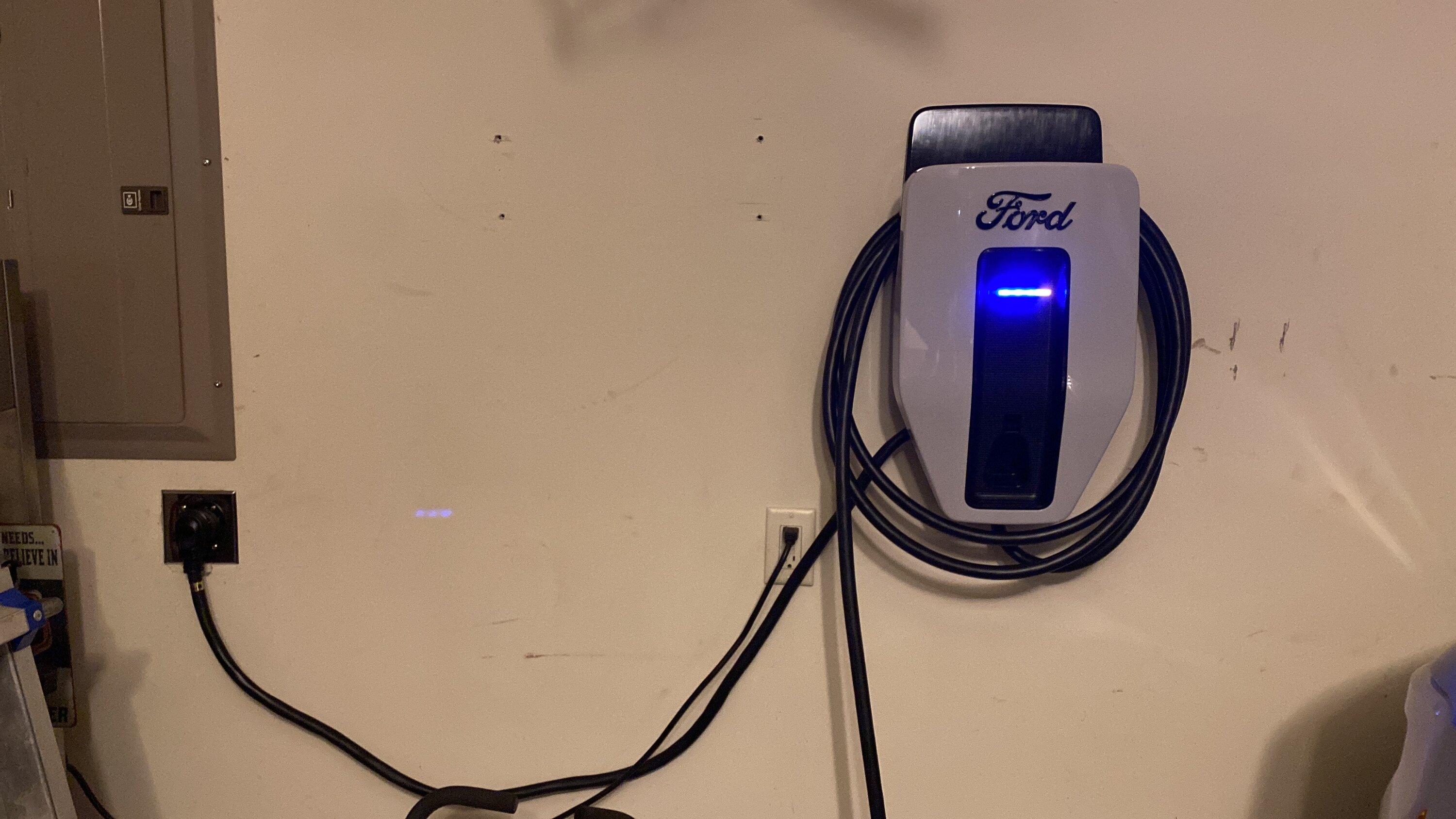

Yes. Not ideal but mine is plugged into a 14-50 till I find more power to feed it. It’s set to 40A of course.
Ford F-150 Lightning Sunrun wanting to install Charge Station Pro on 50Amp circuit 515FBE9C-AF35-4637-B03A-CDDFEE5DF587

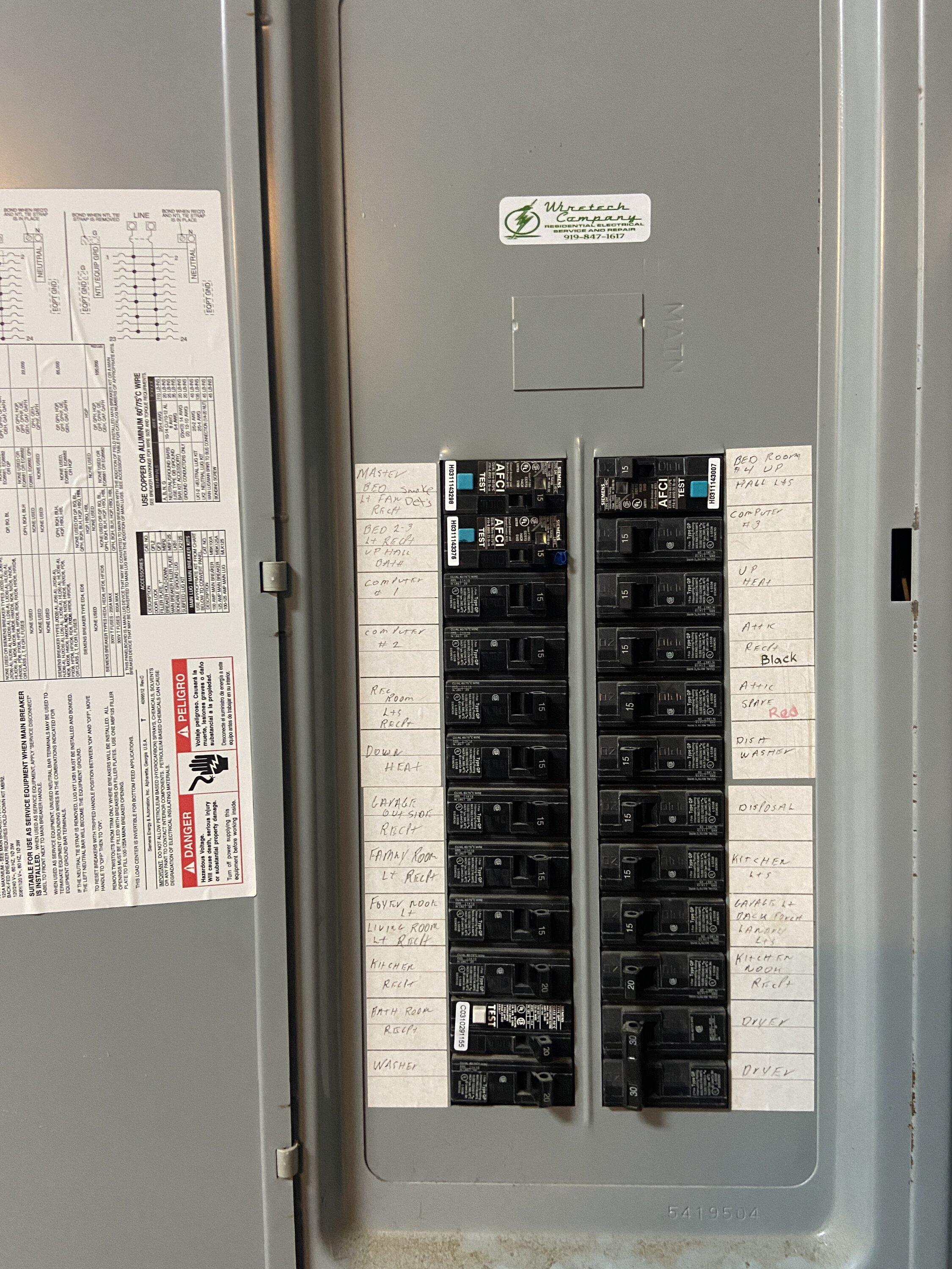

Be easier for you to shoot a photo of your panel and we can figure this out.

Looks like your due for a service upgrade just to acquire a panel with more space!!
Your main disconnect is up stream of this panel, possibly next to the electric meter.
Looks like it's not more than a 125
