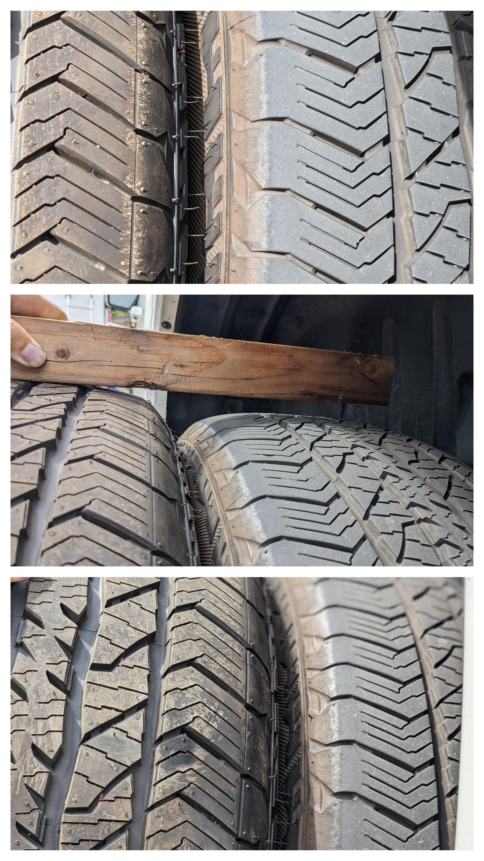

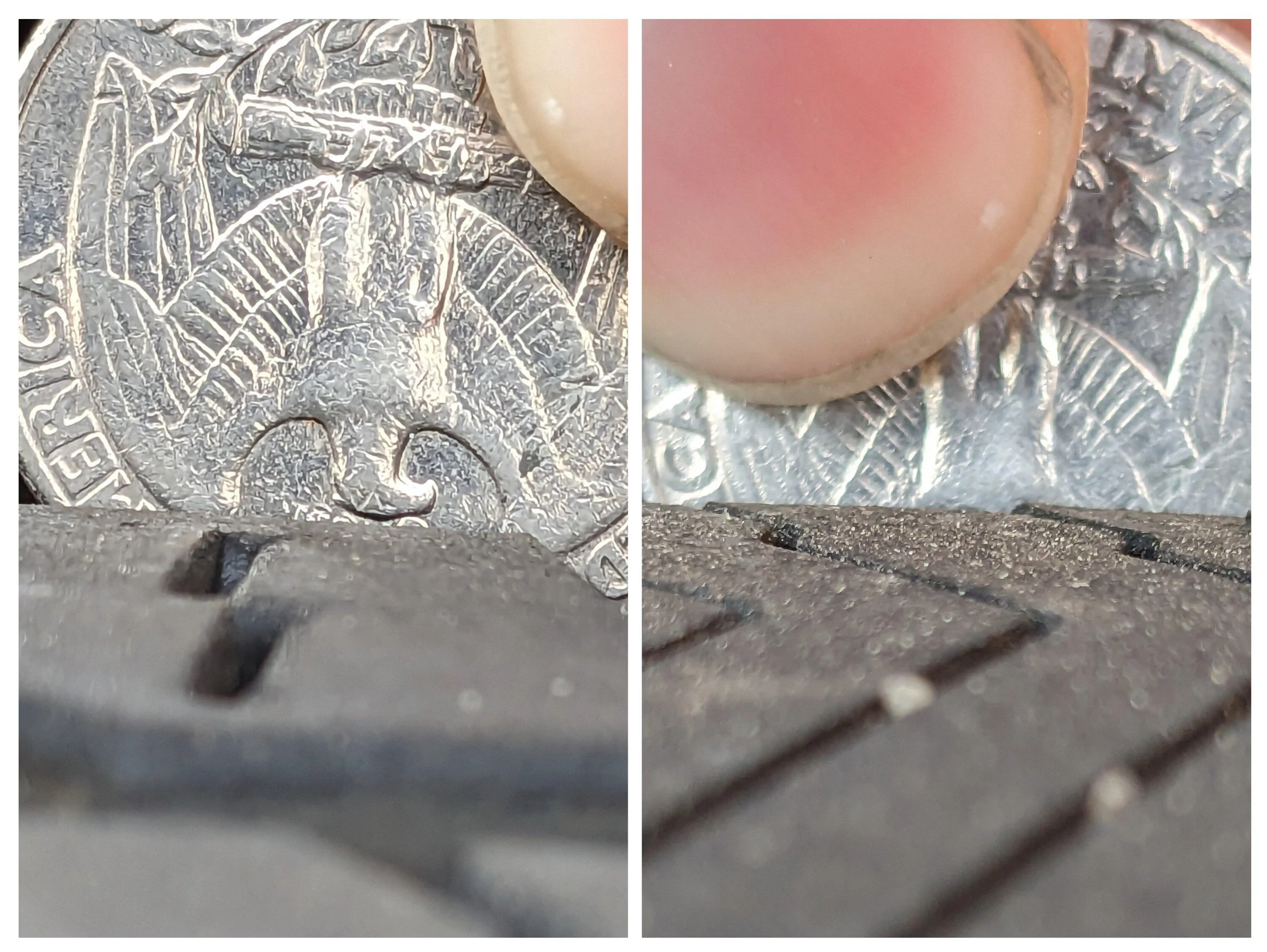

Stock Hankook AT2s at 9000mi. Kept at 36 pissys per the door, which usually results in around 38/39 while driving.
Seems like the fronts are wearing hard. Kinda wishing I'd rotated at 5000mi but I was holding out for the 1 year service.
Stock tires are on the truck. A new factory set is right next to them. Note the height difference and tread difference.
This inline with what y'all are seeing? Seems pretty bad.
Front:
Ford F-150 Lightning Surprised by tire wear 20230819_104646-COLLAGE
Rear:
Ford F-150 Lightning Surprised by tire wear 20230819_104842-COLLAGE

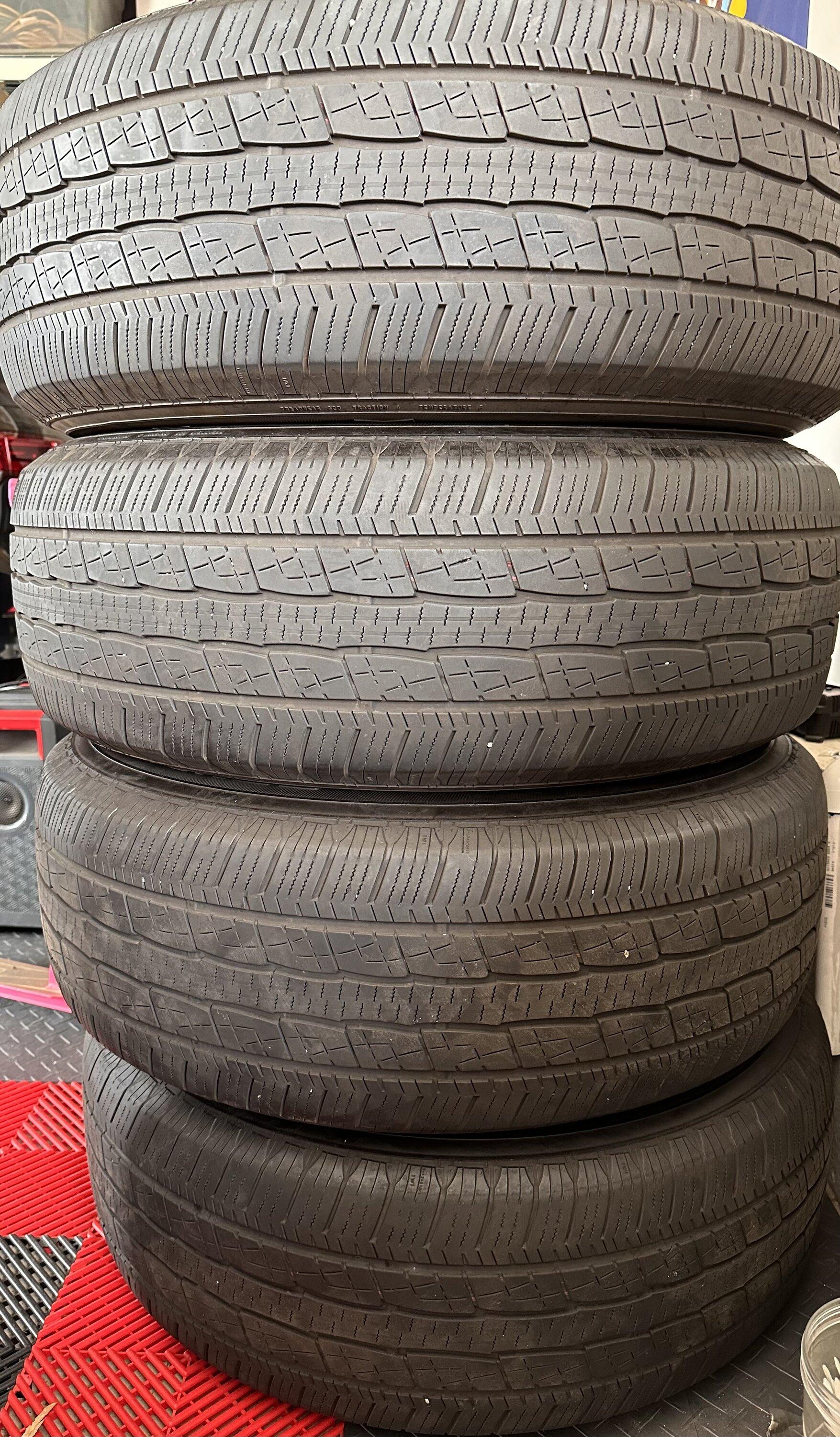

Here is my contribution after about 12k miles, I did rotate at 5k and 10k

Unless both tires are mounted on the same size wheel, those height comparisons are meaningless.
They are. They're both factory 20s with the AT tire. Same rim, same tire, as they left the factory.
4,233
5,641
Thanks for confirming. Can’t tell from the picts.

One is laden with truck weight the other is not, so you're losing a little height due to squish of the truck mounted tire. What does a depth gauge measure show for all four old tire F/R?

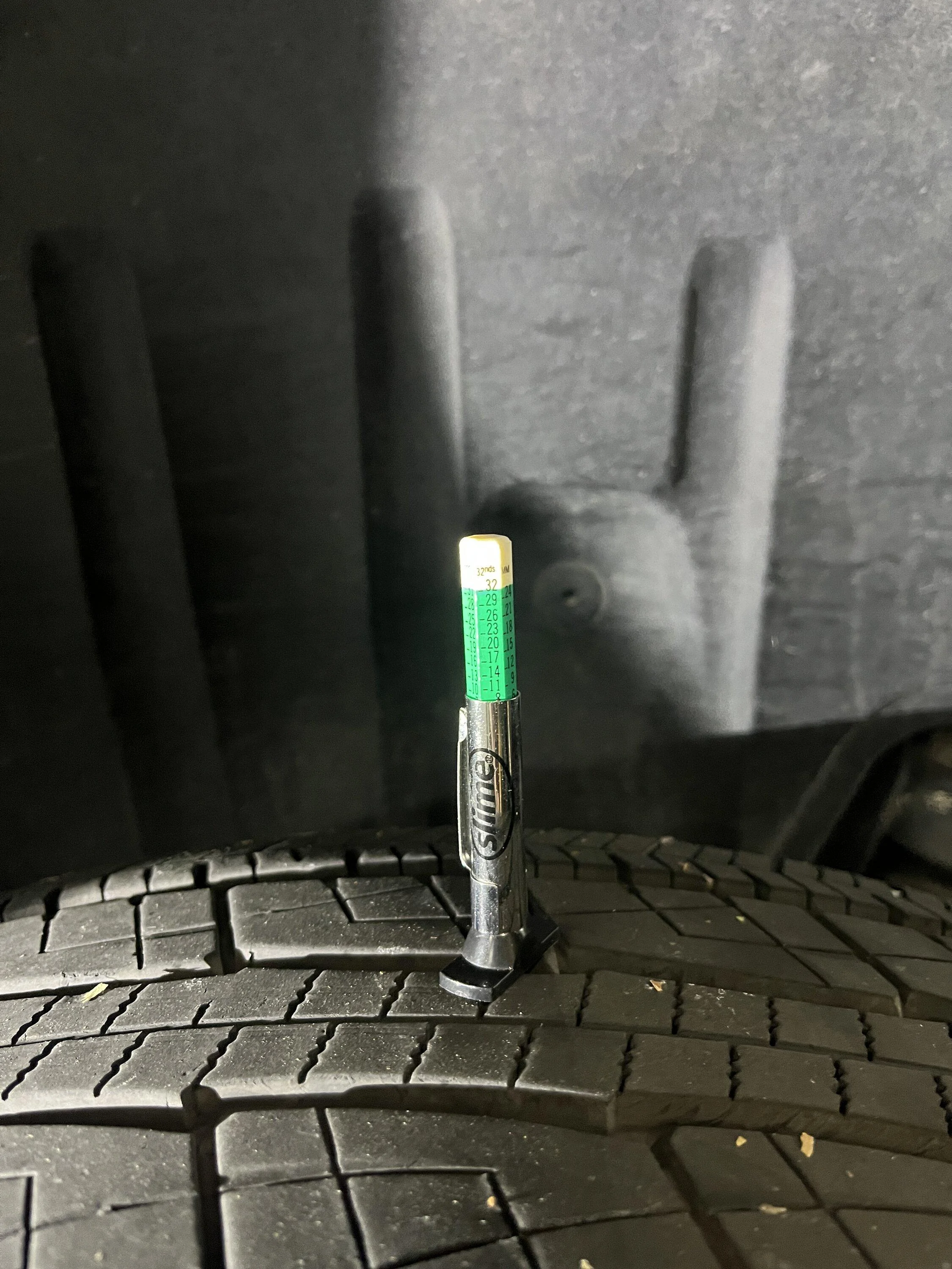

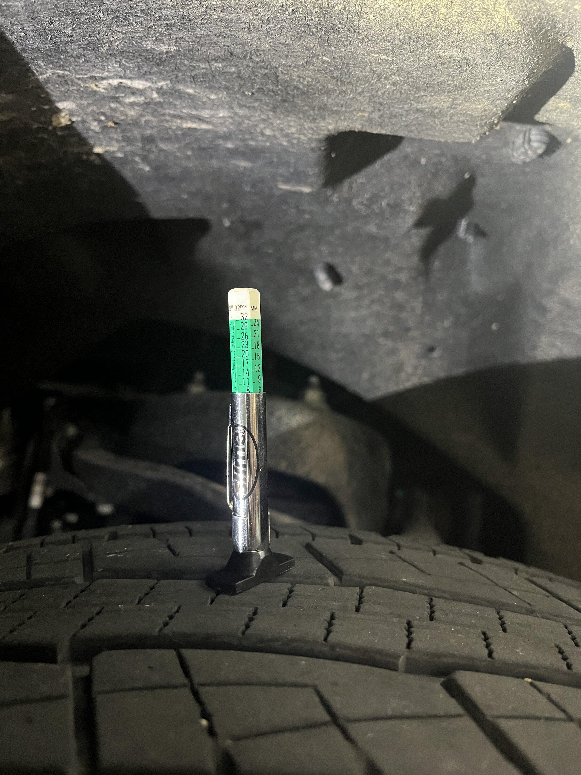

@TaxmanHog figured it out before I did! I was typing as he posted, but here goes:
Those photos don't make sense to me. New tread depth is 10/32" or about 1/3 of an inch. Bald tires would be only 2/3 of an inch shorter. Get a depth measuring device at the auto parts store. Here are my front and rear after 10K miles.
Ford F-150 Lightning Surprised by tire wear IMG_5306

I would suggest scientific dimes, it would be much more dramatic.?
