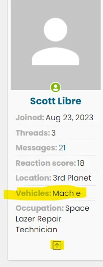

Which model Lightning are you driving???
Ford F-150 Lightning Tire Pressure Check 1703958114450

We have a 2023 SR Lariat (My Wife's) and I drive a 2022 Mach e Premium
I guessing you also in a colder region with AT tires, just pump them back up to 36 while tires are cold.
