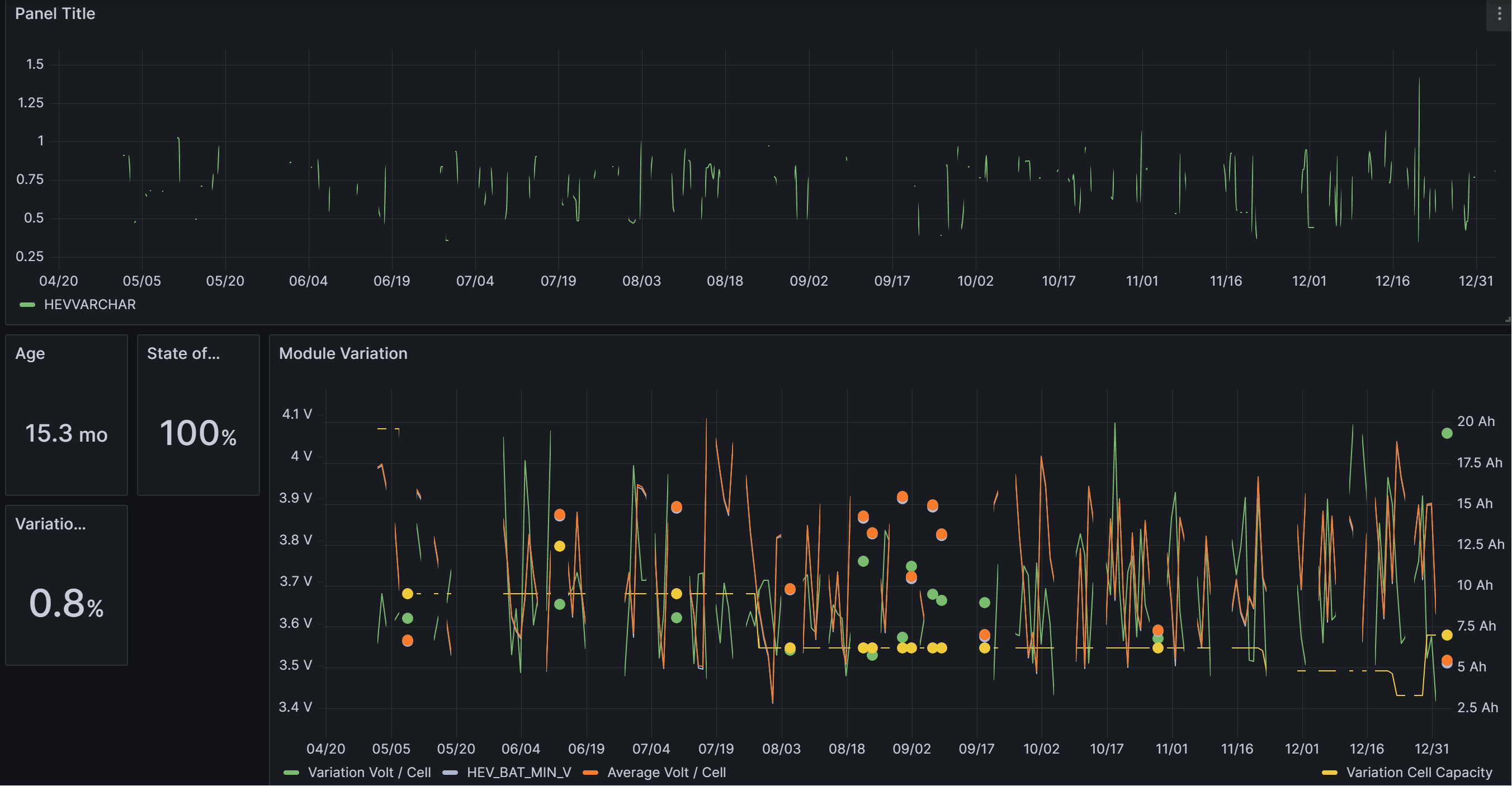

Ford F-150 Lightning Top battery off to 90% every day? 1704294820110
Maybe someone finds this interesting, it's my "black box" data for the past 7-8 months.
(I don't have any data prior to that as I wiped my database due to a change in naming convention / structure of the same)
As you can see - according to the truck - the battery SoH is still 100% after 15 months and the module variation is pretty consistent over this whole time.
I do not follow "ABC" simply because I don't have that option, instead I charge when I get to 30-40% SoC and charge back up to 80%.
(I chose battery deg over dings from acorns and falling branches as my charger is outside, detached garage in a non forever home, cost prohibitive to trench and install charger in garage, power company wouldn't let me do a separate meter on the garage)
