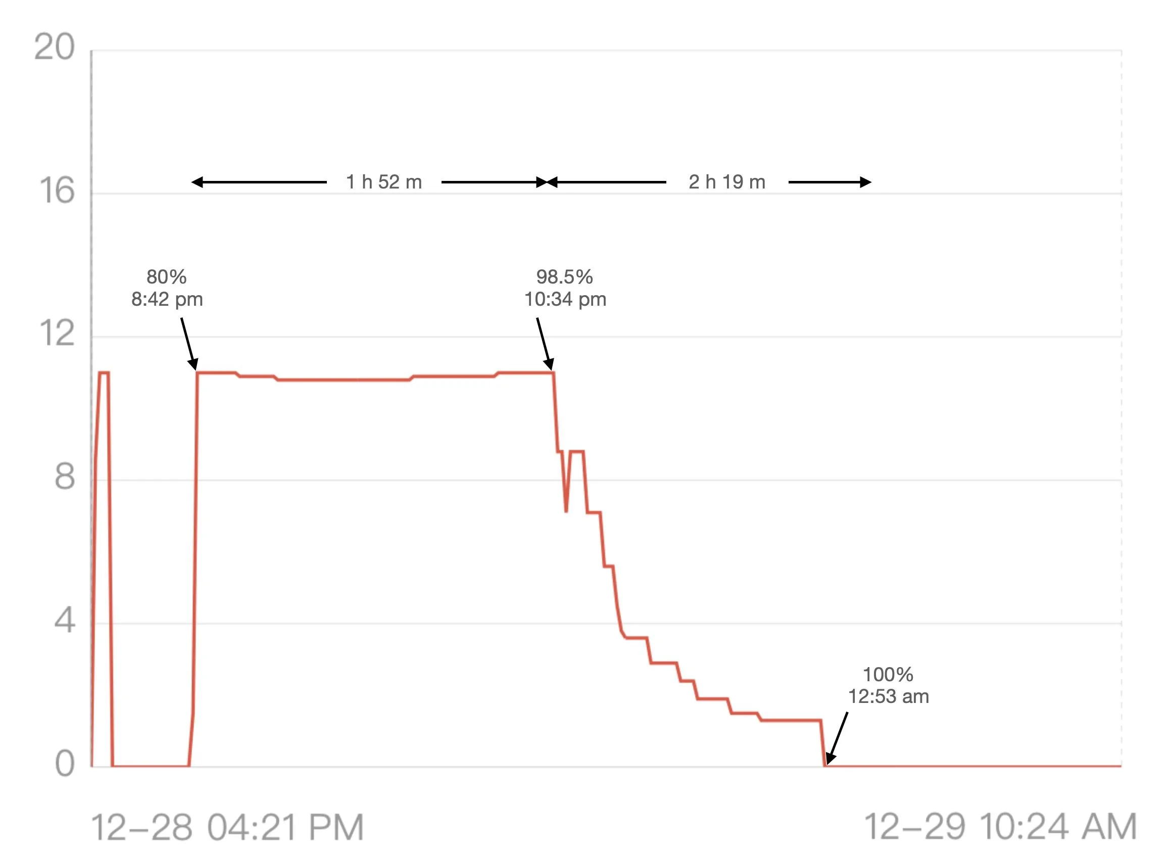

I've been charing to 80% since I took delivery but only because it takes as much time to charge from 20% to 80% as it does to charge from 80% to 100%. At least that's what I've read and heard. If I am wrong I would love to know...
4,133
5,449
You seem to be describing the charging curve for DCFC, not L2 AC, which is generally what this thread is about.
As @Maquis says above you are thinking of DC. You start to lose time when the truck is requesting less than the equipment can supply. That happens a lot sooner when there is 100 kW or more available on DC. The curve below shows my last 100% charge on an SR battery using a 48A (11.5 kW) EVSE. I had taken a short drive earlier that day and the first spike is charging me back to 80%. At 8:42 pm I hit the charge to 100% button and at 10:34 pm the truck started to slow down the charge. I'm estimating the 98.5% based on the time, an average of 11 kW, and about 10% loss. Regardless, it spent over 2 hours squeezing the last few electrons into the battery.
