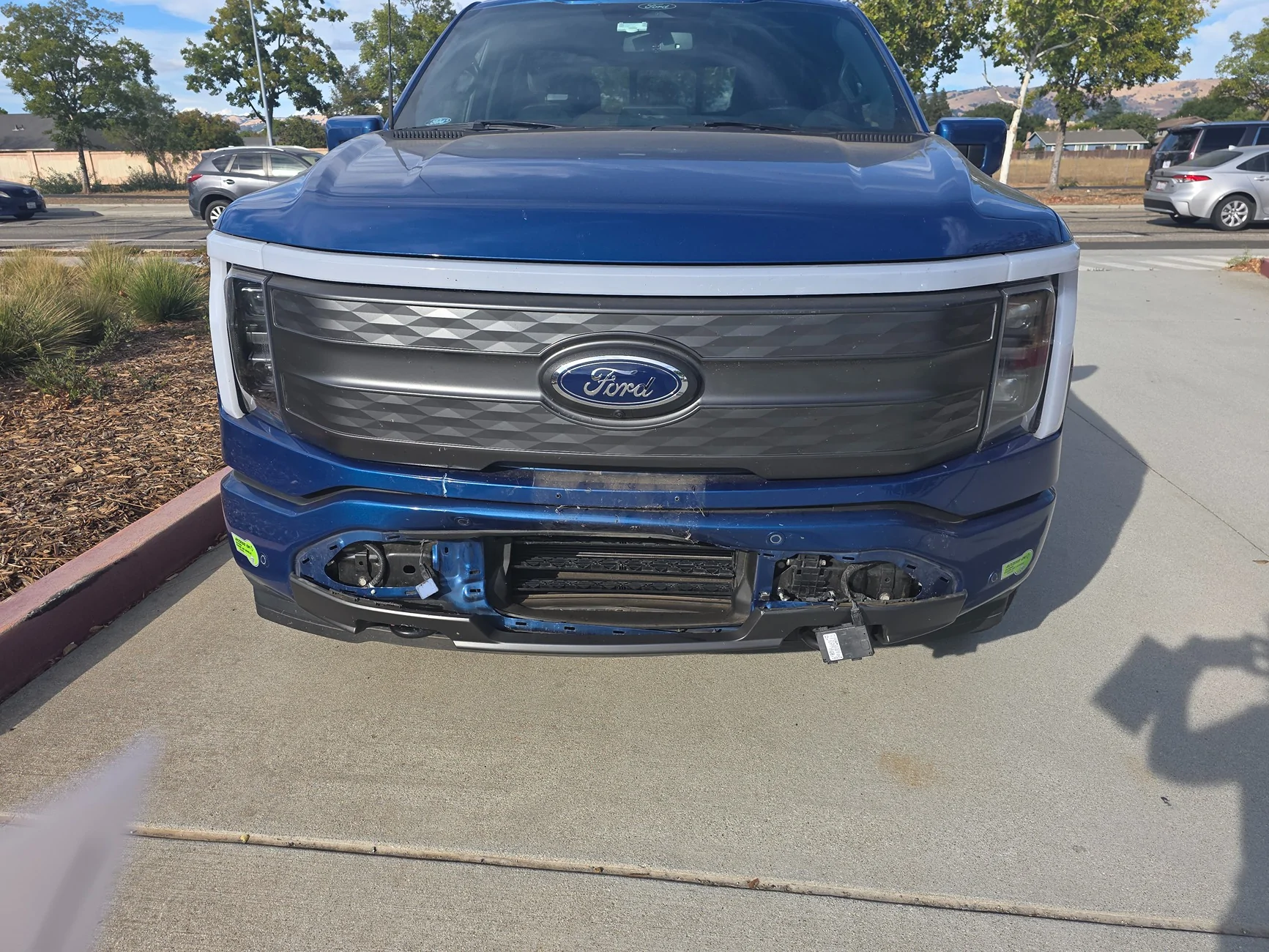

Truck accelerated from stop and rear ended car in front.

I think regardless of the cause, we're all aware that what Carla posted legitimately happened and it's an emotional situation for which none of us should be assigning blame (not to suggest anyone has).
I'm surprised the forward collision system didn't recognize that there was an object (vehicle) in the driving path and apply the brakes. Was that possibly disabled? Or maybe because both that vehicle and your Lightning were stopped (and in close proximity), it was somehow not working as intended?

Pre-collision assist does not activate until speeds are above 3 mph. It doesn’t automatically apply the brakes unless it detects an imminent collision. The OP’s situation was likely such that there was no data indicating an imminent collision in time to stop the collision.
The vehicle can fail to recognize potential obstacles if there are any obstructions on the windshield in the area of the rear view mirror, where the camera is located. This can be dirt, cracks, etc.
It can also fail to recognize obstacles if those obstacles are too close. This is true for the radar, the camera, and the sonar.
It’s likely that whatever caused the acceleration didn’t bring the speed up beyond 3 mph at all and certainly not for very long. A 3 mph speed over 1 second moves the vehicle about 4.5 feet. In 2 seconds, it’s almost 9 feet.

I also posted this to the Reddit group, but will cross post here as I can use any and all information that others can share. I was stopped in traffic on a 4 lane road. I'm using one pedal mode, so my foot is not on the break. All of a sudden, the truck takes off, rapidly. I slam on the brakes, but not in time to keep from rear ending the tacoma in front of me. My husband says he has had the truck take off like this when he accidentally hits the resume button on the steering wheel with his arm. I don't recall this ever happening to me. Anyone ever experience anything like this? Will they be able to download any data from the truck that will explain what happened? Shouldn't the truck have recognized there was an obstacle and either not moved or stopped on its own? Again, appreciate any information or advice that would be helpful. BTW, it just updated to bluecruise 1.4 2 days ago.

When I'm following a car on the highway, going slower than the set speed, and a motorcycle splits lanes past me it wants to keep up with it. Did a motorcycle split lanes past you while you were sitting there?

I posted the same issue over a year ago. I backed into a parking spot. When I returned and started the truck I was instantly 25 ft or so out in the lot before I could hit the brakes. I don't even recall if I touched the pedal AND at that time I never used one pedal driving. All I remember is starting the car and frantically going for the brake pedal. It has never happened again. Thank God nobody was walking in front of my truck. This has never happened since. You will see tons of folks explaining what you did "wrong" BUT, @Ford Motor Company please take notice, I think there's a glitch in the software...
