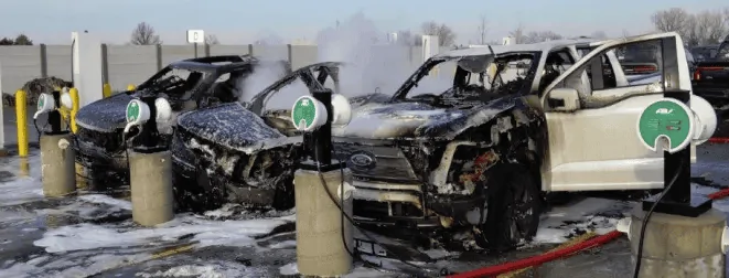

It is fairly safe unless you have one of those special trucks ;)
Just out of curiosity, what is the story behind this pic? It looks like someone doused them and set them on fire.
An incident with one of the trucks battery packs, this was the genesis of the production hold in the winter/spring of '23 while FoMoCo investigated issues with cell quality in certain battery packs. It's ~assumed~ with out final reports from the MoCo that a defective cell went thermal while being prepared for maintenance charging and eventual shipping of these trucks.
