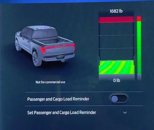

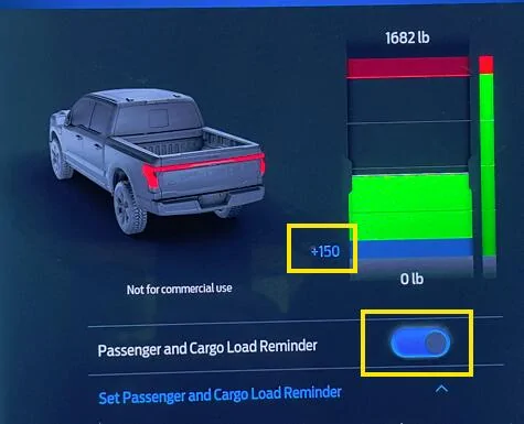

Here are my screens with no load and 150 lb reminder off and then on:

Note with the passenger reminder, a blue bar and the +150 appears at the bottom of the graph.

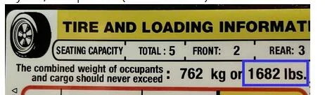

Is this similar to your observation? Note the number at the top (1682 in my case) is not the weight but the cargo capacity of your specific truck from the tire placard.

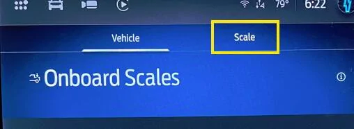

You might reference this post. There is also a scale mode but I haven't figured it out:

Yes, BM exactly how mine is acting and what im talking about, except my green bar is up just past midway up without the passenger reminder on, and halfway up to the next line above half with it on.

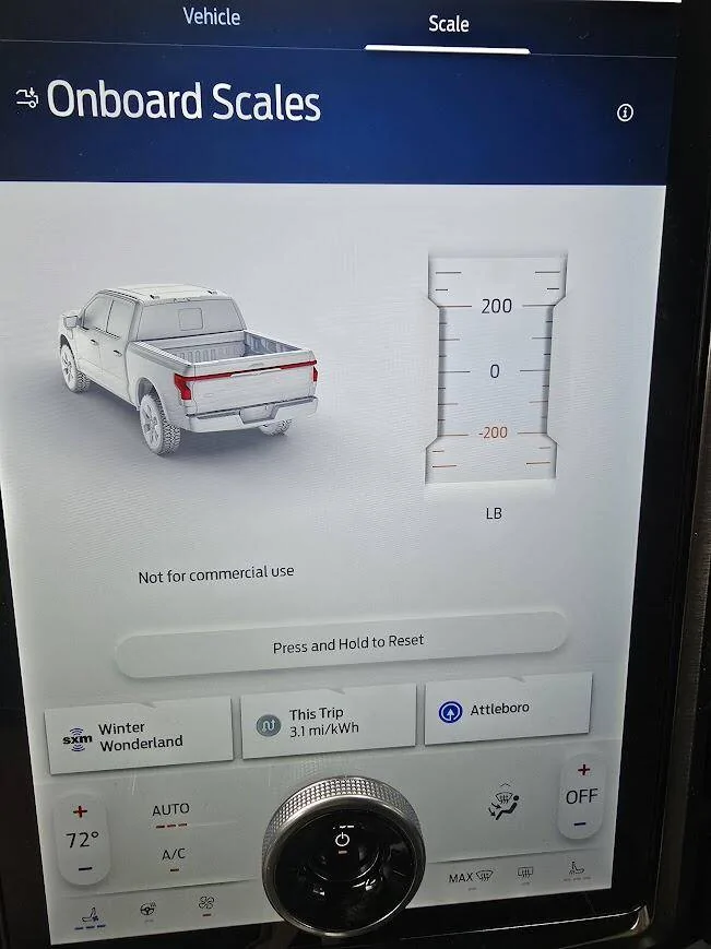

The scale is to zero out and weigh specific things going in. like how much does this box of junk weigh on its own.

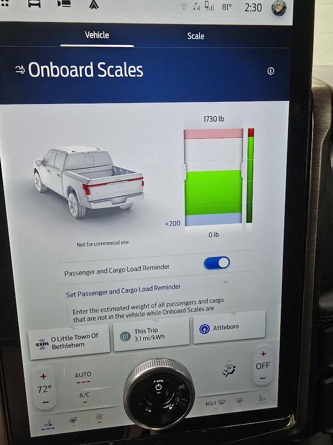

This is what I'm seeing, only extra weight is my 253 # butt and tonneau cover.
I adjusted for the passenger weight on/off

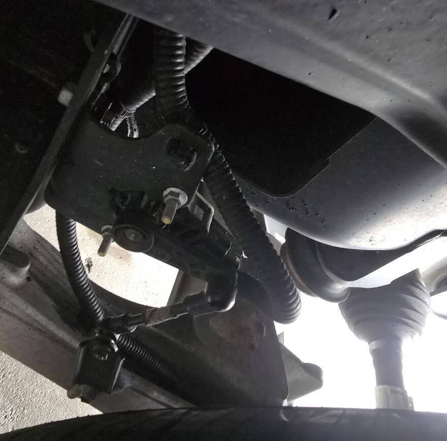

The scale sensor is between frame rail and swing arm left rear wheel

The scale sensor is between frame rail near left rear wheel
Thats exactly what im seeing, picture wise. might be a tad higher but i think its right about that. any idea why they are so high empty? Im thinking its gotta be wear on the shocks thats allowing more weight down onto the sensors. I cant think of anything else.
The shocks are intended to dampen oscillations of the suspension not bare weight.
I think the calibration of the sensor itself is the problem.
Yeah thats true, now that i see how its measuring it, and true about shocks... was just trying to think of things. Not sure how the sensor calibration would get wonky, as it was 1 owner before, and a construction company, so i doubt they would have messed with any software.
It could potentially be wear on the springs, shocks don't support weight, they just dampen the springs so they don't pogo.
