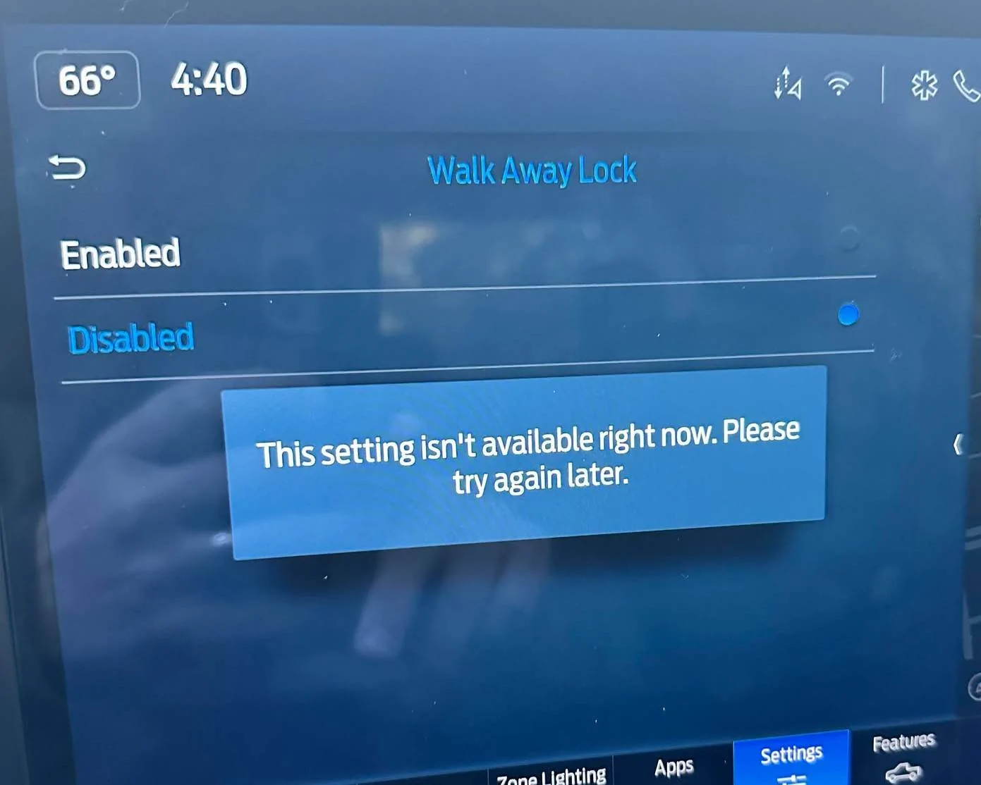

Hello,
Long time lurker first time poster here. I purchased a 2024 Lightning XLT on last Saturday (12/28). Yesterday, I had some time, so I was going to get it setup how I'd like. Going through the settings I was looking to turn off the honk for the walk away lock. When I tried to change the audible feedback I got the "This setting isn't available right now" error. I thought OK I'll just disable WAL and reenable it. Once I disabled it I now get the "This setting isn't available right now" error every time I tried to enable it.

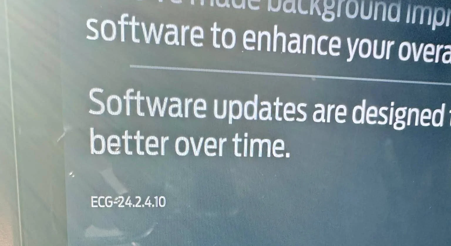

Now I don't know that this is related, but after this while changing some other settings, I got the notification that my truck had been updated (ECG-24.2.4.10)

Thanks, it's still happening today, over 24 hours later so I don't think that's it. I didn't think about the feedback, but I will do that.

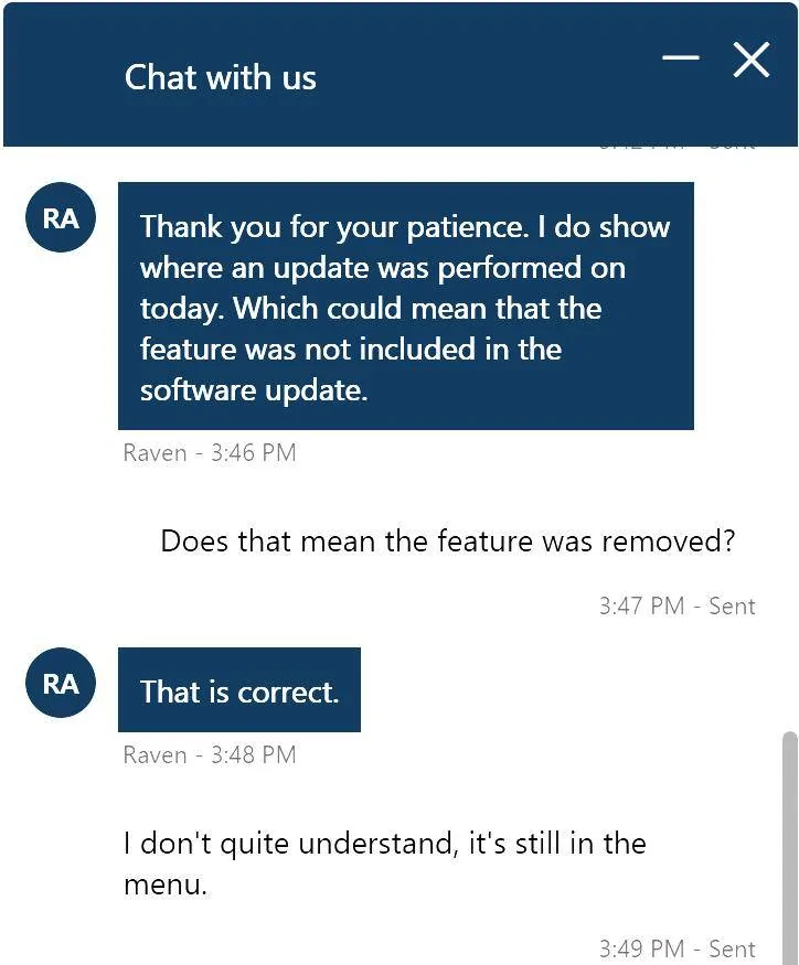

So far not thrilled with the Ford (corporate) support. I didn't document everything in the OP but I first used the chat on the site and the answer was that the feature was removed, which I knew wasn't the case, so I pressed. They then told me to call, which I did and was passed around a few times before they had me try the module reset then told I'd have to take it in. If there's telemetry and someone calls in with an issue, you'd think they'd be able to check it or at least pass it on to someone who could.
