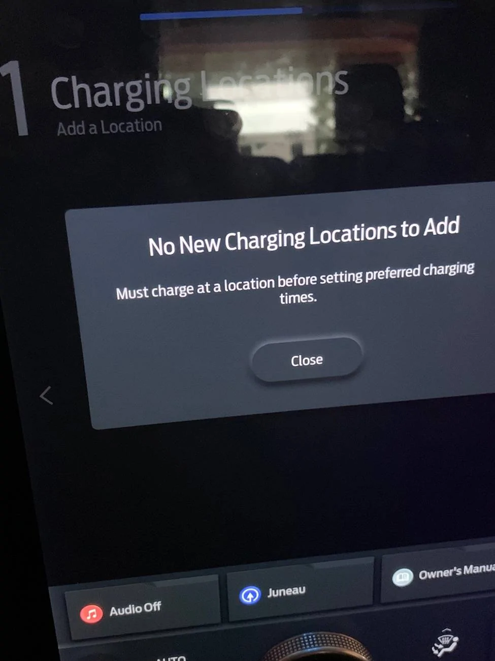

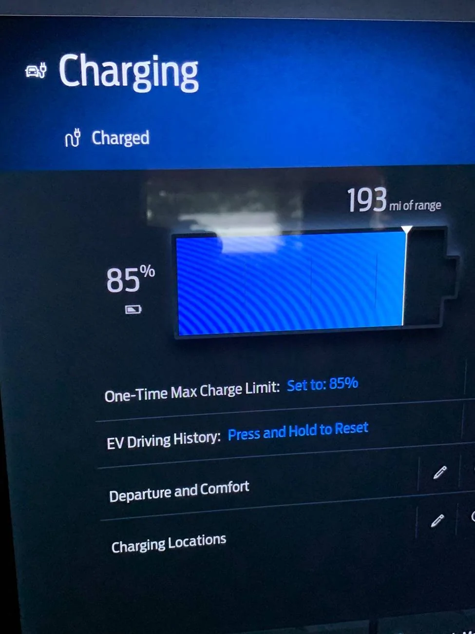

I'm not able to get this to work. I cannot add a charge location, even after charging.
Your EVSE must be able to send energy at the moment you plug in.
Unplug, change the ONE time limiter to 100%
Plug in allow charger to start
Then you're going to calibrate the 85% in the scheme rules that will then be able to build.
Once built & saved the EVSE will halt, rules saved and cloud replicated to the Fordpass
