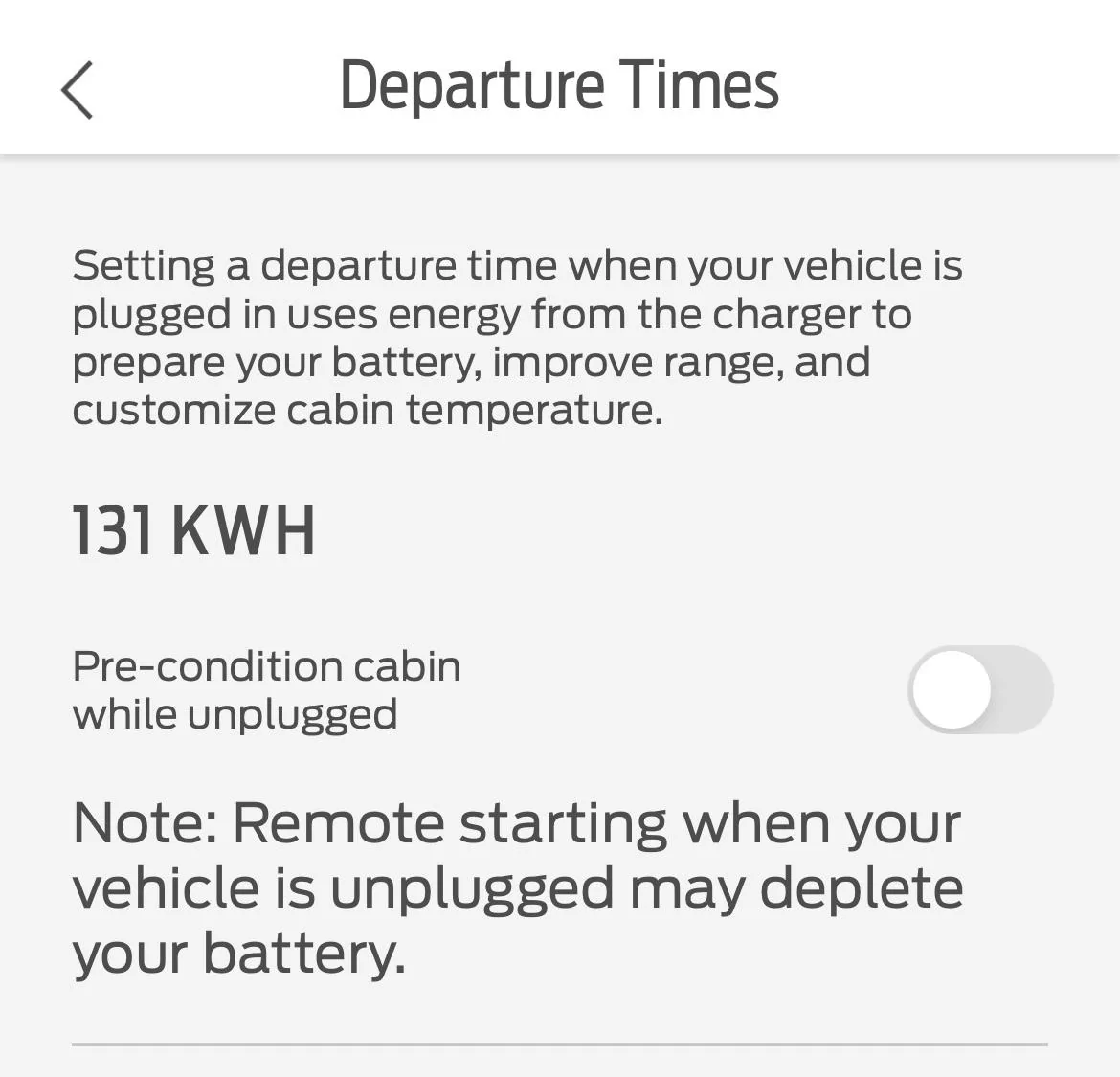

Who does this? What actually occurs when you flip this on?
Ford F-150 Lightning Precondition While Unplugged? IMG_5406

Preconditioning while plugged in preconditions the battery and also uses the heat/ac to condition the cabin for your desired comfort level. That switch gives you the option to not waste battery power conditioning the cabin if you're not plugged in. It would only do the battery.

It allows the truck's High Voltage Battery to prepare itself and the cabin for your departure time without being plugged into shore power. The reason it's an option is that it uses power from the HVB and can negatively impact overall range.

If I was designing that screen/function, I would have set that switch to say “precondition the battery while unplugged” and have if off by default. My assumption is most people more often than not want the cabin warm but won’t see the benefit from heating the battery for their short daily drive to the office.
The only concern I would have with driving with a cold battery is that it seems like Ford does not reduce regen when battery is cold and I am not sure how much damage that does long term.

This is what Ford used to call "Scheduled Start". Throwing the word "precondition" in really makes no sense.
This function is just like remote starting your truck. You can just schedule it in advance. It warms or cools your cabin, and does nothing for the battery.
. . . . if the truck is unplugged. If the truck is plugged in when a scheduled departure time approches, the truck will use shore power to precondition the battery - and warm/cool the cabin or not, depending on that switch setting. It also may or may not warm the steering wheel, which may or may not work for the duration of your next drive.
Incorrect. Precondition while unplugged "only preconditions the cabin'. Using battery energy to "prepare itself" to thus be more efficient would be the proverbial dog chasing its tail. Its Pointless.
I 100% agree with @Pioneer74 that Ford's terminology here causes unneccesary confusion .
This is the correct answer. The only thing this setting does is allow you to schedule a departure time to warm the truck without being plugged in (and not using the FordPass app).

I use this so the cabin is warm when I leave for work in the morning. My commute is short so I don't plug in every night.
