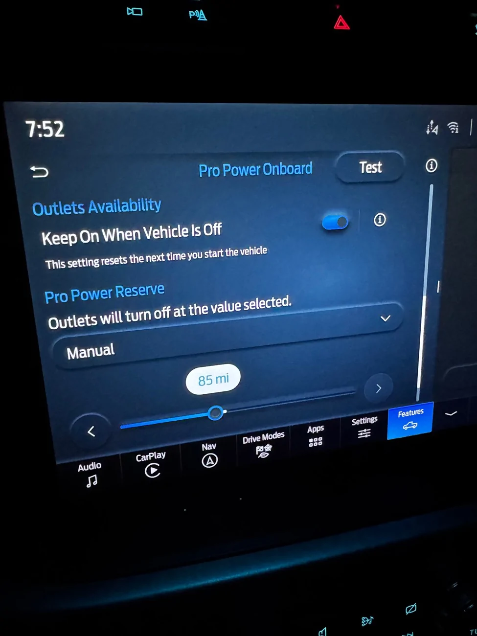

@PJnc284 @shoopg @21st Century Truck and others - are you seeing this behavior with the PPO reserve sliders not working now? I verified via DM that @lightning-spark has updated modules and he sees the "Keep On When Vehicle is Off" toggle. But apparently the reserve sliders no longer work for him.
PPO reserve slider is working! Disconnecting the 12 volt battery for 10 minutes did the trick. Some other very strange behaviour before I did that. I love the truck and it's a feature that I really wanted. Thanks everyone! :clap:

It's working! Disconnecting the 12 volt battery for 10 minutes did the trick. I love the truck and it's a feature that I really wanted. Thanks everyone!
Did you try a Sync reset first? That usually clears up glitches on the center screen. If you aren't familiar, holding down volume down and next track on the steering wheel for about 10 seconds forces a Sync reset.
Yes I tried the sync reset a few times before I disconnected the 12 volt battery.
