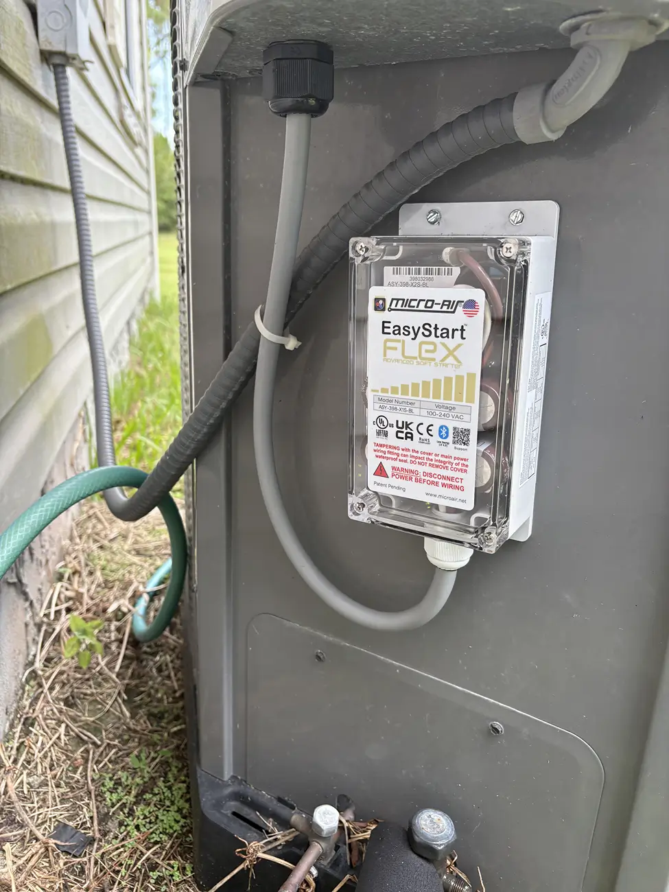

I’m curious, can you run your entire house, HVAC off the Lightning? I understand it will consume power faster, I was just wondering if you have and how long the truck maintained it?
You have to manage power for sure as with any small portable generator. The Lightning will run a good 2-3 days managing power.
At our cabin I can run most everything except I have to only use one of the 240v appliances at a time. The AC, the Hot Water Heater, the well pump etc. So for example, When I need to heat the water in the hot water tank I turn off the AC and the well pump breakers. Once the water is hot I turn off the HW breaker and turn on the well pump to take a shower.
The Central AC was initially an issue since the compressor start up amps exceeded the Lightning capacity and caused the Lightning to trip its breaker. I initially put a window AC in the Master BR and didn't use te Central AC. . Later I installed a MicroAir Easy Start https://www.microair.net/products/easystart-flex-home-ac-soft-starter on the Central AC condenser that reduced the start up amps and allowed the Central AC to run on the Lightning.
There is one other hiccup using the Lightning with a Interlock bypass kit. While a portable generator will function plugged into the generator inlet the Lightning will sense a ground fault and trip it's breaker. If the ground is not connected from the Lightning to the Gen inlet it will not trip. Installing a transfer switch with Neutrals switched eliminates this issue. A Licensed electrician can advise.
Here is the Micro Air installed on my AC
