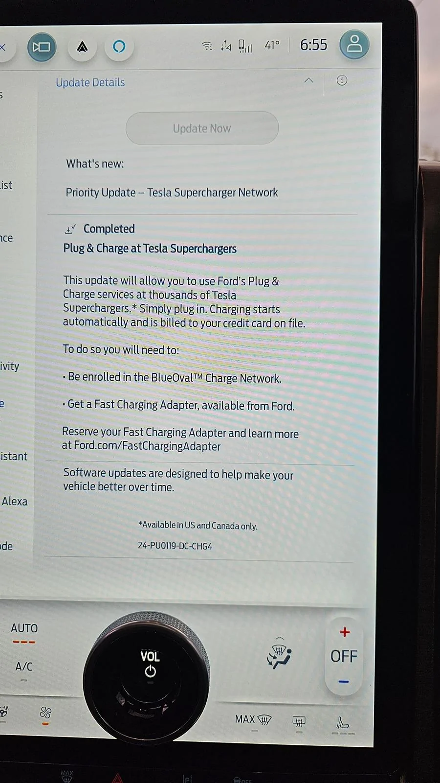

I'm pretty sure that I got the 6.8. I tried Fordpass with no luck and I tried looking at the update page in truck but it says the last one is the Tesla Charging update. Where do I find which version my truck has?
Thanks.

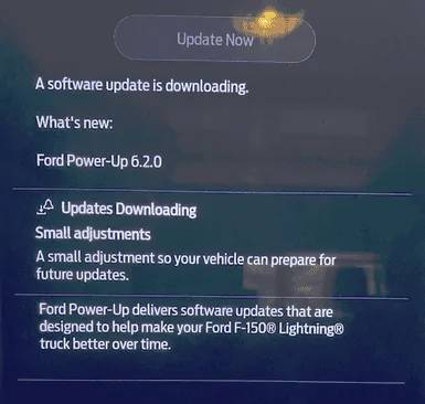

In your truck under update details you can see what the last update you got. Either with text on top like this:
Ford F-150 Lightning “This Trip” does not reset 1711581579760-19
Or sometimes at the bottom. It could be in a very small text.
The previous updates should theoretically be listed in your Ford-pass but I have had many updates that did not show up there. So I try to keep track of them myself.

Hmm... this is what my UPDATE page looks like.... :unsure:
Ford should list all your updates with installation date here not just the last one. I personally didn't care much about HV SOC percentage in numbers.
You probably didn't get 6.8.0 yet, I wish @Ford Motor Company would provide a comprehensive history [CHANGE LOG] for each vehicle, no two follow the same update path........................
