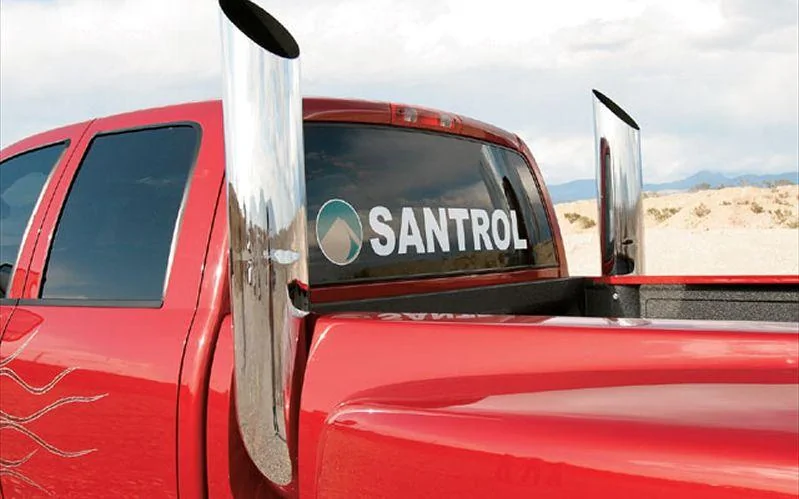

Ordered my faux Stacks for the bed. :p
Lol, I was thinking of channeling music through them but bubbles are by far the better option.
Also think of the confused or pissed off looks that would get when taking up a charge point space.

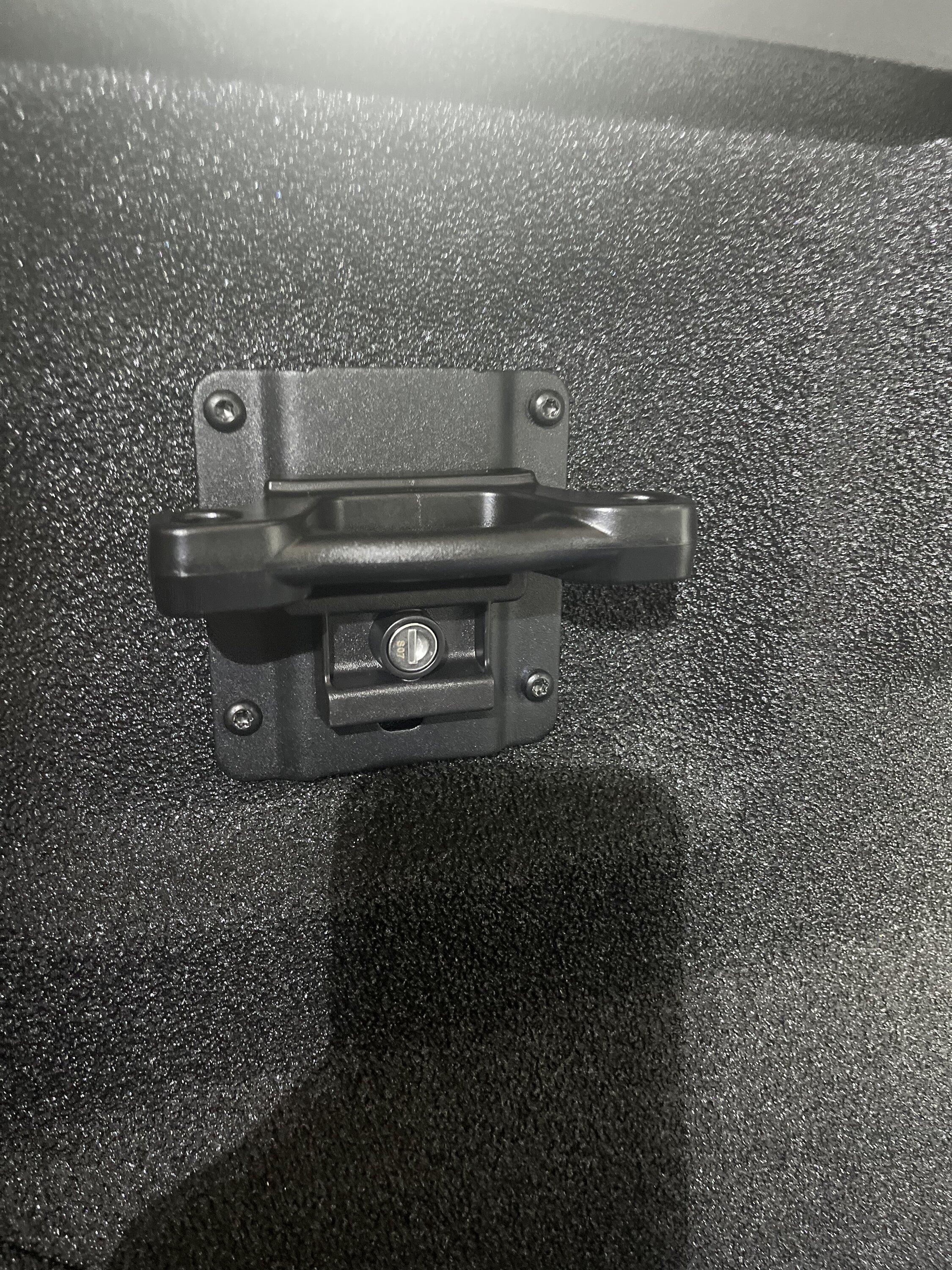

Added Ford BoxLink to my Pro.

How was the fit with your bed liner? I had heard about others having fitment issues after a spray in bed liner, and sure enough, I found I had the same. I've seen various suggestions to resolve it. What did you end up doing?

This was a dealer installed bed liner.
It was somewhat in the holes for the boxlink. But really, all I did was use a round Torx screwdriver T-27 (actual screwdriver and not the bit on a driver), found it was the right size and just ran it though each hole to clear it out.
THen used some spray silicone on the bolts and used a T-30 to drive them in a bit by hand, then used an impact to drive it home. It was not a problem.

I was referring to the cleats.

No issue. Slid right in and up. Locked right in. I have a very thick bedliner. Thicker than most and it isn’t an issue.
my wife’s XLT has the premium LineX liner and it isn’t an issue there either.
These are the Ford OEM plates and cleats. I know some people buy the China knock offs off Amazon, which I understand, but that may be their issue…. ?‍♂
