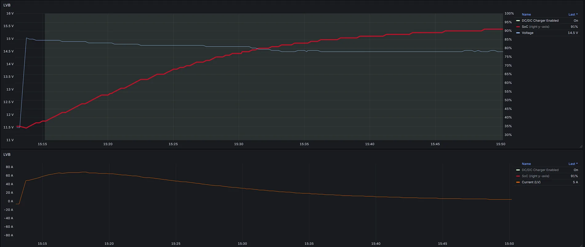

Yes, as others have mentioned it does, but....it was never enough to get my battery up to the 80-85% SOC needed for the OTA...customer service told me to drive around for 1 hour, I did that and then tried the install, did not work, I drove around for another hour or so, still did not work...overnight charging to 90% from somewhere around 60% did work however...
Certainly how often you drive and for how long is a factor. I don't drive long distances or for long times and don't drive every day, so a trickle charger is what works for me.

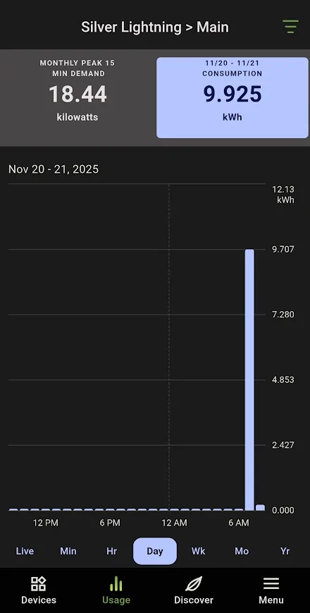

Interesting experience for myself today, I have not driven the Lightning since yesterday afternoon, today my wife did her errands with her car while I stayed at home to monitor a fencing crew working on our property.
I wanted to access the trucks departure time settings via Ford App, but the truck was not responding to any LTA communications, no status update, door lock confirmation (well past BT range) and error out when I tried to switch on my departure routines, which was temporarily shut off when I parked her yesterday.
So, I go out the the garage, with FOB & PAAK device, jump in the truck, no immediate screen wake-up, and when I pressed the START button, I was greeted with the R2D2 tones instead of the normal start tones (reminder that I wasn't buckled up).
At this point the truck has started and now is communicating LTA and Ford App & Truck are responding to commands and data request, {Lock Door, Location refresh, Switch on Departure time schedule}
My relatively new (August 2025) DieHard is probably been stressed by me leaving the Veepeak BT plugged into the OBD2 port for several months ongoing, not helping is the fact that I also have relatively short drive cycles so the DC/DC charging sessions aren't worth a hill of beans, I only plug in and charge once a week, either Saturday or Sunday evenings.
I've unplugged the Veepeak and stowed it away, plugged in the EVSE for ONLY departure timed preparation Friday morning (Setting SOC level to 50% well blow my current 75% current SOC) this will reserve energy availability only for servicing the departure preparation, I anticipate the PTC will activate overnight and certainly when the departure event kicks off, that ~ 15 minutes of energy might give a little extra boost to the LVB, and minimize HVB burdens warming the truck cabin, I'll also waste a bit of energy ~3kWh warming the battery.

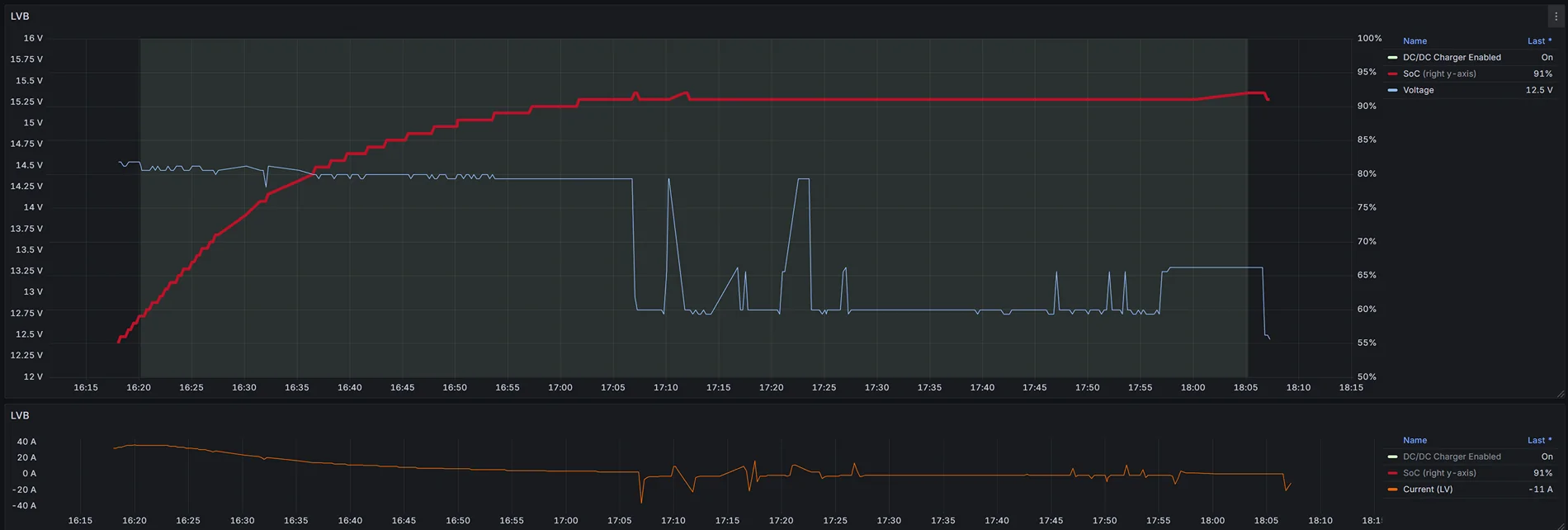

Another noteworthy thing is that I'm wondering if Ford have toned down the charge curve for the LVB. The top chart is from September this year, the other one from November last year. 36A now (which is still a lot) vs. 70A a year ago and I've seen as high as 100A in the past, so that could potentially have been frying batteries as well, along with all the other issues.
All that said, I changed my OEM for a Diehard 626 days ago and despite draining it completely by accident it's held up quite well, my SoC does not seem to drop below 60% despite leaving the truck sitting for days (unplugged) and driving semi-short 20-25min distances (commuting to work)

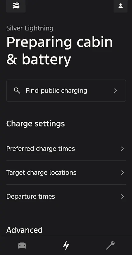

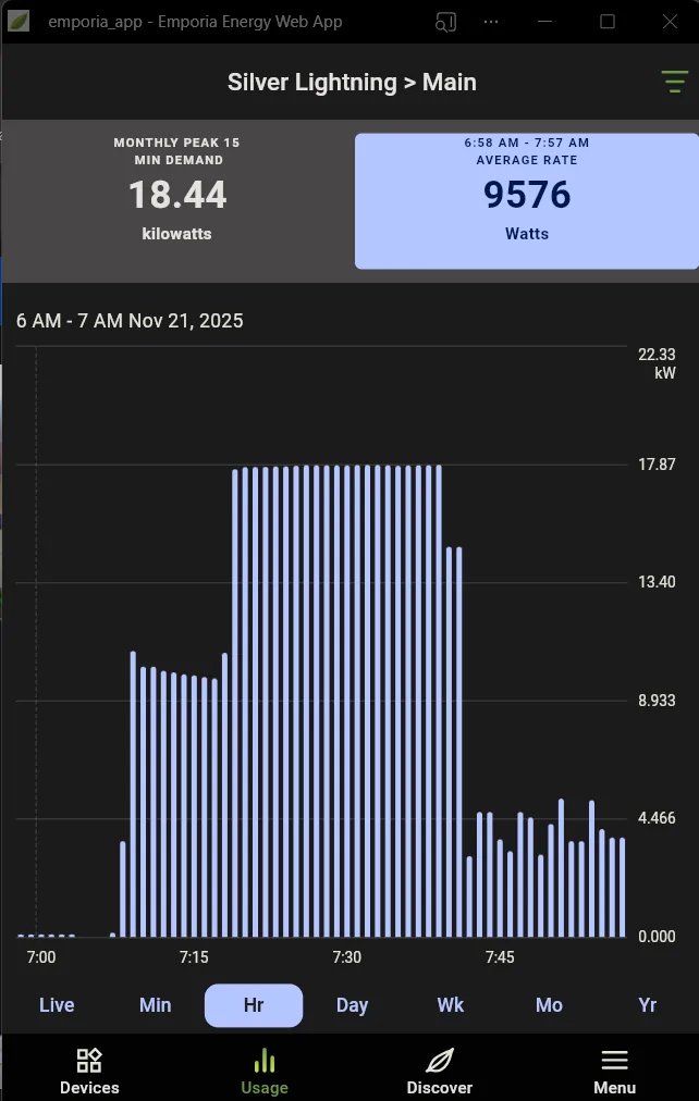

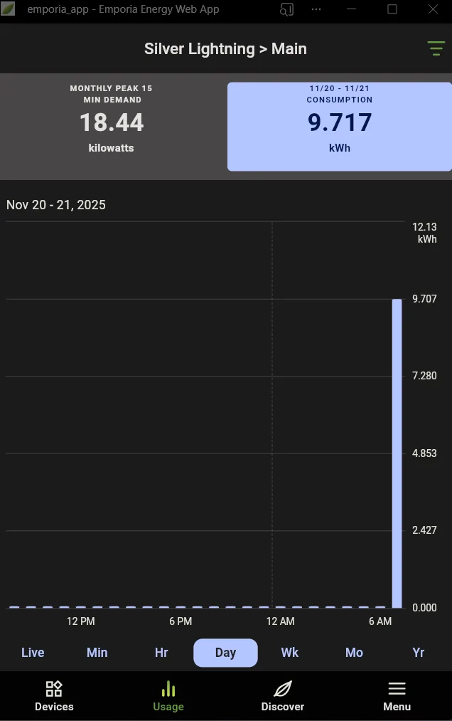

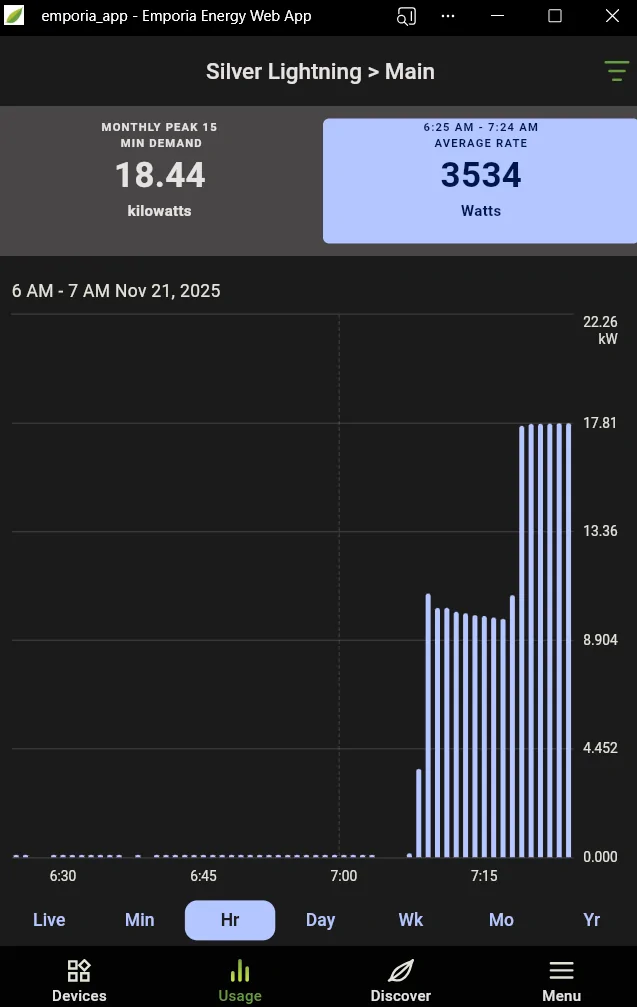

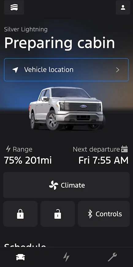

Just as I suspected, being plugged in my departure event for 0755 hrs has caused the Lightning to determine a battery warming phase should start at 0707 hrs, it quickly ramped up to 10.6 KW at the moment, let's see how long this phase lasts, it'll eventually slow or pause before cabin warming phase kicks off at 0750 hrs. While this is going on the LVB is getting some love as well.
Ford F-150 Lightning 12V battery replacement poll 1763727099700-6r
Ford F-150 Lightning 12V battery replacement poll 1763727433091-69

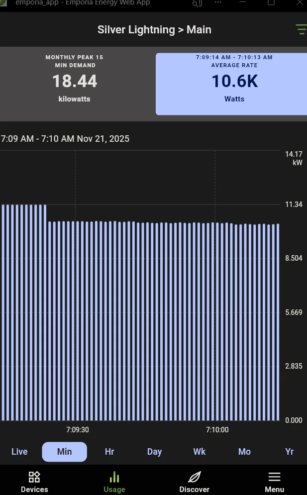

Now 0725 hrs and the energy rate has jumped to nearly 18 KW, this has been suspected to be a battery charging effort on top of the warming effort. note the data pane for charging details is still suppressed and only says preparing cabin.
Ford F-150 Lightning 12V battery replacement poll 1763728030347-n8
Ford F-150 Lightning 12V battery replacement poll 1763728080786-0c

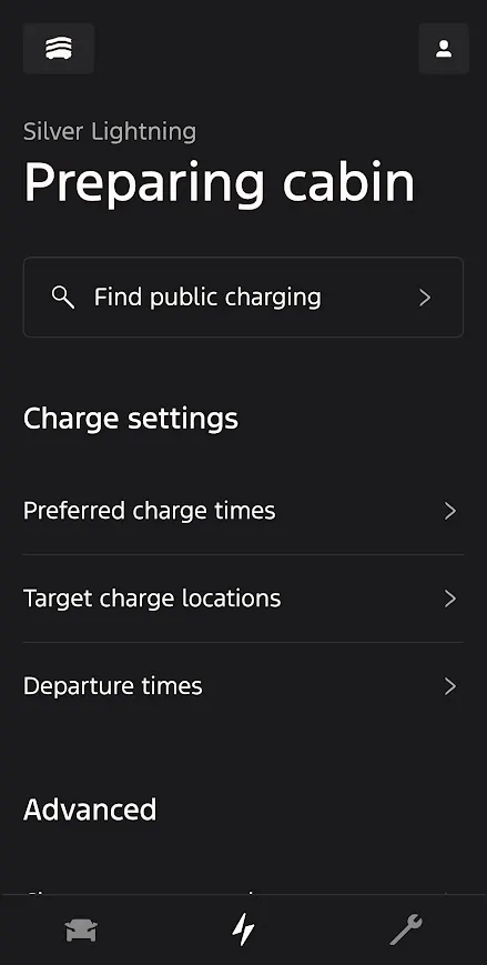

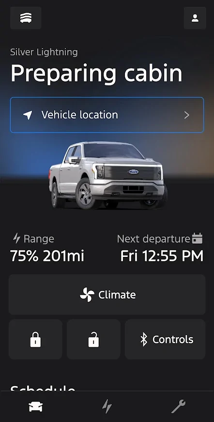

0756 update: the animated fan icon never appeared only the static icon showed from 0750 presently, energy is continuing to flow to the truck in a pattern that's indicating cycling of the PTC so I think the cabin is actually getting heated up.

Chart of energy flow and cumulative energy to the moment, it'll be about 10 kWh to prepare for the drive:
Ford F-150 Lightning 12V battery replacement poll 1763730010608-my
Ford F-150 Lightning 12V battery replacement poll 1763730051538-ut
After heading the the truck, all was normal for displays & sounds, the cabin was toasty warm
Final tally of energy used was 9.9 kWh
