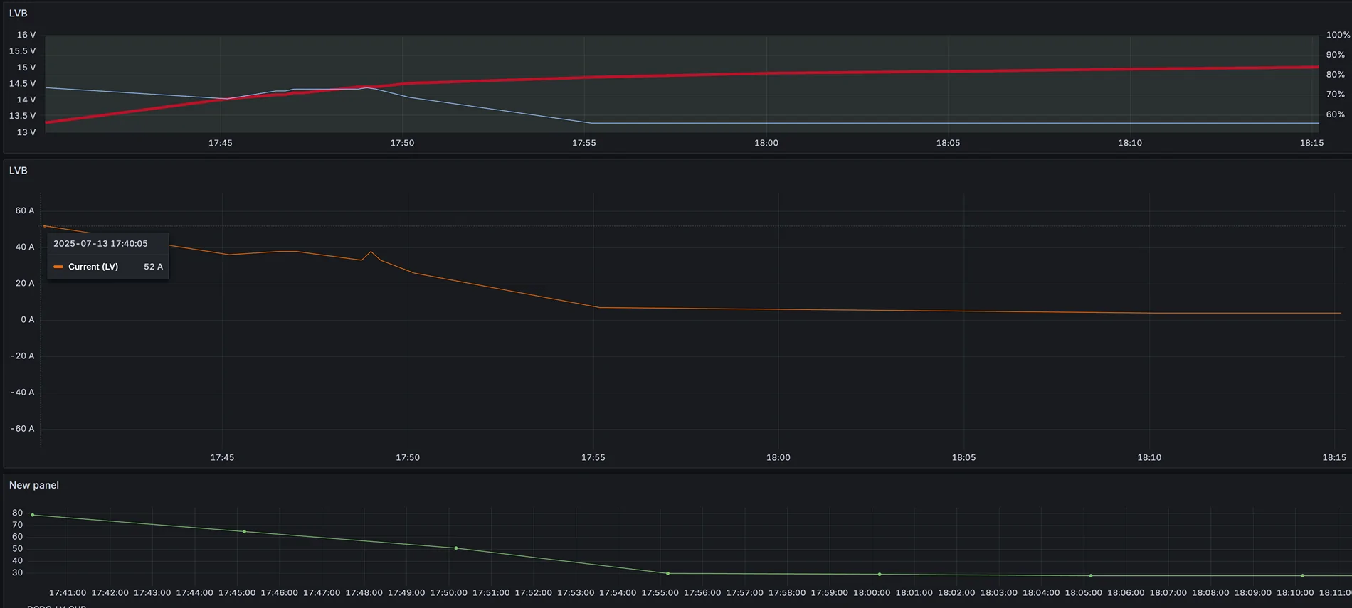

56% of 35Ah = 21Ah and 79% of 35Ah = 27.65Ah so
56% to 79% in 15 min is: 27.65Ah - 21Ah = 6.65Ah in 15minutes, or
6.65Ah / .25h = 26.6A not 52A
Well, I did ballpark an average of 30A, so there's that, we're really not that far apart.
The 52A is a snapshot in time, it's whatever the value is at the time the reading is taken, no one ever claimed it was continous, in fact, I even mentioned that it tapers off pretty quickly.
IF the Ford Lightning battery gets deeply discharged which 40% would be, then I would expect the Lightning BMS to start with a low current when recovering them.

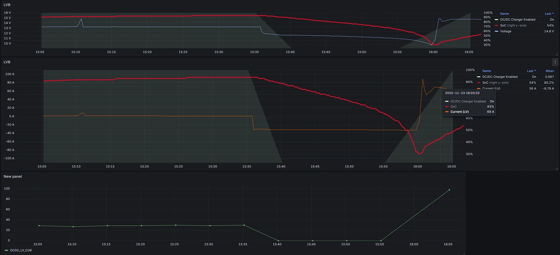

Here's a 0% >> 100% cycle from when I learned the hard way that leaving the truck in neutral somehow doesn't shut the truck off and drains your battery. If we focus on the first hour, and add an average calculation, you can see that the average current during that hour is 16.3A and the SoC at the end of it is 55% and while 16.3A isn't 55% of 35Ah I'd personally say it's close enough to where the numbers seem accurate. And in that instance you have a peak current of 35A.

A deeply discharged AGM should start with a low current at around 10% of its Ah rating. So for this 35Ah battery, about 3.5A.
I don't know what to tell you except that it doesn't. (see charts)
The changes to the BMS software has elimintated some of the low SOC OTA problems, but please don't tell me it will lead to overcurrent charging problems!
As stated before,if my data is correct (which I belive it is) they've actually reduced the charge current, so while it still may be (probably is) a contributing factor to the relative short life span, it's actually been improved.
Not over-thinking it, just using industry standard AGM charging specifications which leads me to question those numbers.
They just don't compute with proper engineering.
With proper engineering there would never be any recalls, now would there ? ;-)
While I don't disagree with you, I also have no reason to belive my numbers (well, they're not really mine, they're from the truck) are incorrect, so that can only lead to the conclusion that Ford isn't following charging specifications / reccomendations.

I think the current that is being measured and reported on the graphs is MORE than just the battery charging current.
If the truck is ON, then there are all kinds of other 12V systems running, battery and converter cooling, the computer, etc. and they are being power through that line you have you ammeter on. Even when the truck is off, some 12v systems are running (computer charge timer for example).
How much of the 12v system's current is being used to charge the battery though?
Well, the BMS is controlling that and it seems that the ammeter is down stream of the BMS in the picture.
The question is how much current is the BMS passing through to the battery though?
One of the functions of the BMS is to control the charging current that gets to the battery. It limits the amount of current getting into the battery from the DC-DC converter so that the battery is not overhcharged.
Some portion of that graph of the current in the 12V system is getting through the BMS to charge the battery, but not 70A, in my opinion.
The specs say the system uses a max of 300W for the 12v battery charger.
----from a search but consistent with what we know----
Functions of the 12V BMS
  • Monitors the battery: The BMS continuously tracks the 12V battery's voltage, current, and temperature to ensure safe operation.
  • Protects the battery: It prevents overcharging and over-discharging, which can damage the battery and shorten its lifespan.
  • Integrates with the high-voltage battery: The BMS can automatically draw power from the high-voltage (HV) battery to recharge the 12V battery when needed. This happens when the 12V battery's state of charge drops below 30% (immediately) or 40% (after a 48-hour delay).
  • Manages charging: The BMS controls the DC-DC converter to charge the 12V battery when the truck is running or plugged in.
  • Performs load shedding: If the 12V battery's charge is critically low and the truck is off, the BMS may reduce or shed power to non-essential accessories to conserve energy for starting the vehicle.
  • Allows for manual reset: After a 12V battery replacement or disconnection, the BMS requires a manual reset to prevent false low-battery warnings

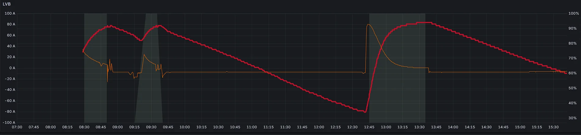

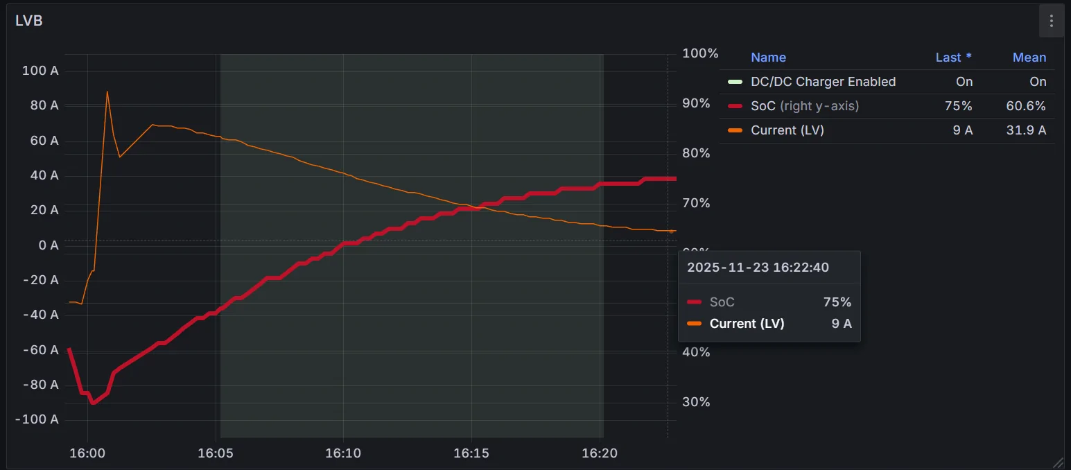

Sorry, just one more, since I decided to repeat my "mistake" from earlier this year in the name of science.
If you leave the truck in neutral it'll only partially shut off after the 30min timer, but somehow it remains in neutral and all the electronics is still alive, effectively draining your 12V battery, and fast.
As you can see on the orange line (battery current) it's being "topped off" with 1A, the rest of the vehicle power (12V) consumtion is supplied by the DC/DC converter ~29-30A.
When the vehicle shuts off, around 3.35pm, you see the orange line drop to -31A because power is now drawn from the battery, and similarly you can see the green line drop to 0A because the DC/DC converter is now OFF.
At 4pm SoC have already reached 30% and I rush outside and start the truck back up and set up my multimeter / clamp meter. And as you can see the clamp meter is registering 72A and the Truck is saying it's 69/70A, you can also see the 12V side of the DC/DC converter jump to 100A, 30 for the truck (as per before) and 70A to the battery.
20min later the current is down to a more sensible 9A and SoC is back up to 75%

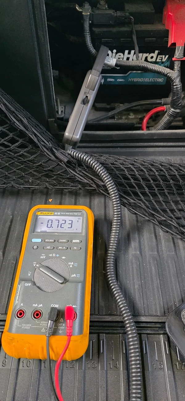

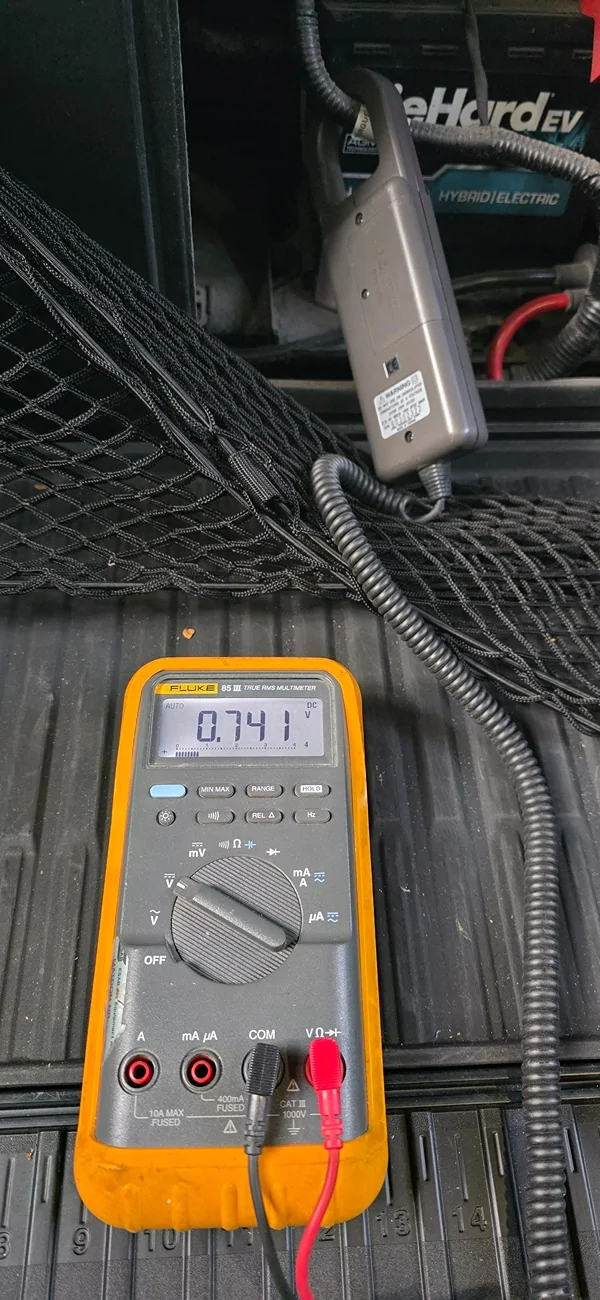

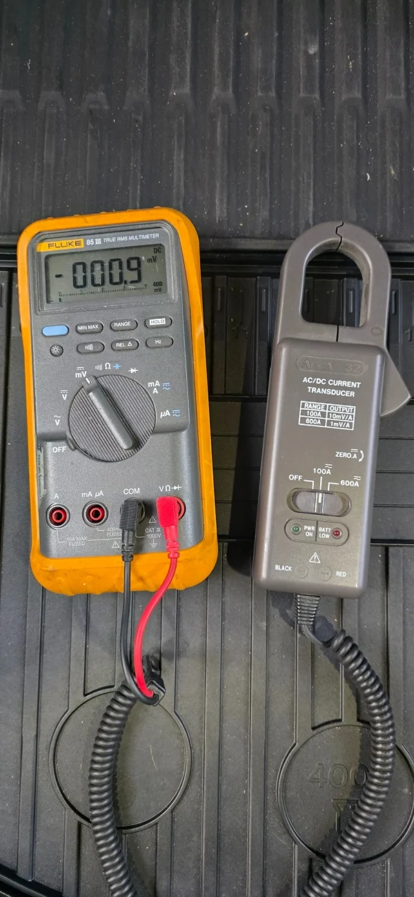

@chl The BMS (sensor) monitors the current through it and reports that along with temperature and battery age to the BCM via the LIN bus. The BCM then provides the PCM with a SOC and the PCM decides a voltage setpoint for the DC-DC converter (e.g., I've seen 13.7V and 14.4V) which affects how fast or slow the battery will charge (accept current). The SOBDMC also gets involved.
There is not a specific charging current. If Brian says a single number, he's wrong. The current varies and dependent on the voltage the DC-DC has been instructed to provide and other 12V loads. It doesn't provide a constant current. But the BMS tells the system the current flowing in and out of it - and by the PCM adjusting voltage then current can be somewhat regulated in and out of the battery. I see you're also an EE - think KVL, KCL, Ohm's law.

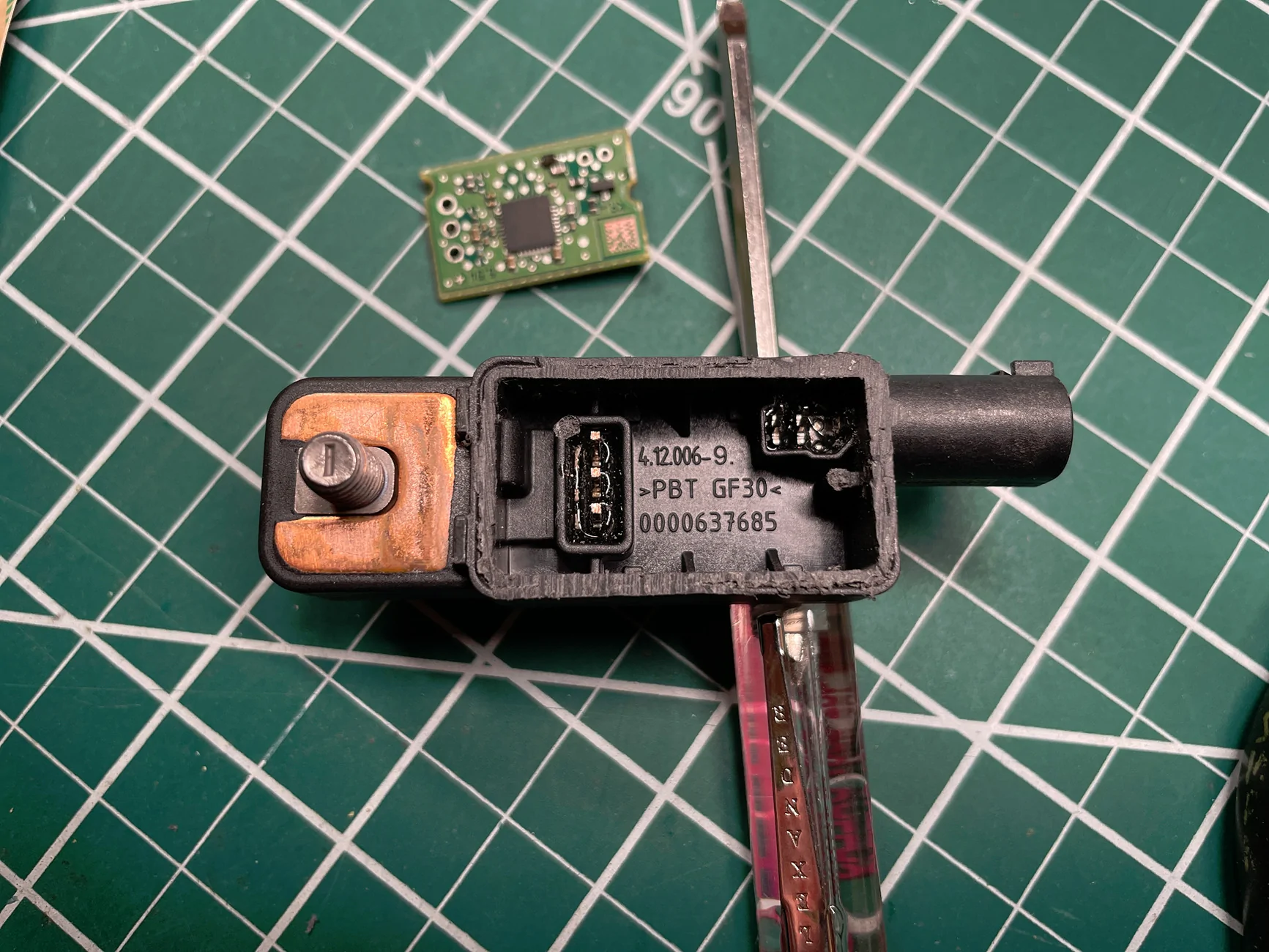

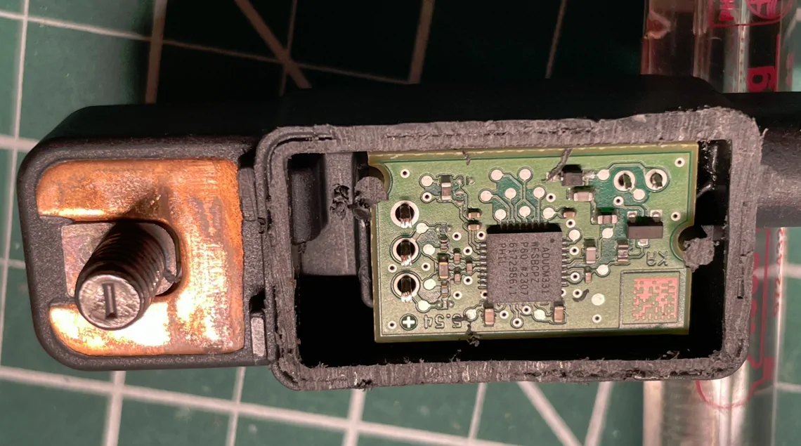

I have taken a BMS apart - it has a microprocessor so its doing some calculations. There is definitely no switch, valve, contactor, etc. It has a current sensor (Hall Effect?) built into the plastic between the input and output lugs.
You might want to spend $29 on a 3-day subscription to PTS. The Service manual has wiring diagrams, system operation description, etc. Much better source than any AI.
Ford F-150 Lightning 12V battery replacement poll 1763939726073-0j
PICS: LIN bus and battery positive enter from two pins on upper right. My best guess is current sensor and battery negative are present on the three large pins on the left.

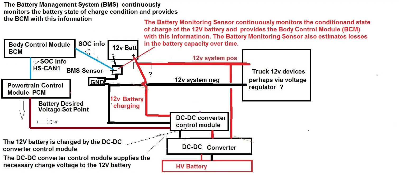

Yea, I dug in to the whole thing a little deeper and see I had assumed a couple things that did not pan out.
The BMS sensor is just a sensor/calculator giving the rest of the battery control system the information needed to control 12v battery charging, so it does not act as a valve/switch,
There are several components involved, and the thingy that charges the 12v battery is the DC-DC Converter Control Module (CCM).
I haven't found a lot of detail about the wiring, but I threw together a block diagram of what I could discern from the Ford docs. I stuck the text into the image (with some corrections for spelling - like battery was spelled 'batter' sometimes):
Ford F-150 Lightning 12V battery replacement poll DC-DC-Battery-12v system block diagram
If the charging voltage is 14.4v and if the measured charging current is really high, that's a sign of a badly depleted battery (the lower the SOC the higher the charging current).
And it is also a sign that Ford did not put any (enough) current limiting circuitry in the charging system, which is...bad. High currents will ruin an AGM over time permanently. Maybe it's an issue with the BMS sensor.

I'd like to see a wiring diagram some day - I'm curious about how the DC-DC CCM is wired to charge the battery per the description I read. Is there a separate charge path or does the whole DC-DC converter output voltage rise to charge the battery?
This was the description I used for the block diagram taken from a document that was linked above somewhere:
12V Battery Charging System
The 12V battery is charged by the DC-DC converter control module. The Battery Management System (BMS) continuously monitors the battery state of charge condition and provides the BCM with this information. The BCM communicates this information to the PCM over the HS-CAN1. The PCM communicates the battery desire setpoint to the DC-DC converter control module which supplies the necessary charge voltage to the 12V battery....
Battery Monitoring Sensor
The Battery Monitoring Sensor continuously monitors the conditionand state of charge of the 12V battery and provides the Body Control Module (BCM) with this informatinon. The Battery Monitoring Sensor also estimates losses in the battery capacity over time.
The Battery Monitoring Sensor is clamped directly to the negative terminal of the battery and grounds to the vehicle at the chassis ground connection point through the negative battery cable and eyelet. It is part of the negative battery cable and cannot be serviced separately....the battery need to be isolated, this should be done by disconnecting the ground eyelet at the chassis ground.
The Body Control Module (BCM) monitors the Battery Monitoring Sensor and provides the Powertrain Control Module (PCM) with battery state of charge information.
The PCM provides desired voltage set point to the DC-DC converter control module.
Direct Current-Direct Current (DC-DC) Converter Control Module (CCM)
The DC-DC converter control module is responsible for maintaining and charging the 12V battery. It is enabled when the high voltage battery contactors have closed, providing high-voltage power to the DC-DC converter control.
