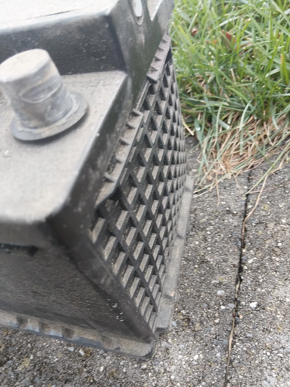

When I replaced my OEM 12V battery today, at 79,561 miles and 17 months of ownership, I noticed the two sides with the grid pattern on them (left and right side when looking at this battery in its truck location behind the frunk) were both noticeably bulged out. That didn't seem right, and the service tech where I took it at my Ford dealership, agreed. See the 2 pix.
FYI my late 2023 truck has sat at this dealership for 7 or 8+ months until I bought it in July 2024. Not sure if this matters but wanted to mention it.
We're heading up to Canada for several weeks next week so I decided to pop for the Ohmmu 12V battery. The OEM battery had not given any functional signs of failure.
Anyone else here who found their OEM 12V battery with bulging sides?
