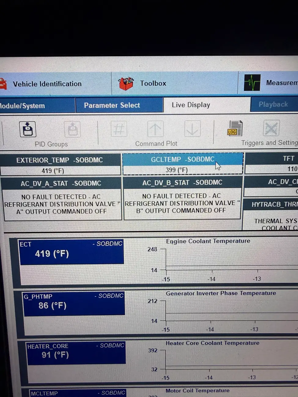

In June, my 2023 Lightning ER Platinum started overheating during charging and wouldn't cool down while driving. Range dropped from 312 miles to about 50. When a Ford dealership finally hooked up their own diagnostic equipment, it recorded the battery cooling circuit at 399°F and 419°F — while the AC refrigerant valves were reading "no fault detected" and "output commanded off." No warning light. No DTC. No shutdown. Ford's own Vehicle Health app told me twice, during the actual event, that the truck had no issues.

Very interesting... Did your battery temp gauge go up to hot or was it reading normal? Just trying to figure out if the temp sensor is faulty or if something in software or some other valve that is supposed to open is faulty.

So the battery temp display on the dash, would go full yellow and would NOT cool down while driving. Whenever I would charge, I would watch the charging speeds and stopped when they dropped. They were dropping long before hitting 80% so I have to assume it was purely temperature related. I stopped at one Tesla charger and all the tesla cooling fans were screaming like banshees, and my cooling fans never kicked in. If you look at the webpage, Ford keeps throwing things at the wall to see if they can figure it out. I have been trying to get this escalated above the customer relations group, but that doesn't seem to be happening. I sent a full set of documents with all the evidence to four FORD executive offices and no one responded.

Good grief. How can those temps be correct? At what temp does the whole thing catch fire?

Did it ever smell hot? My heat pump hot water heater has the sensors go out regularly and it reports crazy high temps like that. At 400F I‘m pretty sure stuff would smell hot, there is a unique smell to melting wire insulation or even high temperature insulation that is approaching the limit. This is over 200C, the upper end of ‘normal’ wires can handle up to 90C.
If it were truly getting that hot I’d think that they would not want to have the vehicle in the shop. I’d then suspect a short and you don’t want an improvised heater element on top of a lithium NMC battery.

I notice that the heater core temp is only 91 degrees which I think would be hard to do if the engine coolant was 400, unless they are completely separate systems on the Ford.

First, I agree you need either a buyback, or a NEW battery pack and coolant system.
With that said, I have a hard believing that was actual temp. IMHO that hvb would be completely inoperable if not exploded. Thermo runaway would seem certain IMHO at that temp.

I am fairly certain that is above the runaway temperature for NMC batteries. It is definitely well above the boiling temp of coolant. So it would seem the battery never actually got that hot. Something else is going on. Unless it was your truck on that recent ’StacheD’ video.

It appears if that was actual temp, then thermal runaway would have occurred. A Google search yielded the below but with a actual citation that I did not watch. So being AI, take it for what it's worth, but I would certainly be getting legal involved ASAP. if temps were real, then FORD needs to have your truck for analysis, and if not real, FORD needs your truck for analysis.
NMC (Nickel Manganese Cobalt) lithium-ion batteries typically reach their thermal runaway critical point between 150°C and 210°C (302°F–410°F). Higher-nickel content variants (such as NMC811) trend toward the lower end of that range (~150°C–180°C), while lower-nickel variants (like NMC111 or NMC532) remain stable up to roughly 200°C–210°C before entering rapid escalation. [1, 2, 3, 4, 5]

Is it possible that the battery never actually reached these temps and the problem could be a faulty temp sensor?
