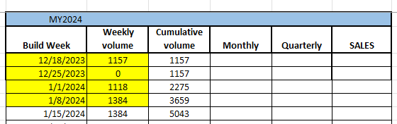

Thanks for the update, I started using Autotrader.com to glean through dealer stock orders, so far I've captured the following, still looking for build week 1/15 which was selected on the 4th or 5th of January.
Ford F-150 Lightning 2024 Lightning availability 1704988336158
