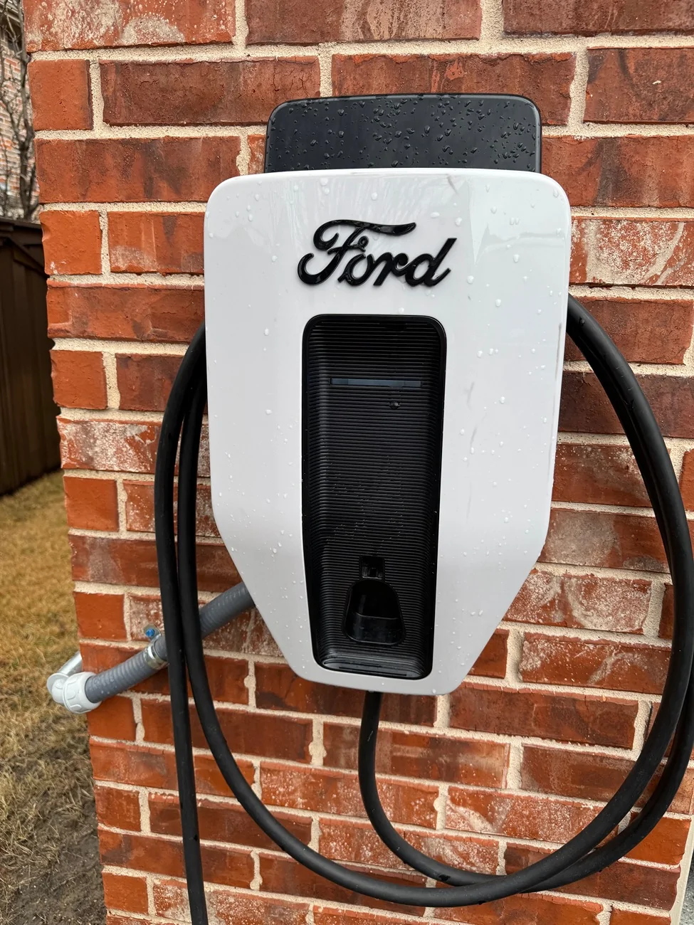

Why not mount it to the brick?

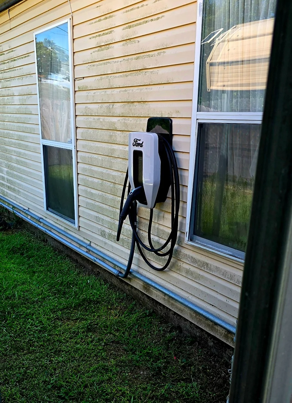

Man, some of these installations look awful on the house. Conduit on a brick house, around a corner like that? Conduit the entire side of a house? Wow.
That's what happens when your 100+ year old house with the original 20 amp service of screw in fuses gets upgraded. There's no way to run new wire through brick and plaster walls.
Drill?
Bury?

Only perpendicular to the wall, outside to inside or inside to outside. The conduit is generally more acceptable looking on the outside of the house.
Money and added complexity. Generally not run alongside the house to protect it from being damaged by digging or other work. Digging a ditch along your foundation is generally frowned upon. Underground is used to run power across space away from the house or power source. It has to be deep enough that regular yardwork (planting stuff) won't damage it.
