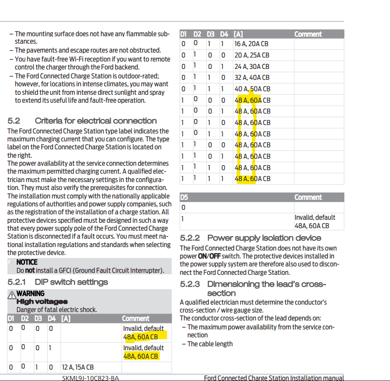

I got my new charger ready to be installed and the lightning pro with regular battery may arrive next week.
If I set up the charger to 50 amps can the battery handle 12kw? Or should I keep it at 48 amps?

The battery can handle a lot more than that.
3,819
6,973
A pro can only charge at 48 amps, unless it has the extended range battery. The additional cost to enable your EVSE to output 50 amps is cost prohibitive, even if it could utilize it.

I have a pro and charge at 48 amps. My charger pulls about 11KW. I’m not sure what tangible or noticeable difference you’d see between 48 and 50 amps?
As Blochead mentioned above- you need at least 6 gage wire for either 48 or 50 amp circuit.
3,819
6,973
That's not true. You need at least a 70 amp breaker and #4 wire for 50 amp charging. That is why it's cost prohibitive. The price difference between #6 and #4 wire, while only gaining, at most, .48kW, is generally not worth the extra cost.
It’s about whether the house circuit can handle the load without dumping the main or starting a fire.
Fully agree, about 20-30 minutes less on a full charge from 0 to 100% is very negligible.
nonsense.
a 50 amp service (80% rule) would require 62.5 Amp wire size, which (at minimum) 6 gage wire fulfills. The length of the run of course could require a larger wire.
of course, why anyone would go through the trouble to run anything larger than the largest charger the truck could handle (48 amp) remains a mystery, the mere fact that you called me out is the reason for this response.

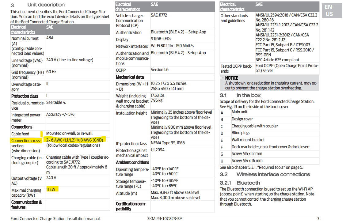

Hello
What charger did you buy that has option of 48 or 50 amp output?
