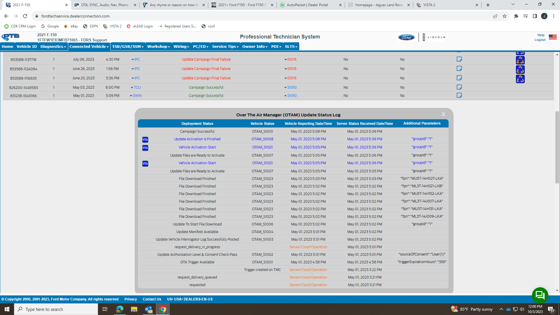

In this particular case, it could have been the TCU connecting from one tower to another during the server request delivery process since I was driving. Below is a screenshot from two days earlier when I was sent 4.2.3 while also at work. Everything is almost the same, except this time, it was able to pull the manifest and download the files the first time it requested.
Yes, wholly agree with vehicles in transit, that's going to be hit & miss.
For vehicles with long term [weeks & months] out of cycle on the update schedule, that's where improving the methodology of scanning for status and server capacity enhancement can help, once the vehicle is at rest near a good cell signal or registered wifi site.
