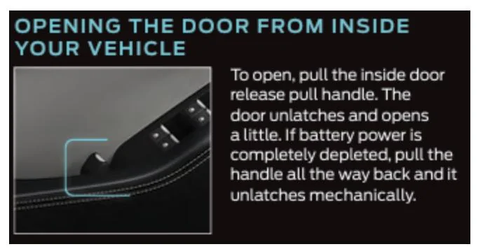

OK, the blade key makes sense if you were stuck on the outside. But if you were a toddler on the inside. Or an older kid. If they just pull on the hand will the door open? If the battery was dead
Mechanical. No battery needed.

As others have noted, they are manual. If you were to take the door panel off you will find the cables and connecting mechanisms to the handle on the inside and the pop up lock. No motors involved.
The front doors if they are locked, pull on the handle and they unlock and open. The back doors you must pull the handle twice and they will unlock and open, UNLESS you have the child lock turned on.

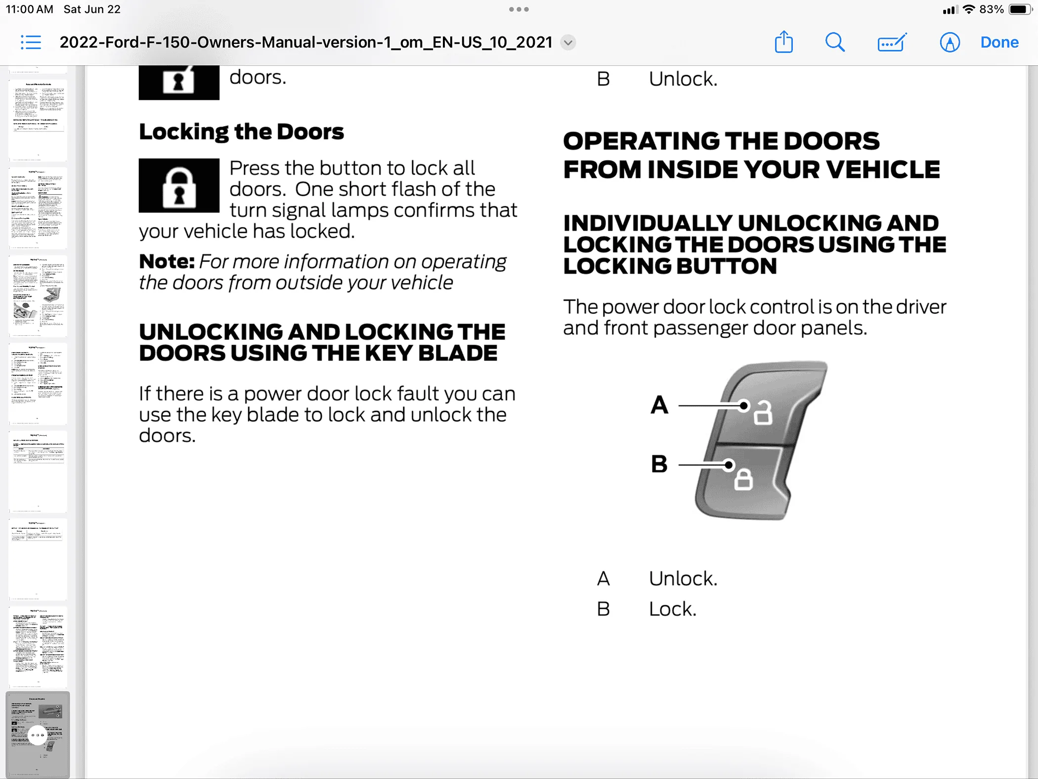

I checked this out after I read the toddler story. The front door locks inside my 23 Lariat are too short and you cannot grab them (except with a pair of pliers) to unlock a door. However I did notice that for some reason the rear lock "stems" are longer and can easily grabbed to unlock the doors from inside. Why who knows but it's good to know that if in an emergency the rear locks can be opened from the inside without any power assist
