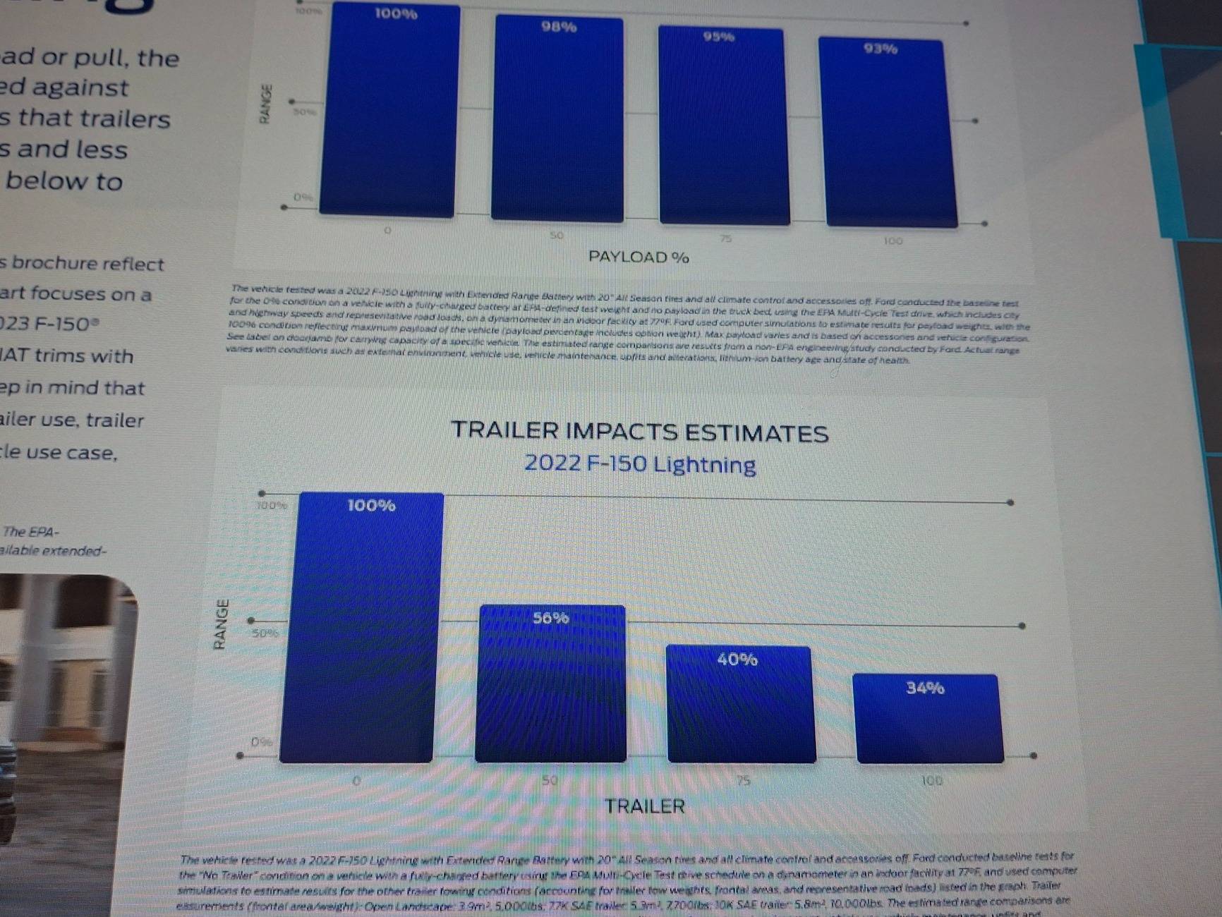

Here is a Ford factory chart that was on display at the dealer. Shows the percentage of mileage loss when comparing in truck payload weight and towing.
As you can see, a fully loaded truck bed still gets 93% of the rated range. While a fulled loaded trailer 10,000# only got 34% of it's range.
