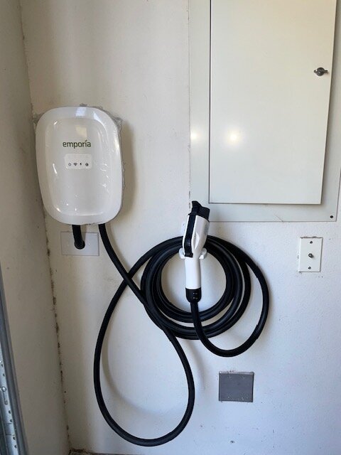

Same.
Love my Emporia 48A -25' cable makes it easy to charge outside.
I got a Emporia for a second charger outside and FCSP inside. Got the UL one but the non-UL is identical. Here is a 5% off coupon off the sale prices for the group. DIYSOLAR
The integration with their Emporia Home Energy monitors is nice.
