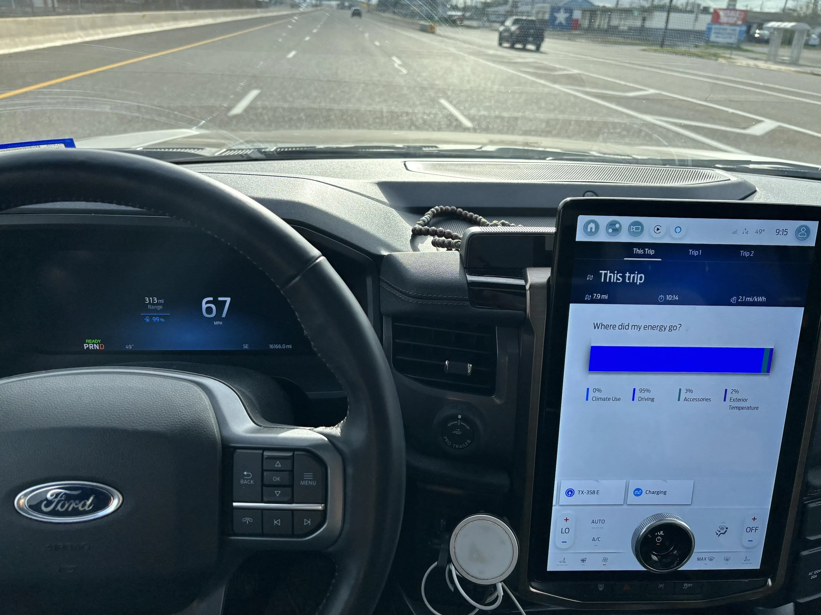

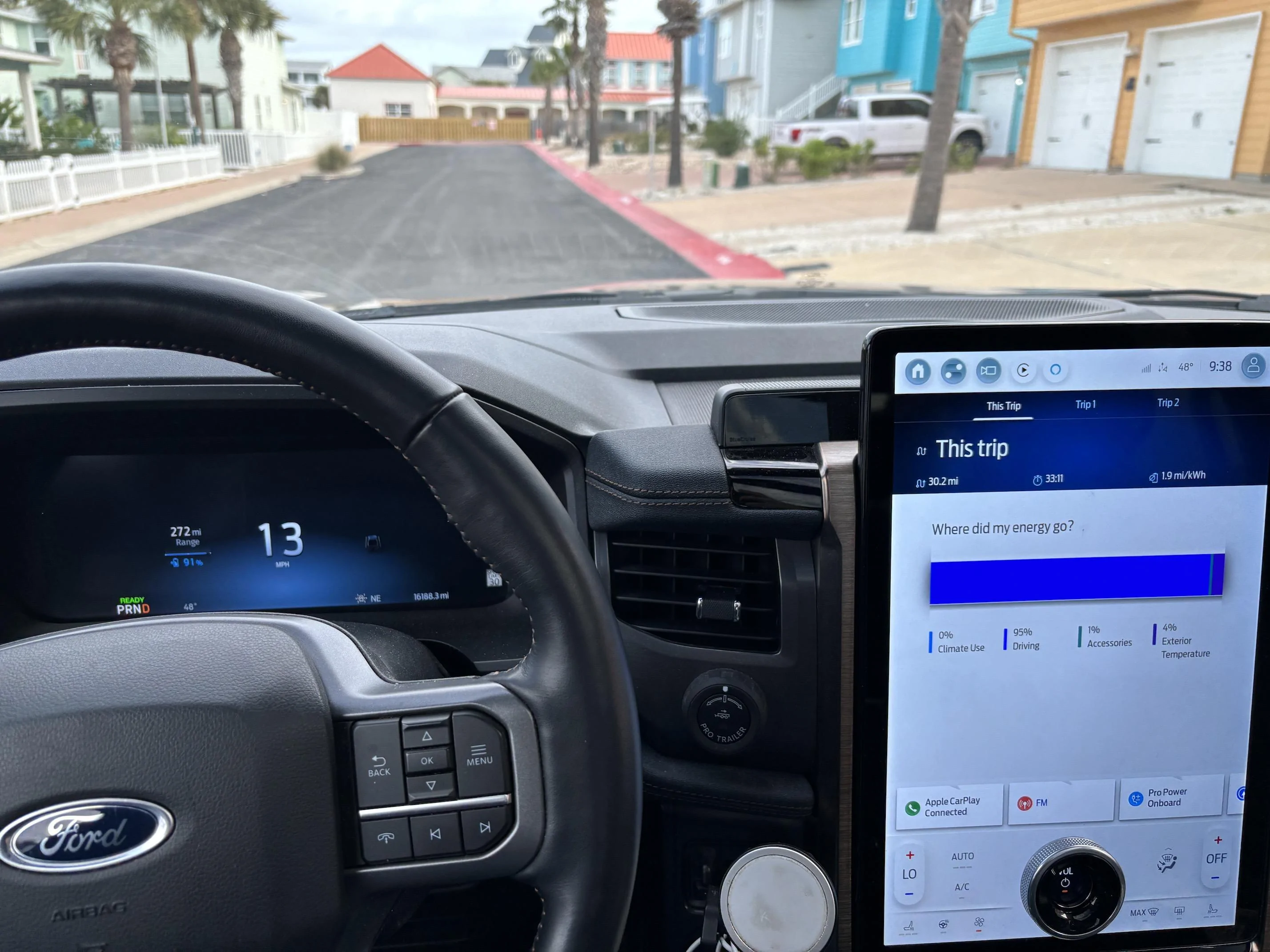

Lately I have noticed that if I charge to 100%, it takes several miles of driving to drop to 99%. (Lariat ER with 16,000 miles and maybe 20 DCFC charges) So this morning I decided to record my drive to see what's up.
(As many of you know, the actual capacity of the batteries is 148 kWh. It has been suggested that Ford would increase the available capacity as the truck ages so that customers do not notice a decline in range, and so that the warranty would not be triggered by decreased capacity or range.)
First data point: I drove almost 8 miles at 2.1 mi/kWh before the "percent charged" dropped below 100%. Assuming that 100% is 131 kWh (which I will address later), I burned about 3.5 kWh to get the battery down to 99%. So did I start at 134.5 kWh?
Second data point: My full trip was 30.2 miles at 1.9 mi/kWh, or 15.9 kWh. This would be 12.1% of the battery. Instead of 100 - 12 = 88%, my dashboard showed 91%. Again, approximately 3% difference which is 3.9 kWh.
Is Ford now allowing me to charge to 135 (or so) kWh? If so, why did they leave 131 as the 100% charged number?
An alternative explanation is that my truck now thinks 126 kWh (or so) is actually 100%. I think this is less likely.
Anyone else notice this? Thoughts?

Edit: I know there is a lot of error built into my calculations. For instance, whether the 100% dropping to 99% occurs after a full percent is used, or only after 0.5 or 0.6 or 0.7% is used. Rounding errors add up. When I added in the data from my return trip, which is a larger sample, there was still 3% of energy unaccounted for.

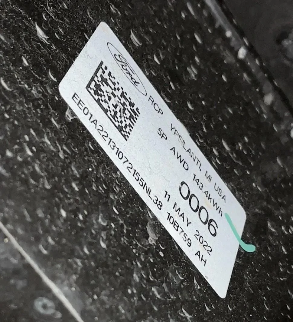

I thought the Battery was 141
You may be right. I pulled that number off someone else's post. There is a post that shows a photo of the sticker on the battery. Could not find that one.
