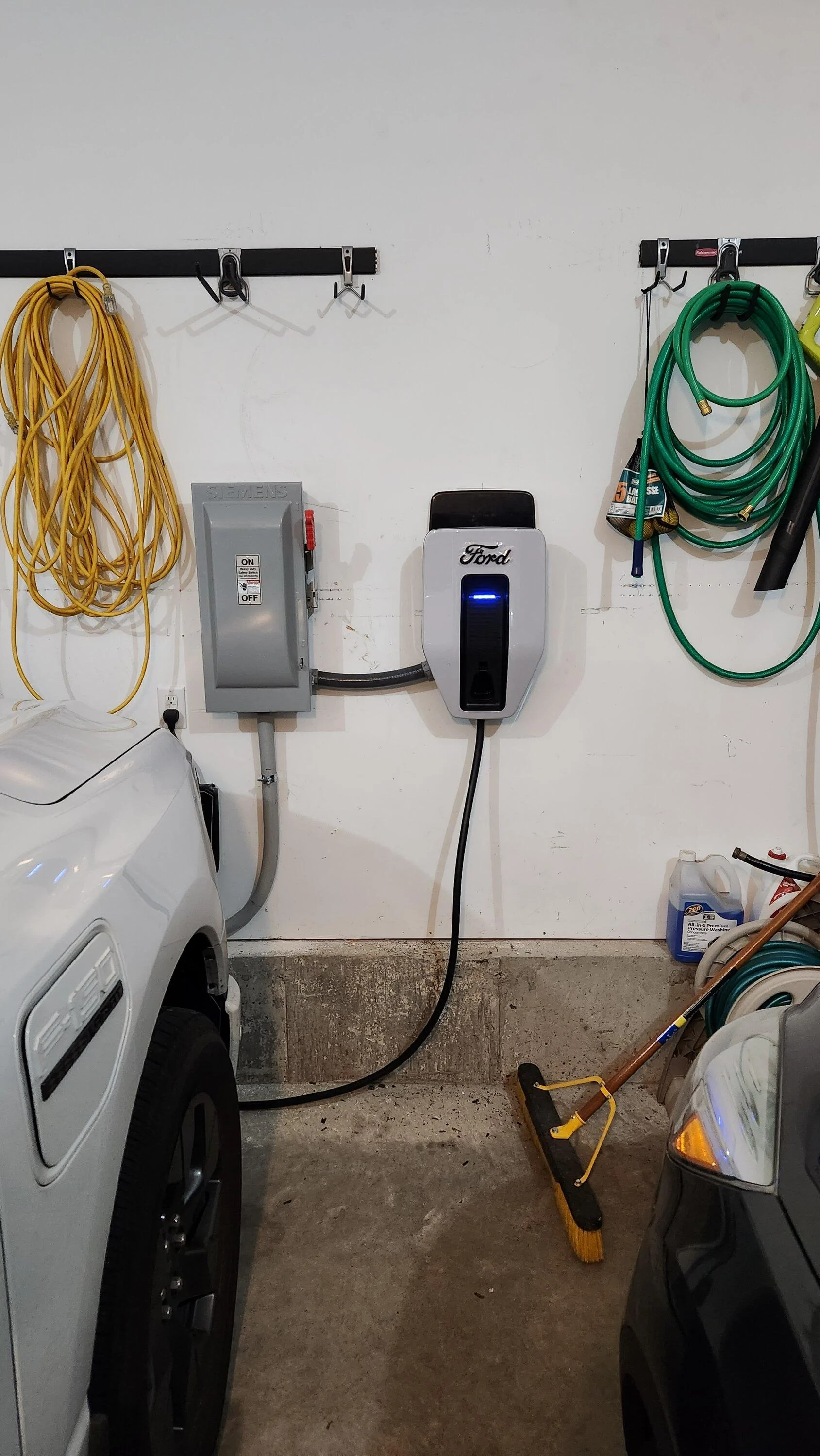

Not a problem for me I have a shutoff right next to the charger and a load shed Incase I lose power and my generator kicks on. I didn't need the truck to power my house because I have a whole home generator but it can't power my house and charge the truck at 80 amps so I needed to load shed the truck if I lose power.
