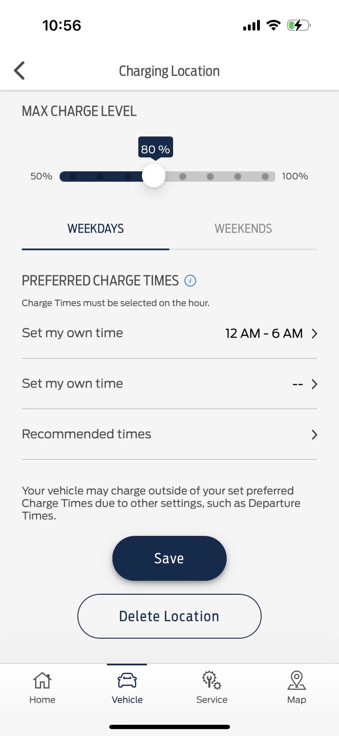

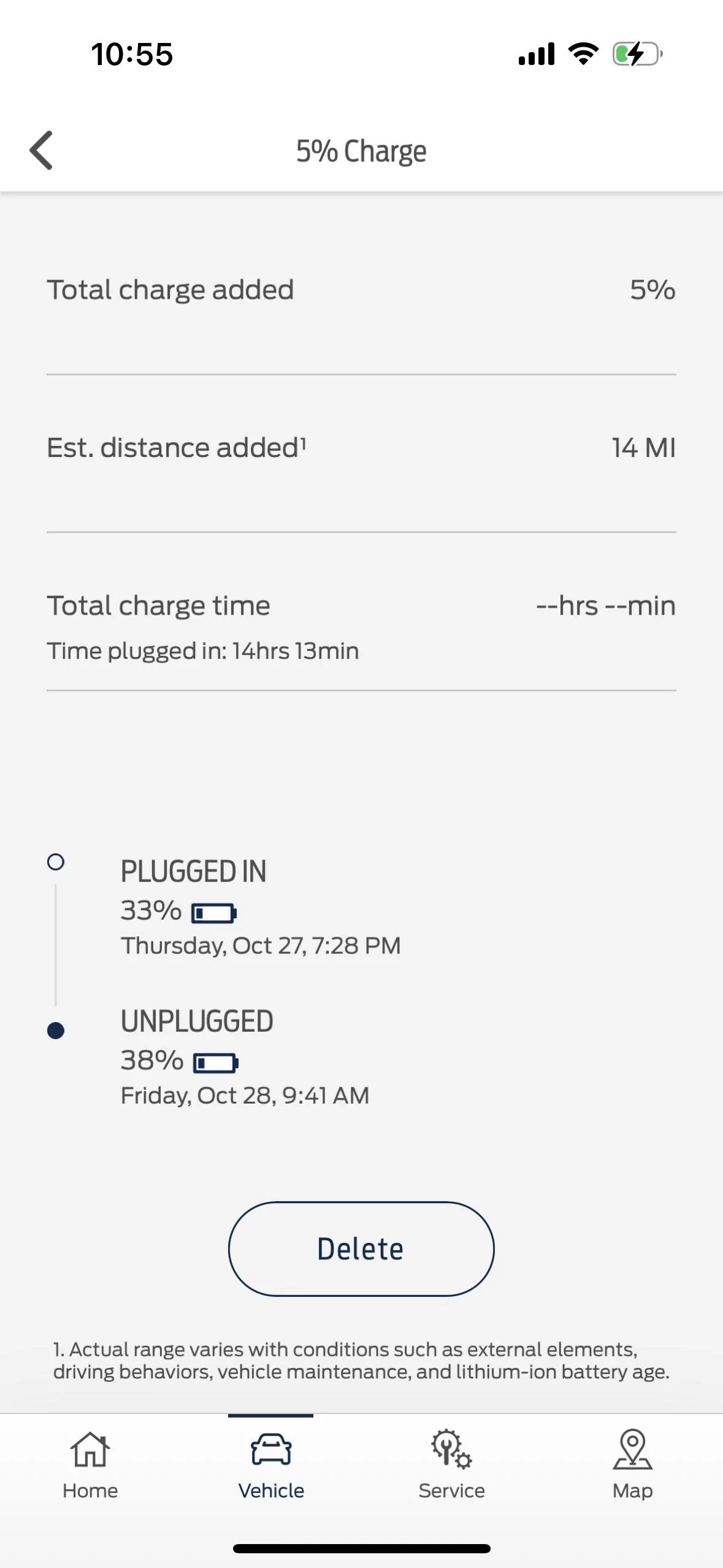

Anyone have their preferred charging window skipped randomly? Mine charging has been working as expected for a few weeks - plug in when I get home from work in the evening, preferred settings at Home set to 80%, 12am-6am, truck reads the battery level and the app usually says charging will start at 12am. Last night (Thurs) the app said charging would finish at 6am Friday. Normal behavior.
This morning (Friday) I went to precondition and noticed my battery was still at 33%. App now said charging will finish at 6am (Saturday). Like it completely missed my preferred window during the previous night. I had to select "start charging now" to get enough for my commute to/from work today. Was late but no big deal. Thankfully it was an uneventful Friday but if I had missed an important appointment I'd be much more frustrated. Not sure what happened and I'm hoping to prevent this issue. I didn't change anything else regarding preferred charging settings or location since it had been working reliably.
Has your truck received the 3.5.3 or 3.5.4 updates recently?

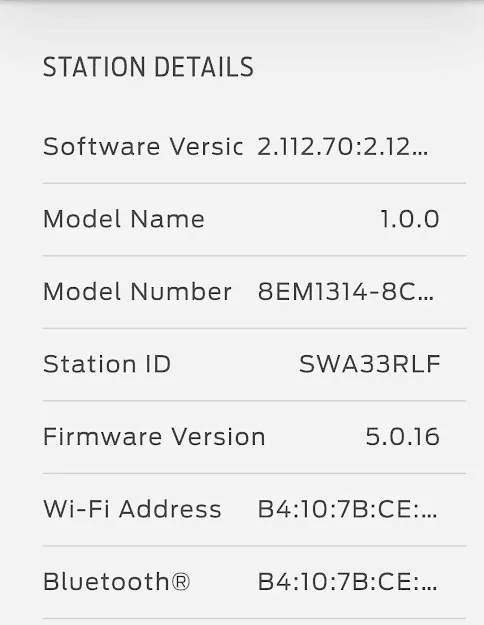

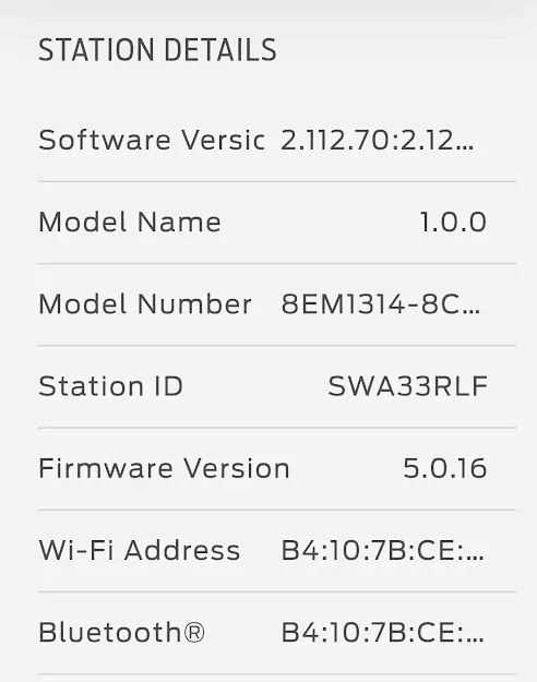

My Trucks last power-up was 3.5.4
My FCSP is at this software level 2.112.70:2.129:1.12:0.42:0.33
and Firmware 5.0.16

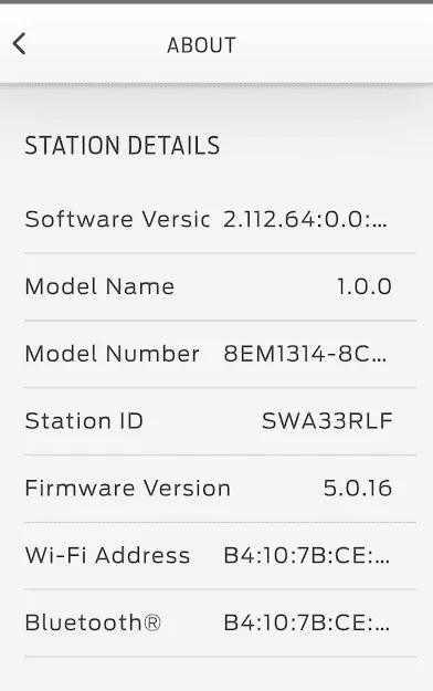

IIRC, it is the software version that might be out of spec.
This is what I had on day one [9/30/22] power on the FCSP 2.112.64:0.0........
The next morning it showed this 10/1/22
I have the old software. How do I update the software version?
It should download and install spontaneously, if you have a good WIFI signal reaching the FCSP.
It happened overnight for my unit, but others have waited longer, they mention shutting the unit down, wait about 10 minutes then powering it up, possibly that will trigger the unit to phone-home to get the update.
